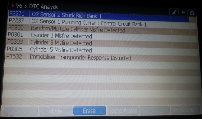

Its blowing white smoke out of exhaust,dripping liquid from exhaust which smells like unburnt fuel, running really really rough, engine shaking heaps. i put a diagnostic computer on and it showed me the following faults;
P2271= O2 Sensor 2 Stuck Rich Bank 1
P2237= O2 Sensor 1 Pumping Current Control Circuit Bank 1
P0300= Random/Multiple Cylinder Misfire Detected
P0301= Cylinder 1 Misfire Detected
P0303= Cylinder 3 Misfire Detected
P0305= Cylinder 5 Misfire Detected
P1632= Immobiliser Transponder Response Distorted
A mechanic told me to check all my sensors and Earth connections for any broken wires or plugs.

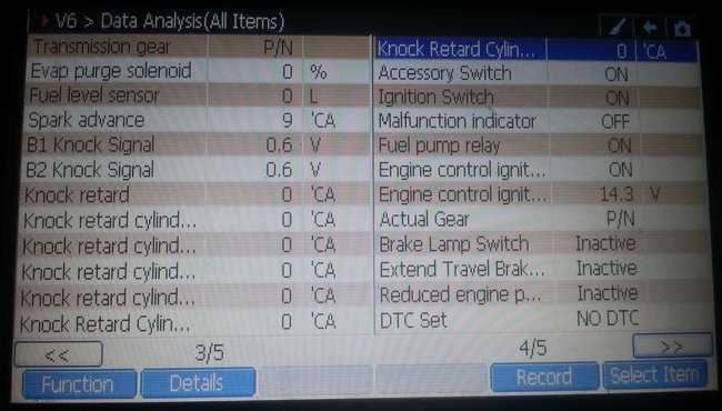

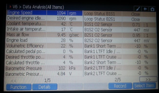

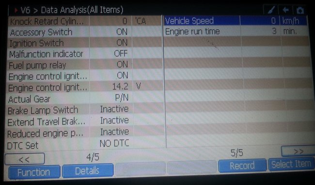

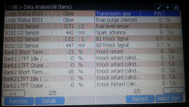

I also got the following information from a diagnostics tool as well;
ENGINE SPEED - 1094 rpm
DESIRED ENGINE IDLE SPEED - 1090 rpm
COOLANT TEMPERATURE - 42 C
INTAKE AIR TEMPERATURE - 17 C
MASS AIR FLOW - 9.45 g/sec
ENGINE LOAD - 28%
VOLUMETRIC EFFICIENCY - 22%
DESIRED THROTTLE POSITION - 4%
CALCULATED THROTTLE POSITION - 4%
BAROMETRIC PRESSURE - 102 kpa
BAROMETRIC PRESSURE VOLTAGE- 4.84 V
B1S1 O2 SENSOR - 0.71 :1
B1S2 O2 SENSOR - 447 mV
B1S1 O2 SENSOR - 0.95 :1
B2S2 O2 SENSOR - 447 mV
BANK 1 SHORT TERM, -10%
BANK 2 SHORT TERM, -10%
SPARK ADVANCE - 9 'CA
B1 KNOCK SIGNAL - 0.7 V
B2 KNOCK SIGNAL - 0.7 V
ACCESSORY SWITCH - ON
IGNITION SWITCH - ON
MALFUNCTION INDICATOR - OFF
FUEL PUMP RELAY - ON
ENGINE CONTROL IGNIT? - ON
ENGINE CONTROL IGNIT? - 14.3 V
ACTUAL GEAR - P/N
VEHICLE SPEED - 0 km/h
ENGINE RUN TIME -3 min
SOFTWARE VERSION NUMBER - 92190064
ENGINE CALIBRATION - 92190369
SYSTEM CALIBRATION - 92190065

I would check for a blown head gasket.
Here is a guide that will help you, please get back to us with the result.
We are here to help
Best, Ken
Aug 16, 2016 at 8:45 AM
CARADIODOC
  • 34,381 POSTS
Yup. White smoke is the result of burning engine coolant, and is almost always caused by a leaking cylinder head gasket. That's the first thing your mechanic should have mentioned. No malfunctioning sensor is going to cause white smoke from the exhaust.
