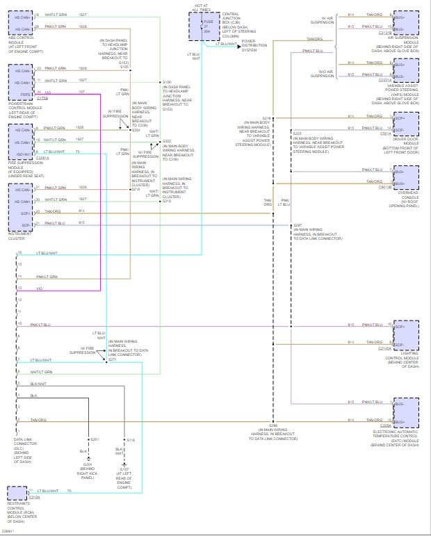

Police P71, wires cut on OBD2 port. I need diagram to see where they go.

Here is that wiring diagram of the DLC.

Thanks. Hard to see on my phone. I will see if the desktop shows up better. Thanks again!

Can you zoom in?

Yes, just gets fuzzy.

It should show up better on your desktop.
