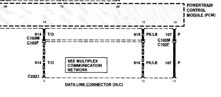

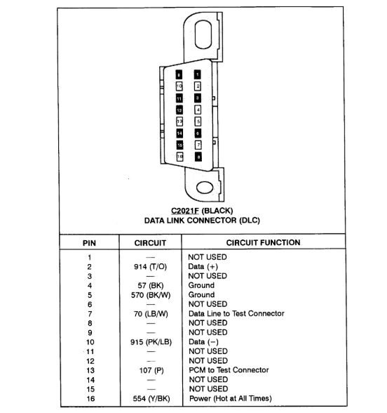

Need wire diagram for Police interceptor OBD port. The wires have been cut.

I attache a diagram for the connector with wire colors and functions.

Thanks, but the pink/light blue split into 3 and the tan/orange also split into 3.

That is the connector diagram you requested.
What specifically do you need?

The entire obd port and harness is gone. Do you have the entire diagram? That would be a huge help.

I attached 2 diagrams. The pin numbers are marked and wire colors.
Pin 16 is a power from the fuse box.
