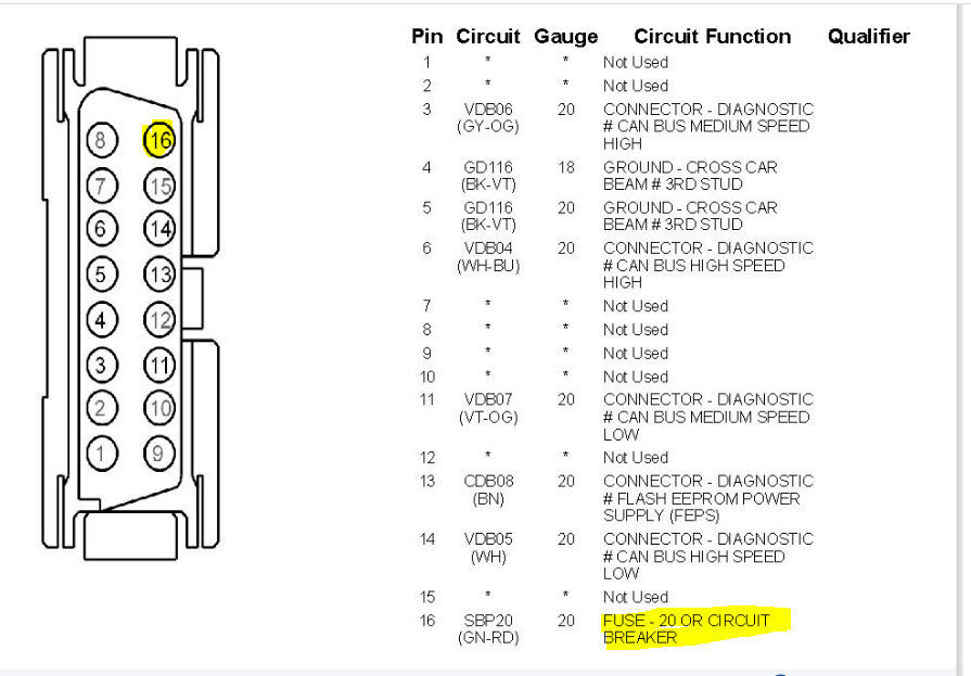

Where is the OBD Port located?
2010 FORD FUSION
136,000 MILES • 2.4L • 4 CYL • 2WD • AUTOMATIC
JGSTRICK1
I'm receiving an error when plugging my scan tool. It won't connect. Trying to locate the power port.
Mar 18, 2023 at 8:56 AM
  • 110,240 POSTS
Check pin 16 in the data link connector for power. It should have 12v at all times. See pic 1 below.

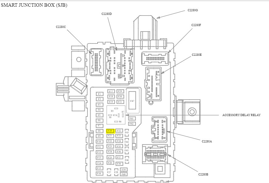

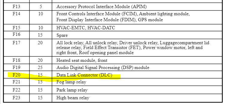

If there is no power, locate fuse 20 in the smart junction box inside the vehicle. Check that fuse. Also, confirm there is power to and from it.
I attached pics below to help locate the items I mentioned.
Let me know what you find.
