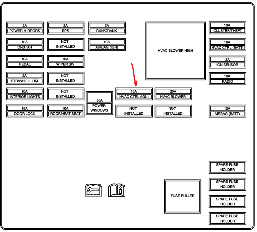

I'm having an issue getting an inspection done on my vehicle. The state machine isn't picking up any information from the OBD. I have an appointment tomorrow to drop my car off so my mechanic can look at it, but someone said I should first check the fuse. I've tried looking on the internet to see where exactly the fuse is, but I can't seem to find the information for the car listed above. Can anyone help?

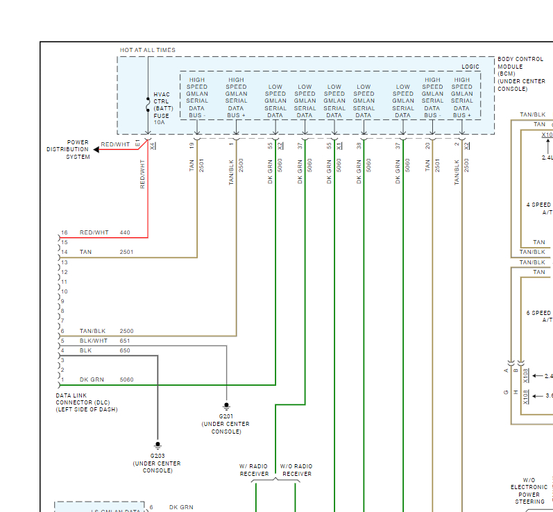

Here is the location for the ALDL data port connector which is the HVAC CTRL fuse 10 amp on the BCM fuse panel. If the fuse is okay, I would check the grounds as well, this guide can help, and I have included the connector wiring diagrams so you can see which wires to test.
Check out the images (below). Let us know how it goes.

The data port should have 12 volts at the red and white wire, and ground on the blk and blk/white wires. Can you confirm? Please follow the guide above.

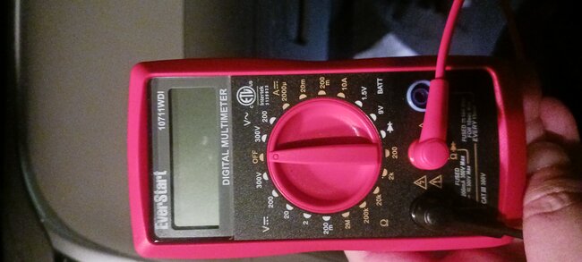

I went out and got a multimeter but can't figure out how to use it (the setting it should be on). Can you please tell me which setting to turn it to for each prong and what the meter number is supposed to be at?
Update: After watching a video, I think I did it correctly. I set it to 20 in the upper left of the meter and checked 16. It came up at 12.70. I changed it to 200 directly on the bottom of the meter. 4 was at 2.1 and 5 was 1.7. I think those are supposed to be at 0, right?

Sure, here is a guide you can go over to help understand the voltmeter, but I would use a test light which is easier, please go over both of these guides:
and
Please go over these guides and get back to us.

Yep, it was 104 in my computer office, so I was in a hurry. To check ground just use the continuity setting and listen for the beep. Use one lead to ground and the others on the blk and blk/wht and you should hear the beep. This means the grounds are working. Does the car start and run?
