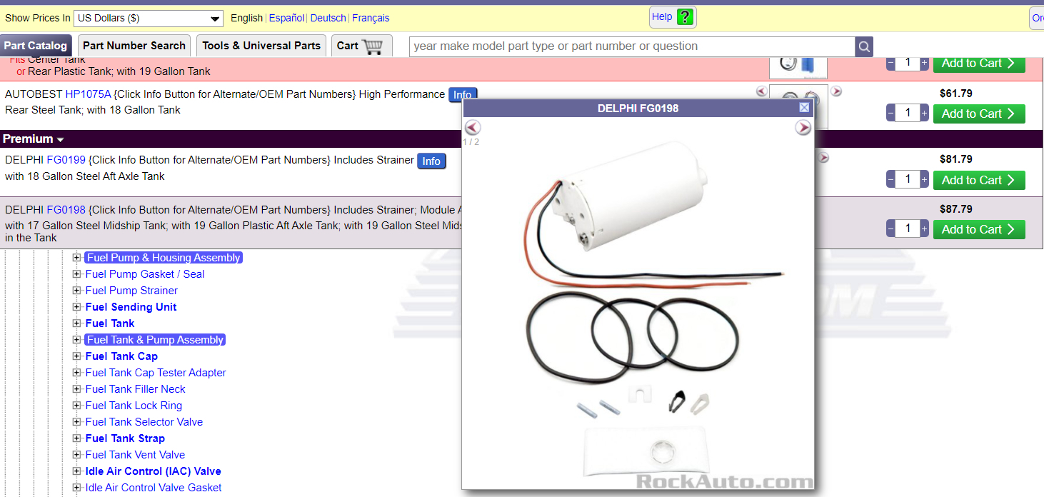

Would you recommend replacing the entire Sending unit/fuel pump assy.? Or just the pump? No issues with fuel gauge. Is it difficult to replace just the pump?
Mar 16, 2021 at 10:40 PM
I would replace the fuel pump alone. I do not see the entire units available.
I attached my choice from rock auto below.
