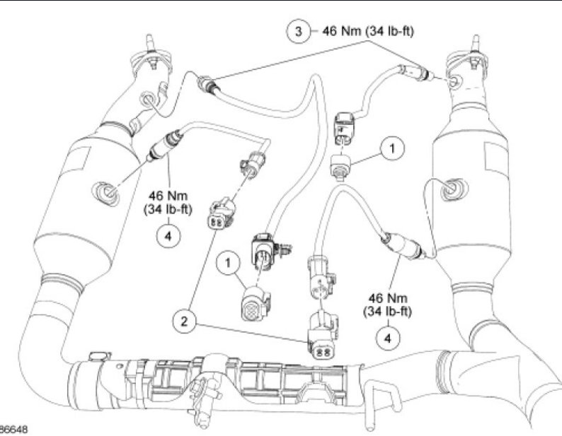

First truck I have ever owned ie. 2009 F-150 Ford King Ranch. I live in Canada. Was consistently getting 14L/100 km for months when service engine light came on. Next day my fuel bettered to 13L/100km. A day or two later it went to 12L/100km. Garage checked code and said problem was an O2 sensor which needed to be changed. $300.00 later I drove out and mileage went to 15L/100 km. It has stayed there and never got any better. Is this worth mentioning to mechanic as he does not like to discuss fuel economy.

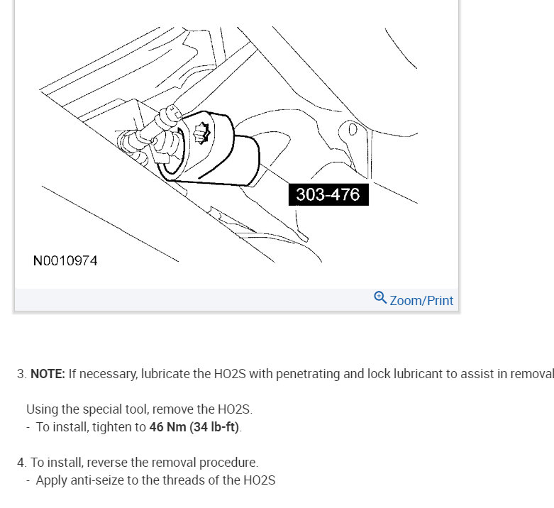

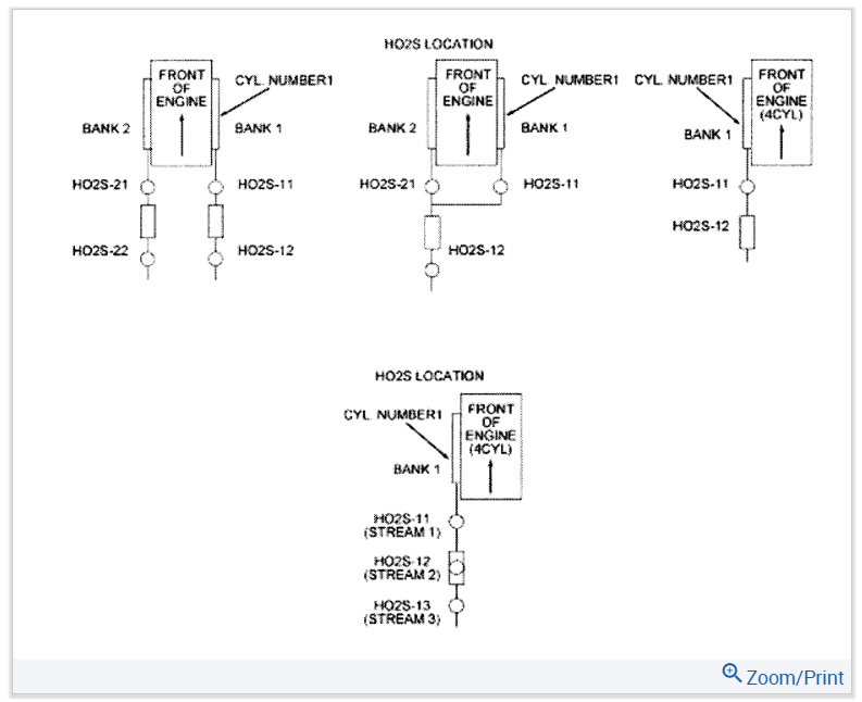

the O2 sensor can be read using live data feed, if it is not working with in the required voltage it should be replaced. failed o2 sensors will increase fuel economy. Here is how you can change the sensors and their location as well in the diagrams below but check out this guide first
https://www.2carpros.com/articles/how-to-replace-an-oxygen-sensor
and
https://www.2carpros.com/articles/how-to-test-an-oxygen-sensor-02-sensor
Please run down these guides and report back. The secondary sensors are thein the catalytic converters. Check out the diagrams (Below). Please let us know what happens.

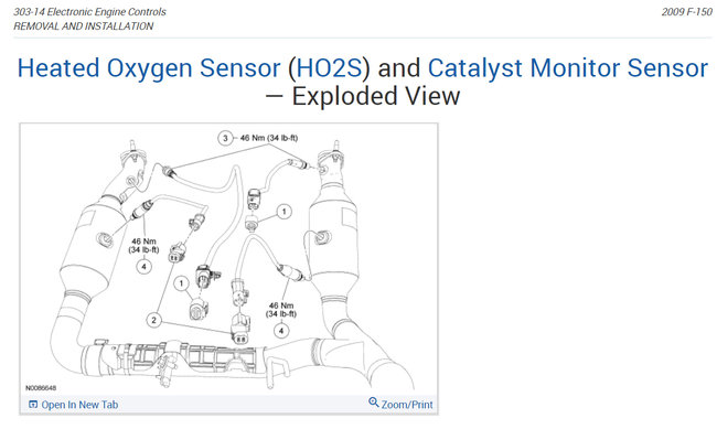

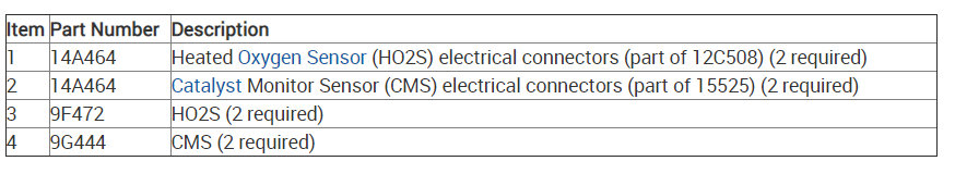

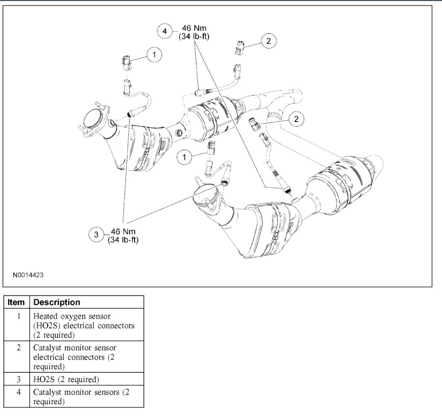

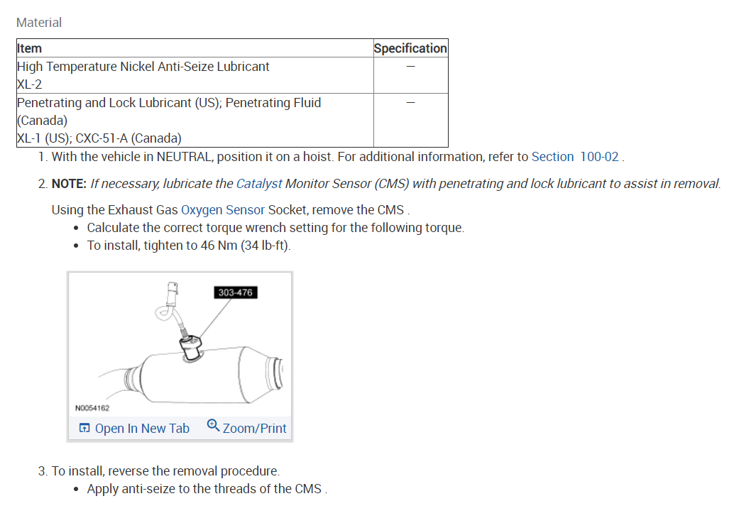

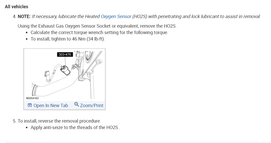

How many O2 sensors on the truck listed above STX model, regular cab?
Sep 10, 2020 at 11:07 AM (Merged)
DANNY L
  • 5,648 POSTS
Hello, I'm Danny.
It's showing four sensors in total. Two are pre-catalytic converter and the other two are mounted in the converters. I've attached a picture below. Here is a tutorial showing how to replace Ho2 sensors:
https://www.2carpros.com/articles/how-an-oxygen-sensor-works
Hope this helps and thanks for using 2CarPros.

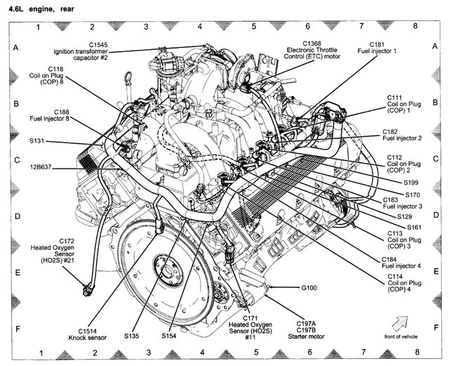

I have a 2004 Ford F-150, 4.6. It’s reading codes 2195 and 2197 which are O-2 sensor codes. I’ve replaced both #1 O-2 sensors, the MAF sensor, the fuel filter and all suspect Vacuum hoses. I’ve also checked for Vacuum leaks, cleaned the ICV and EGR valve. The fuel pressure is 38 (should be between 30 and 40). Checked the temp. in front of and behind the Catalytic Converter ( under 100 degrees difference). I’ve invested a lot of money in parts that have not resolved the problem. Can I check the ICV by connecting it to a battery and see if *** is fully opening? I’ve checked the ohms (reading 10.1 – 2prong). I could sure use some help ! Thanks
FIXITMR
  • 9,990 POSTS
so there's no performance problem only the codes wont go away? you did erase them after parts change?
TOM HAY 58
I'm sorry I should have said The truck is ideling worse then before. When it's first started it will idel fast then very rough at around 1000 rpms then die.
FIXITMR
  • 9,990 POSTS
could be vacuum leak check All the hoses, check for cracks in the intake manifold, bolts loose, gasket sucked in, air entering the exhaust ahead of the OX sensors is all detected by the OX sensors and try to richen up fuel injected but can only go so far in corrections..
This goes to the point the motor runs rough from leaness in and not enough fuel to counter the leaness.
There are different procedures to use for leak detection. Some use propane, some use smoke, some use a scanner to watch certain sensor reactions to forced test procedures.
