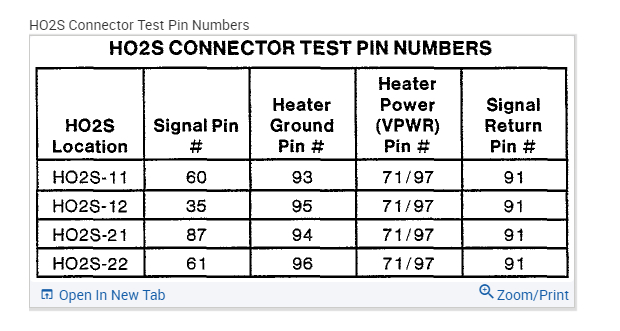

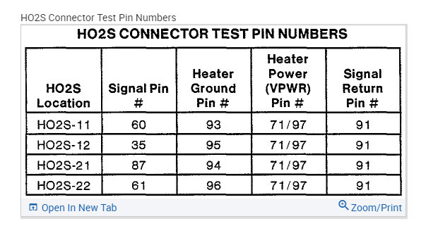

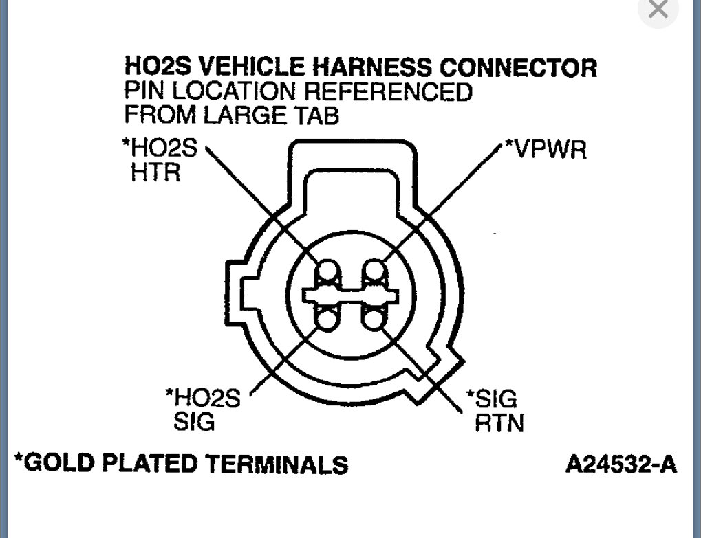

i am doing some testing on my o2 sensors. could you give me the pin out on the bank 2 sensor 2 (downstream) o2 sensor? the engine is the 3.0 vulcan vin "u".
thank you in advance for your reply!
Feb 6, 2022 at 10:07 PM
No problem. Here is the pinout for them plus here is a guide if you need it to test these sensors:
https://www.2carpros.com/articles/how-to-test-an-oxygen-sensor-02-sensor
Please see the info attached and let us know what questions you have.
