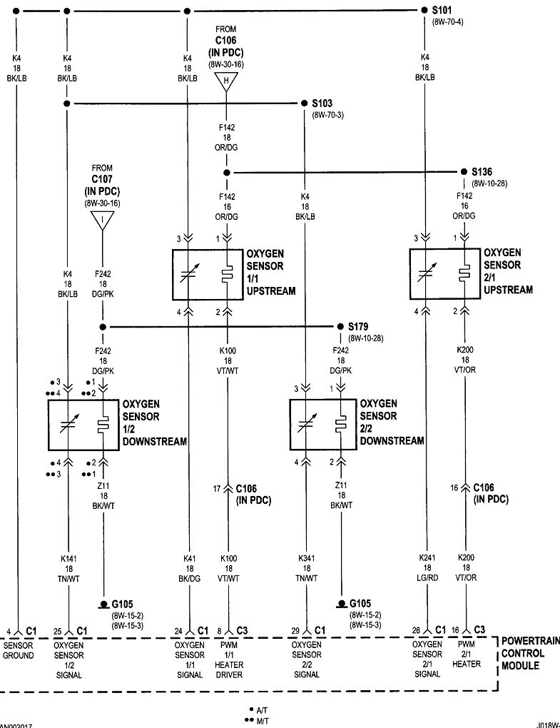

So, I have the vehicle listed above sport 4.7L V8 throwing codes P0155 HO2S-21 (Bank 2 sensor 1) Heater circuit malfunction, P0141 HO2s-12 (bank 1 sensor 2) Heater circuit malfunction, P0455 EVAP large leak, and finally P0422 EVAP small leak. What can be done to fix these codes and if I replace the 2 O2 sensors I might as well replace all of them, so I need the location for all of them and part numbers for good replacements. And I have an issue getting it started. It usually takes a few cranks to start and after that it runs fine. Any and all advice is welcome as long as it's good.

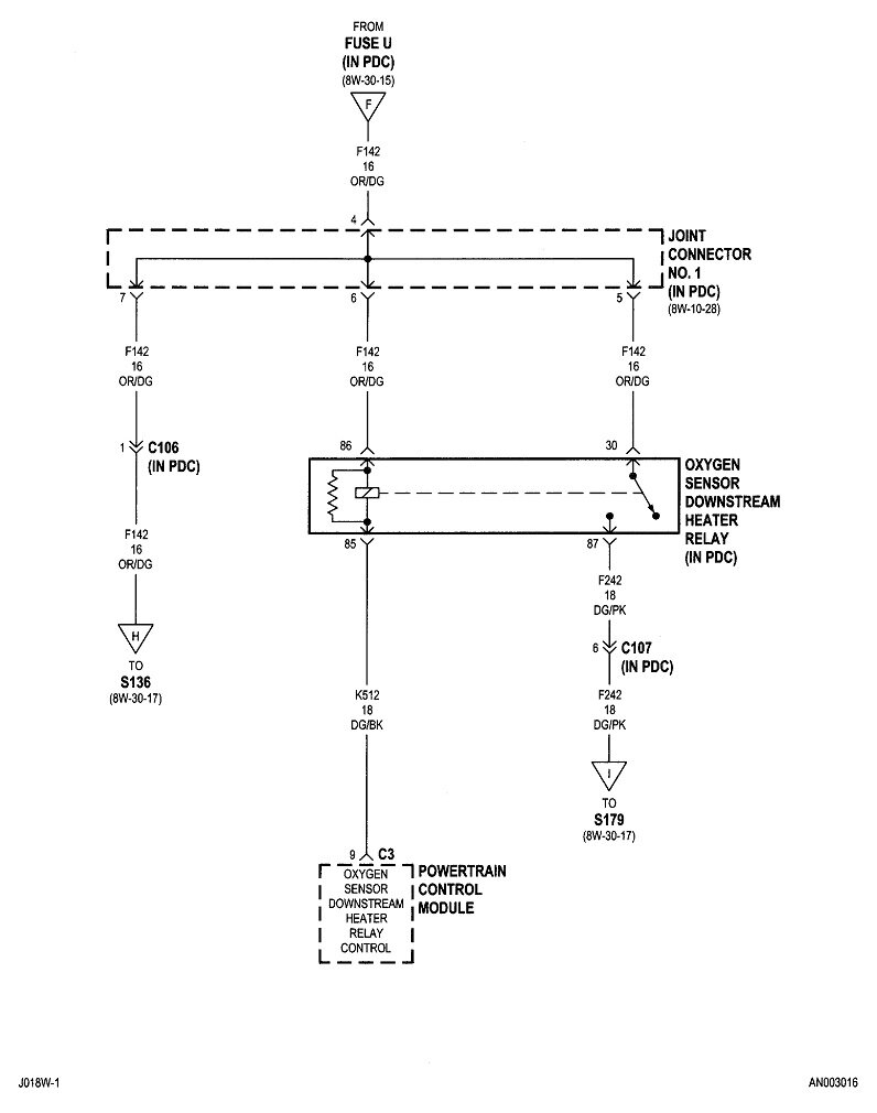

Instead, there's two ways I would approach this. The first one is to replace just one of the O2 sensors, erase all the fault codes, then see which ones set again. Normally when there's multiple O2 sensor failure codes, we look for something other than the sensor themselves to see what they have in common. If these two codes showed up at different times, over a long period of time, then it is indeed a good bet each one has failed, but if both codes showed up at the same time, look for a wiring issue first. In this case it's hard to figure out how these defects were detected. In the first diagram, the relay feeds 12 volts to all four heater circuits, but in the second diagram, it's only the two front, or upstream sensors that have their heater current monitored on individual circuits by the Engine Computer. The heaters for the two downstream sensors just go to ground with no way to monitor current flow through them. That means the Computer has to determine when there's a problem by watching their performance. Part of that involves seeing or creating a momentary change for the front sensor to detect, then watching to see if the rear sensor picks up the same thing or some other expected result. Any time the computer uses one sensor's signal to compare to that of another sensor, it knows those results can't be trusted when the first one has a fault code set. Some self-tests on the second sensor get suspended until the first problem is repaired. This is where, while not common, you could replace a front sensor for a fault code, then the self-tests resume and a defect is seen for the rear sensor and a new code is set for that one.
