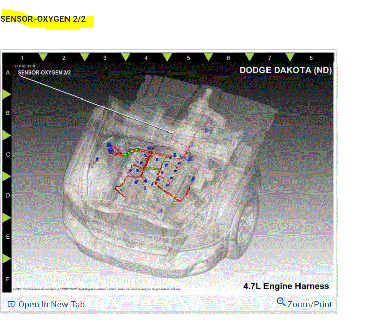

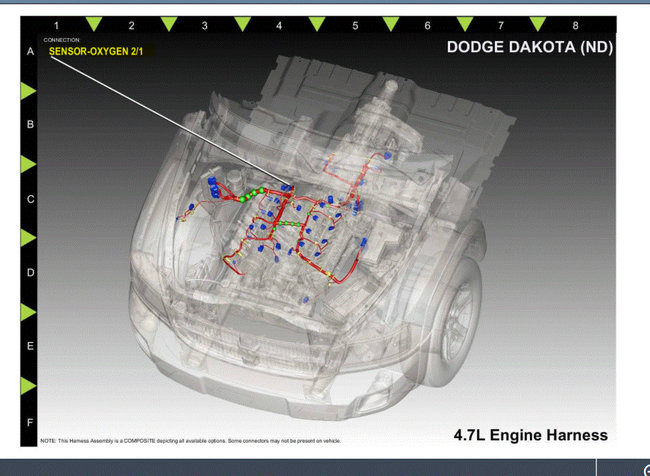

i was told my truck is throwing a code for the o2 sensor on bank 2. where is it located? Why do people keep asking me is it upstream or downstream mean?
is it important to know if it's upstream or downstream for a bank 2 on the o2 sensor?

There are a total of 4 oxygen sensors on this vehicle. Upstream simply means before the catalytic converter. These are usually either in the exhaust manifold or very close to it. Downstream means after the catalytic converter. So, that is why there is confusion.
Bank 2 has 2 sensors, an upstream and a downstream. If you provide the code that was found, I can let you know what needs to be done.
I attached two pics below. The first shows in general where bank 2 sensor 1 is located. This would be the upstream sensor at the rear of the exhaust manifold.
Pic 2 shows bank 2 sensor 2 location which is under the vehicle on the exhaust system. That would be the downstream sensor.
