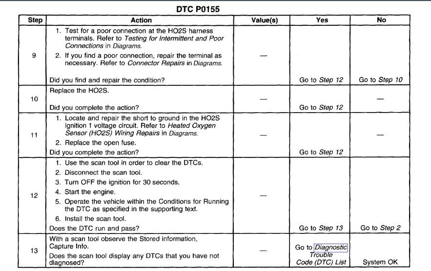

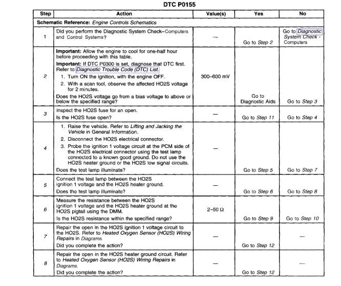

Good afternoon,
I attached the description and a flow chart for you to follow. It is the sensor in most cases that causes this code but there are many other possibilities as well.
CIRCUIT DESCRIPTION
The Heated Oxygen Sensor (HO2S) is a sensor designed to create a voltage relative to the oxygen content in the engine exhaust stream. The control module supplies the HO2S with signal high and low circuits. Ignition voltage and ground are supplied to the HO2S heater by independent circuits. The oxygen content of the exhaust indicates when the engine is operating lean or rich. When the HO2S detects that the engine is operating rich, the signal voltage is high, and decreases the signal voltage as the engine runs leaner. This oscillation above and below the bias voltage, sometimes referred to as activity or switching, can be monitored with the HO2S signal voltage.
The HO2S contains a heater that is necessary in order to quickly warm the sensor to the operating temperature. The heater also maintains the operating temperature during extended idle conditions. The HO2S needs to be at a high temperature in order to produce a voltage. When the HO2S reaches the operating temperature, the control module monitors the HO2S bias, or reference, voltage. The control module also monitors the HO2S signal voltage for Closed Loop fuel control. During normal Closed Loop fuel control operation, the control module will add fuel, or enrich the mixture, when the HO2S detects a lean exhaust content. The control module will subtract fuel, or "lean out" the mixture, when the HO2S detects a rich exhaust condition.
This Diagnostic Trouble Code (DTC) determines if the HO2S heater circuit is functioning properly by monitoring the time required for the HO2S to reach the operating temperature. This DTC sets when the Powertrain Control Module (PCM) fails to detect HO2S voltage transitions above and below the bias range within a specified time.

CONDITIONS FOR SETTING THE DTC
The HO2S voltage remains within 150 mV of the startup voltage for a predetermined amount of time, based on ECT and air flow.
ACTION TAKEN WHEN THE DTC SETS
The control module illuminates the Malfunction Indicator Lamp (MIL) on the second consecutive ignition cycle that the diagnostic runs and fails.
The control module records the operating conditions at the time the diagnostic fails. The first time the diagnostic fails, the control module stores this information in the Failure Records. If the diagnostic reports a failure on the second consecutive ignition cycle, the control module records the operating conditions at the time of the failure. The control module writes the operating conditions to the Freeze Frame and updates the Failure Records.

The heater diagnostic will only run on a cold start and run once per ignition cycle.
An oxygen supply inside the HO2S is necessary for proper operation. The HO2S wires provide the supply of oxygen. Inspect the HO2S wires and inspect the connections for breaks or for contamination. Refer to Heated Oxygen Sensor (HO2S) Wiring Repairs in Diagrams.
