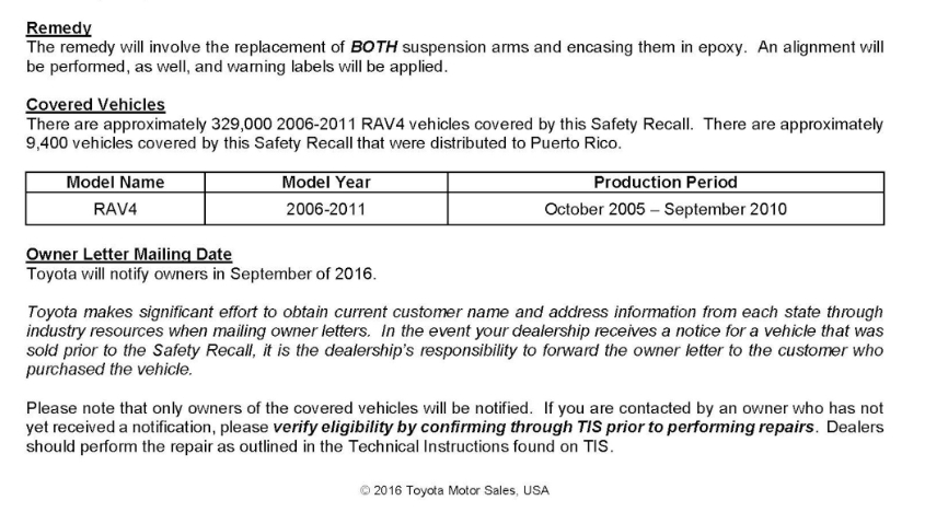

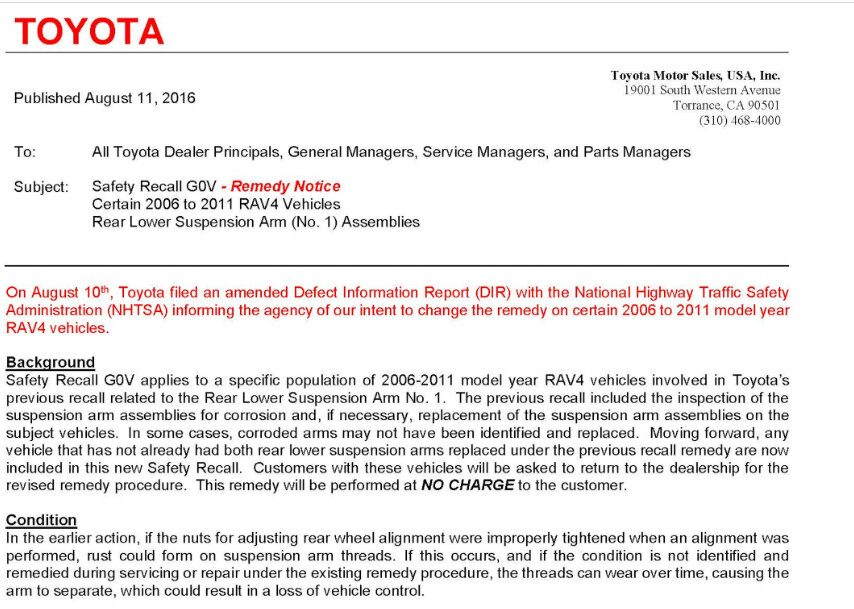

I'm not aware of any issues with the rear wheels or suspension. There was a recall related to a rear lower suspension arm. It could be related. Take a look below. It explains the recall.
Although I don't feel this would cause the sound you heard, it may have led to uneven tire wear that is making noise. The idea that you only hear it when you accelerate leads me to think it is related to the powertrain. For example, a wheel bearing, a failing CV joint, or even a problem with a universal joint. But you said it doesn't have that type of sound.
Regardless, what I suggested above is a theory. Not being there to experience it makes it difficult.
Let me know,
