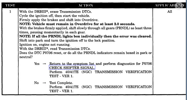

If it is exactly the same as before, although it is related to the range sensor, it sounds more likely the result of a wiring or connector issue. There is a reset procedure for clearing faults related to the PRNDL system, but it requires a scan tool that can communicate with the PCM.
I attached the directions below if you want to try them. I don't know if you have a scan tool that can do this, so let me know about that.

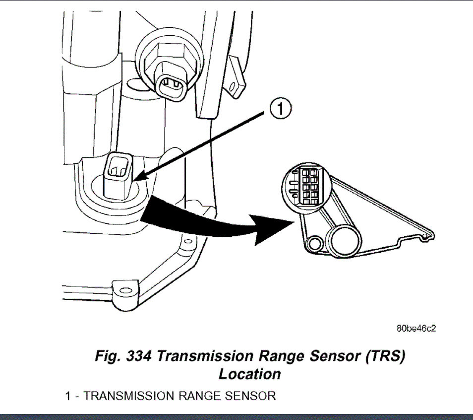

By any chance, were there diagnostic trouble codes related to the issues before the repair? Also, have you had the computer scanned since the problem started again? Also, is it possible for you to check the connector at the range sensor to make sure it's tight, clean, has no corrosion, and nothing is damaged where it connects? Pic 2 below shows the sensor/location.
Let me know. Also, let me know if you have codes that may help.

I asked the mechanic and he confirmed with me that it was as tight as it could go and that all wires seemed in good shape. Unfortunately, I don’t have a transmission code reader, only a regular engine code reader. (The mechanic doesn’t have one either) I have ordered a scan tool and hopefully that will be able to provide more info? It is a Launch Crp123?

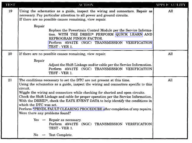

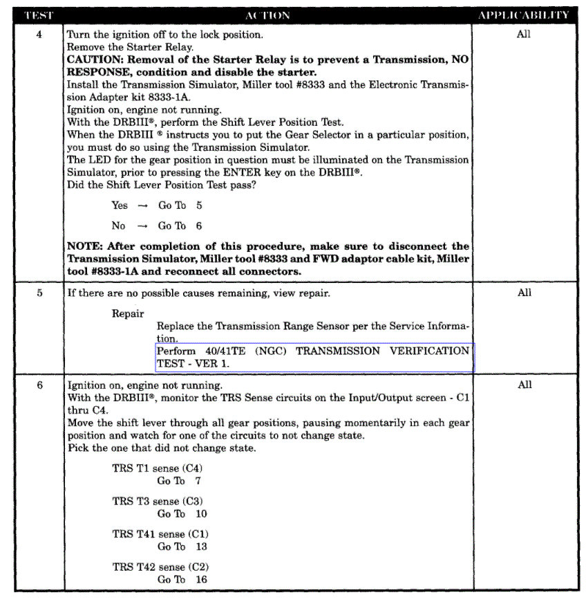

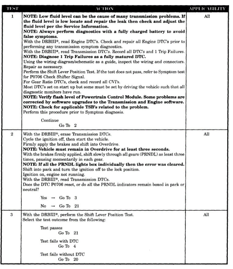

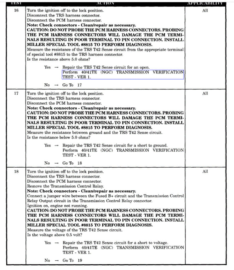

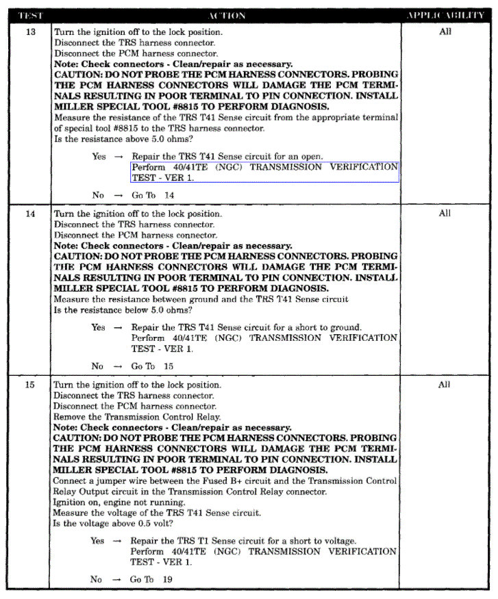

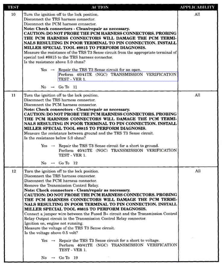

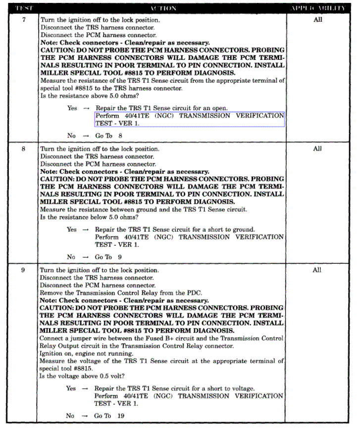

I did get a code P0706 Check shifter signal on the reader, I’m guessing it may be a wire issue like you said? I have tried researching tirelessly to find the correct connector online but not having much luck. Would you be able to help me find the correct connector part number or where I can but the connector for the range sensor? Or do I need to try to salvage the range sensor that I have because it will be very hard to find another?
Feb 20, 2022 at 8:56 AM
  • 110,244 POSTS
Based on that code, I do feel it is related to the sensor or sensor wiring. The idea of replacing the wiring harness isn't limited to the transmission. The harness will be for other things as well, so it's best to try to fix what you have.
I attached the diagnostics below. They may seem a bit overwhelming, but they are specific to the code you have. Take a look through them to see if you are comfortable performing them and let me know.
