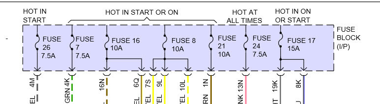

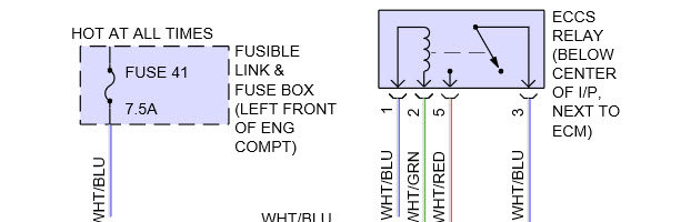

HMAC300
  • 48,601 POSTS
Check fuses and items in pic like the relay that is shown. Then scan for codes.
