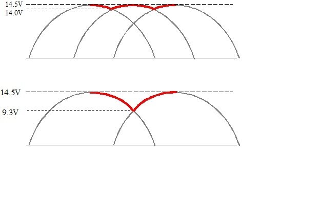

Dandy reply, but please allow me to add a few comments of value. Normally I would say the worst way to test a generator is off the engine because that testing doesn't include the vehicle's wiring and in many cases the voltage regulator. Bench testers also aren't strong enough to drive generators to their maximum output capacity, and they don't check for "ripple" voltage.
This case is different in that the charging system can't be tested because the engine stalls. You eluded to the fact that jumper cables needed to be connected, but to continue the thought, that means it was the donor car that was under test.
The first thing to consider is the battery is totally discharged. When that happens, it can take a good 15 minutes before it starts to take a charge. It can take that long for the acid to become conductive, then the electrons begin to get absorbed into the plates. If you use a small portable charger on a low rate, you'll see the meter indicate near 0 amps for that first 15 minutes, then it will slowly start to rise. After a few hours, the battery can be considered to be fully-charged when the current drops below around 5 amps.
The next problem has to do with how the voltage regulator works. That varies between brands and models. Some will see the low battery voltage when the jumper cables are disconnected, and respond by shutting down. That means no output from the generator, so the engine stalls. On other models, the voltage regulator will get up and running with the jump start, then once they're disconnected, the regulator will see the low battery voltage, and make the generator run harder to produce higher voltage and more output current. I'll add one more comment related to this later.
The next problem has to do with the "diodes" in all "AC Generators". (We all know what is meant by the word "alternator", but to be technically correct in the classroom, that is a Chrysler term. They developed the alternator for 1960 models and copyrighted the term). For the rest of us, the industry refers to them as "AC generators". Regardless, they all have at least six diodes which are one-way valves for electrical current flow. Generators put out three-phase output current which is very stable and efficient. The point of this sad story is if one diode fails, you'll lose one of those three phases, and the generator will lose exactly two thirds of its current-generating capacity. The standard generator for this model is a 90-amp unit. That means with a failed diode, all it will be able to develop is close to 30 amps. That's not enough to meet the demands of the entire electrical system under all conditions. The battery will have to make up the difference as it slowly runs down over days or weeks. If the battery is already run down, there won't be enough output from the generator to run the vehicle even if the voltage regulator did start up.
To add to the confusion, this is where a generator with a bad diode can still test "good" on a test bench. It takes about a one horsepower motor to run a generator supplying 30 amps on a test bench. To get full output from a properly working generator takes closer to five horsepower. Bench testers don't have electric motors that big.
"Ripple" voltage refers to the unsteady output voltage, as shown in my first drawing. This generator will develop up to 90 amps with all good diodes, and ripple voltage for this example is shown as 0.5 volts, (red section). Below that, one phase is missing. Here again, the red section shows the output voltage that will be developed. Ripple voltage is 5.2 volts.
Professional load testers test charging systems on the car by measuring maximum output current and ripple voltage. Both are indications as to the condition of the diodes. A few testers that can make paper printouts will list an actual voltage for ripple voltage, but most testers just show it on a relative bar chart as "low" or "high".
The bottom line is bench testers don't measure ripple voltage and they aren't strong enough to drive a generator to its full output current capacity, so they can't show if the diodes are all good or not. This goes back to which way a voltage regulator works. Some will look at the low points in the output voltage, (9.3 volts in the lower drawing), and respond by bumping up the charging voltage. Some will look at the highest point, (14.5 volts), and cut back on generator output, often, again, to the point of stalling.

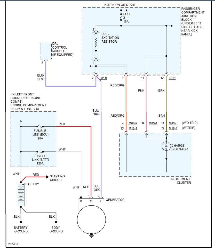

Can I get the proper diagram and information for the 05 Hyundai Elantra GLS the 8th - D - 2.0 DOHC V16 4Cylinder Automatic?

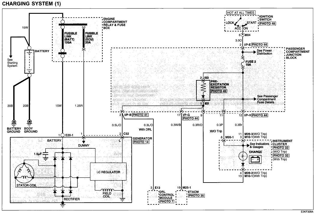

If you can read this diagram, I'm guessing you know how to use a digital voltmeter, but for the benefit of others researching this topic, this article explains it better:
They're using an "auto-ranging" meter which is an expensive feature that isn't needed. You can find a perfectly fine meter at Harbor Freight Tools for around $7.00. Also look at Walmart or any hardware store. I can help with setting it up if necessary.

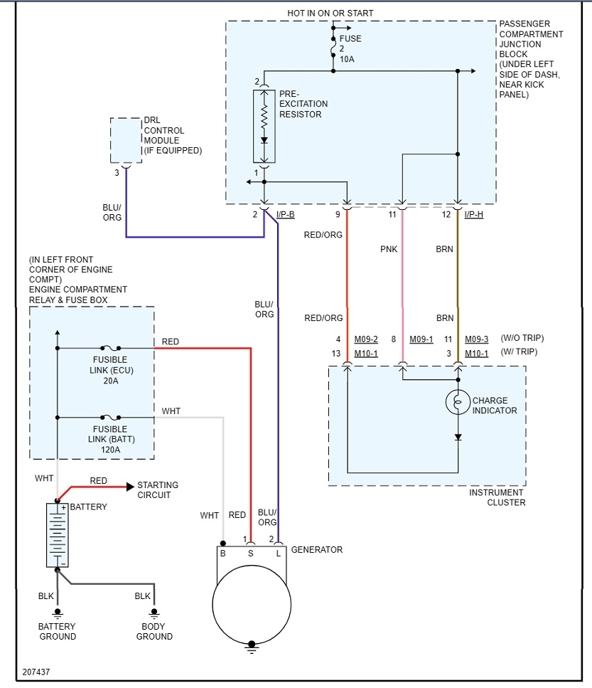

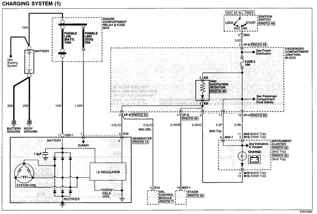

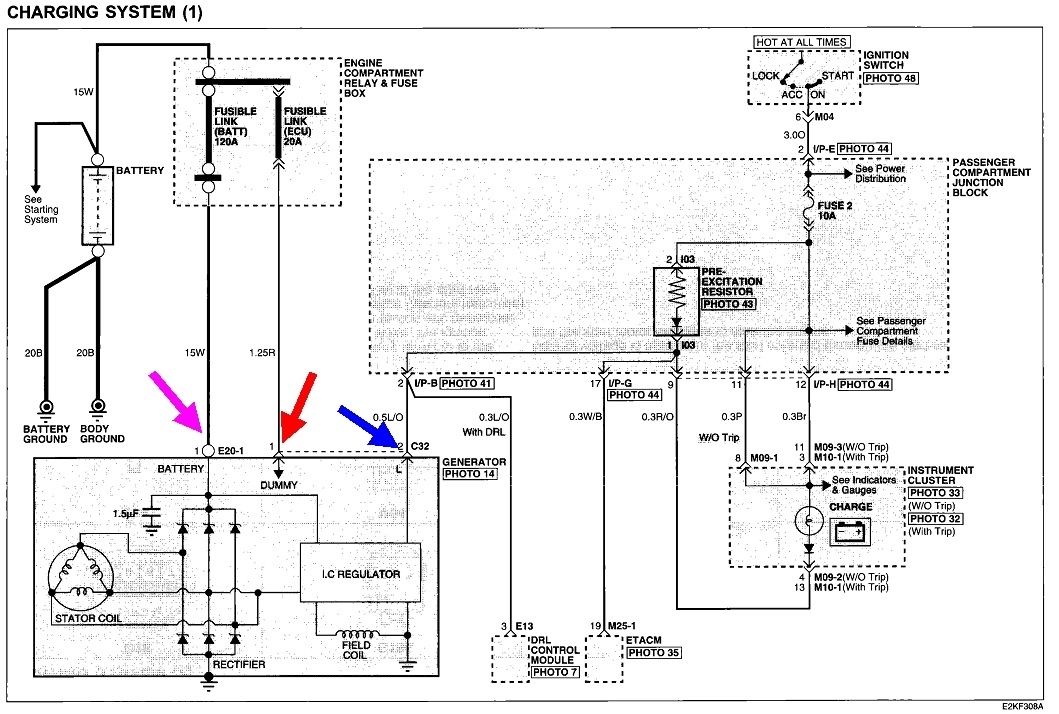

The first step in diagnosing this system is to observe if the "Battery" warning light on the instrument cluster turns on when the ignition switch is turned to "run". If it does not, the blue / orange wire likely has a break. Next, measure the voltage on that wire at the generator's plug, (blue arrow in the third diagram). To be valid, these next two readings must be taken with the connector plugged in. Back-probe alongside the wires to take the readings. Expect to find very close to 2.0 volts. That says the warning light will be on, that wire doesn't have a break in it, that wire's connector terminal where you're measuring is making a good contact, and that wire is not shorted to ground. That is the turn-on circuit that wakes up the voltage regulator to get it started.
Measure next on the red wire, (red arrow). That one must have full battery voltage all the time. This circuit supplies the current that runs the voltage regulator, feeds the electromagnetic "field" coil, and is where system voltage is monitored.
The last wire is the fat output wire that's bolted to the back of the generator, (pink arrow). That one also must have full battery voltage all the time. If you find 0 volts there, the large 120-amp fuse link is burned open. The two common causes of that are a metal tool touched it and something metal on the engine at the same time, or a defective generator had two or more shorted internal "diodes" that created a dead short.
Let me know how far you get with these tests, then we'll figure out where to go next.

Here's another version of the charging system diagram. If any of these are too hard to read, you can copy them into a typing program such as MS Word where they can be expanded, or I can cut them into smaller pieces, then expand them for you.

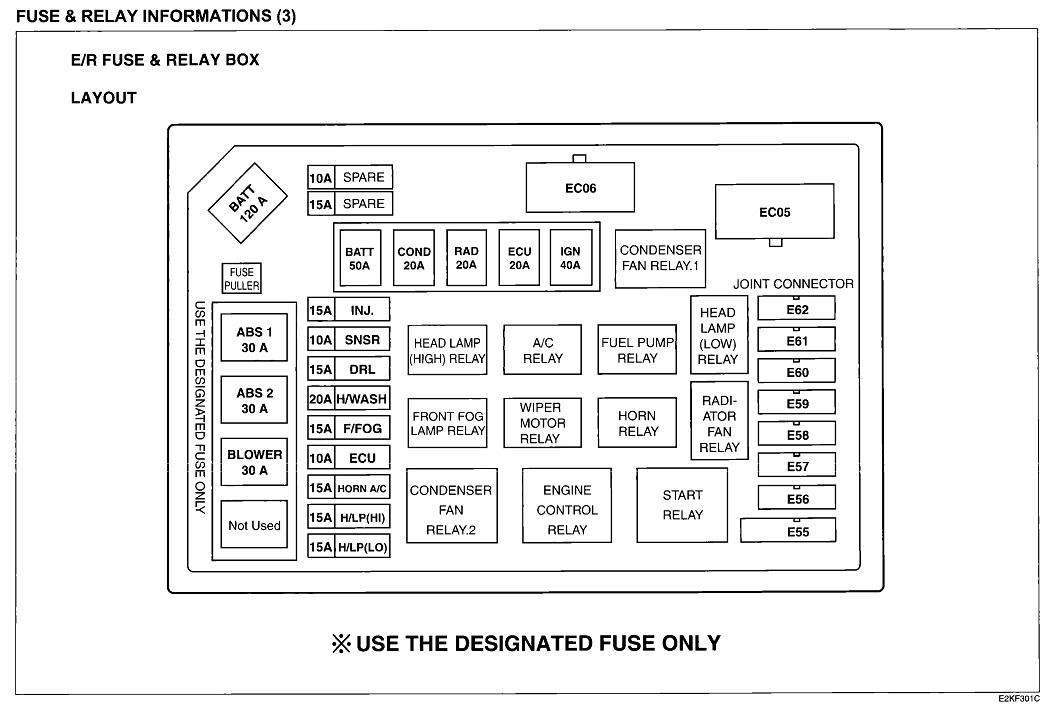

JUDIE_SIMMONS
  • 57 POSTS

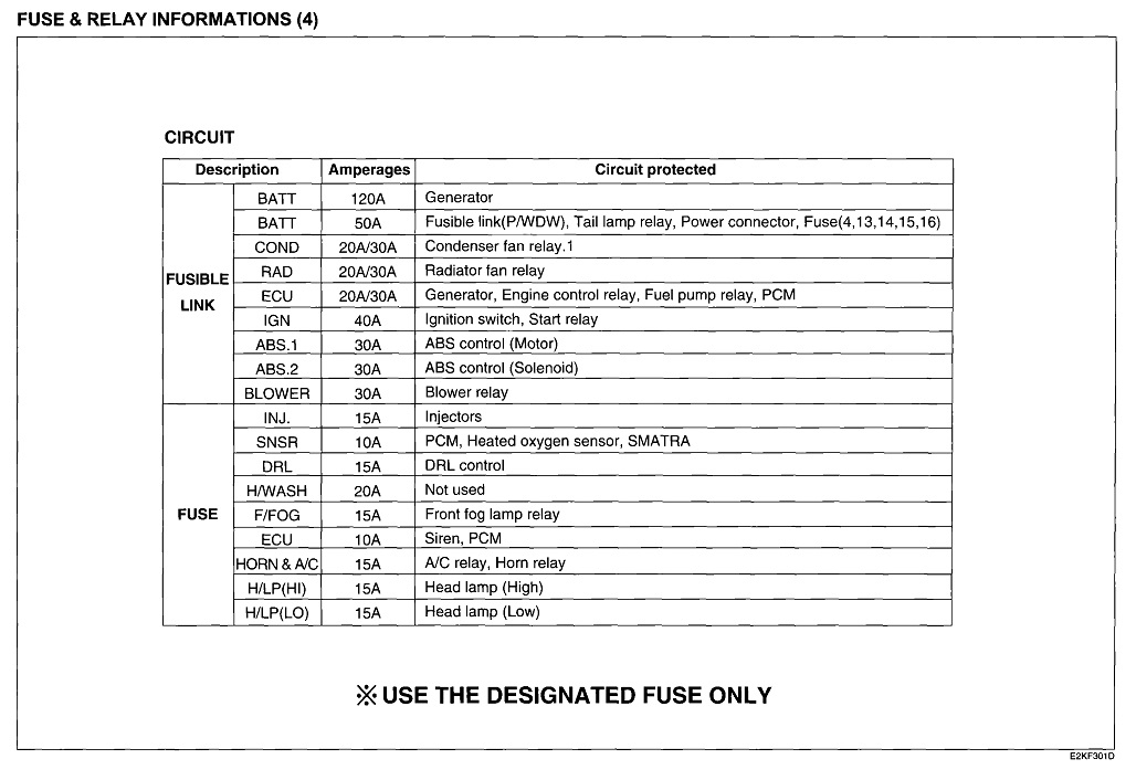

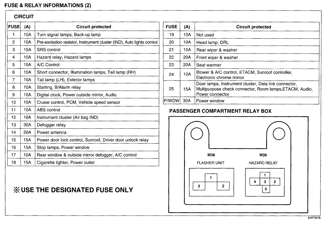

The problem was the alternator fuse that was fixed but now the headlights and everything in the inside of the car doesn't work now but it was working before the alternator fuse was changed.
Wednesday, March 8th, 2023 AT 10:40 AM
CARADIODOC
  • 34,093 POSTS

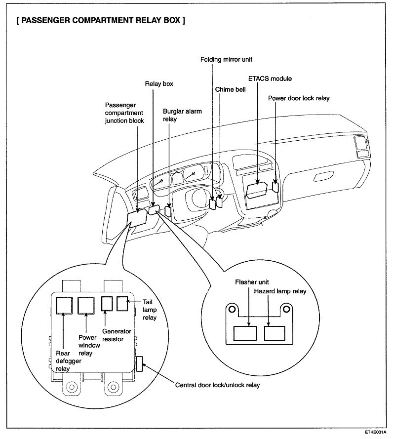

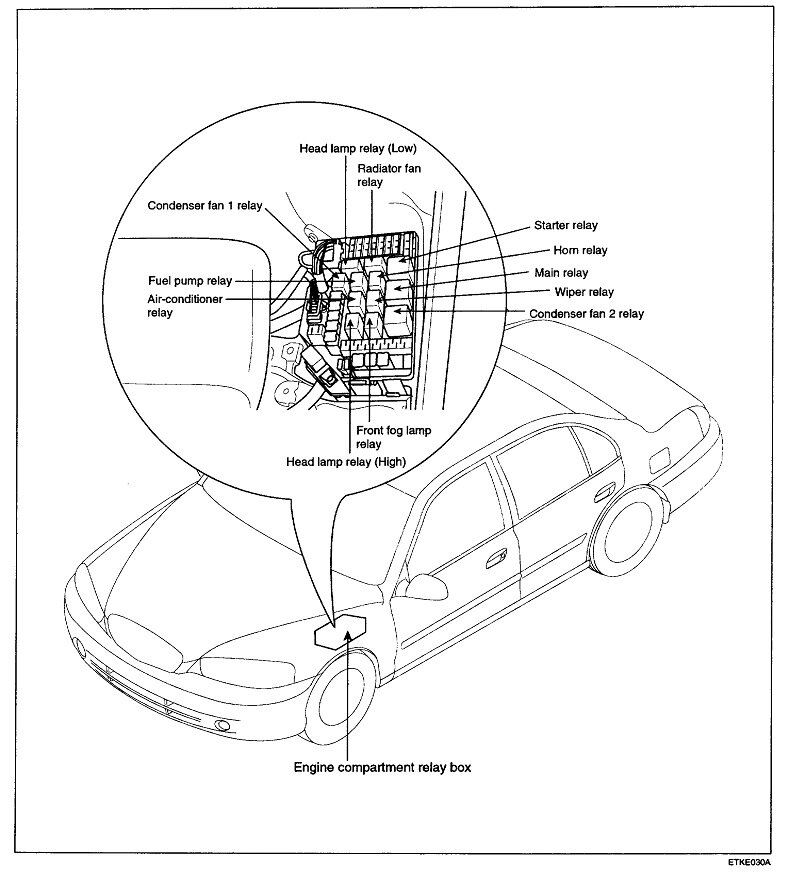

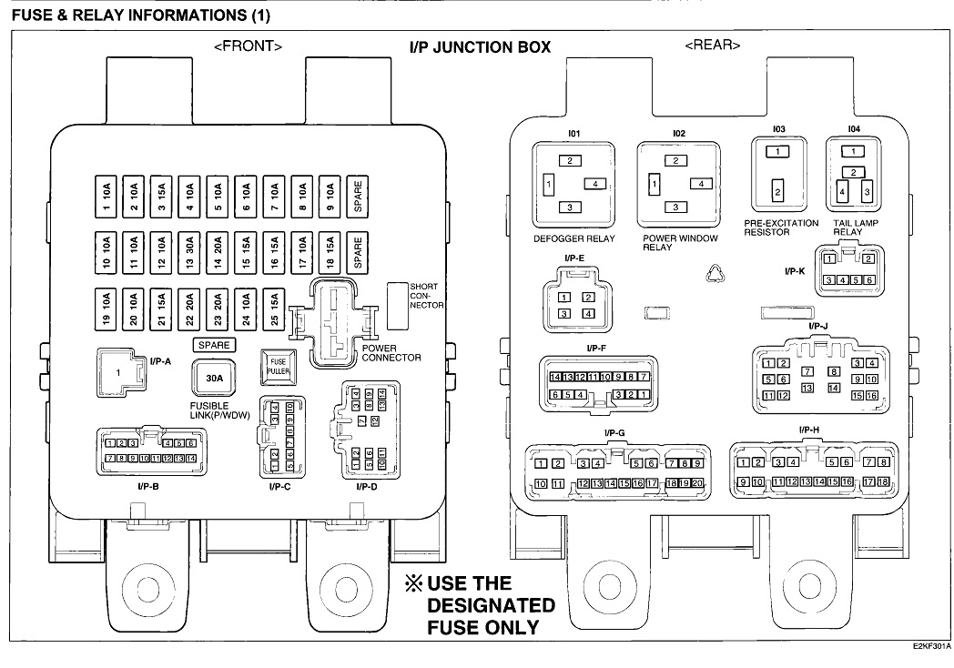

The two are very likely not related, but what is pretty common is for multiple fuses to blow for no reason when connecting the battery or when connecting jumper cables. That is due to the in-rush of current to charge the memory circuits in the dozens of computers. It's even not unheard of to have five or six blown fuses. This is less likely to happen to the large cartridge fuses. You have to rely on a visual inspection to find those. The smaller fuses are the ones to suspect. Most have two tiny holes on top for test points. Test lights work best for finding those that are blown:
This article does a dandy job of showing how this is done so you don't have to pull each one to inspect them:
What you're looking for is any fuse where the test light is bright on one test point and off on the other one. If it's bright, meaning you have 12 volts, on both test points, that fuse is okay. If the light is off on both test points, that circuit is not turned on. You may have to turn on the head light switch, heater fan, and things like that when checking those fuses.
Let me know how this turns out.
Wednesday, March 8th, 2023 AT 5:52 PM
