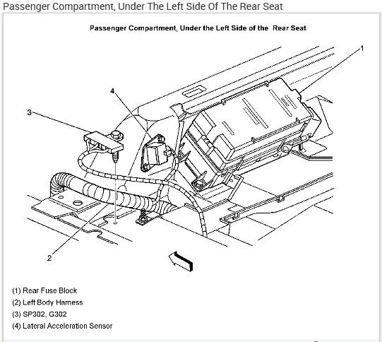

I suspect possibly a relay causing this. Start with replacing the fuel pump relay and see if the problem goes away. It is located in the rear fuse block. This is located under the left rear seat.

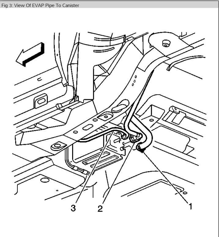

I replaced the fuel relay and that did not make a difference. I replaced the battery while the engine was still cold and when I tried to start it the motor jerked real bad so I turned the key to the off position and then back on and it started. However, once it got warmed up it would not start. So this morning I took the air hose and blew out all the area where the fuses are and around the top of the fuel pump and put the jumper cables on it and it started but still will not restart after it warms up. I noticed there is a black box located right behind the back passenger's side tire that has two hoses running from it and it is making a rumbling noise when the car is in park, will stop when I turn off the AC but will start again a few minutes later. When the gas tank is completely full it will not make that noise but when the tank gets down to or below a half a tank of gas it will start rumbling again. so I disconnected the hoses and tried to clean it off but when I reached up there and grabbed the hose it is like hot rubbery and was all over my hand. Anyway original problem still an issue.

That is the ECAP canister.
Grab a can of starting fluid and then next time it will not start when warm, spray two to three small shots of starting fluid into the throttle opening then quickly make it to the key and try, then let me know if the engine will start for at least a few seconds or not still.
Be careful not to spray any of the exhaust manifold.

No, it still will not start when hot with the starter fluid. I have removed the ECAP canister and cleaned it out. All that did was make the noise stop.

That should have said EVAP.
