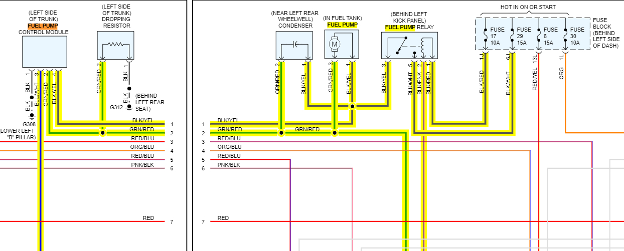

I did go ahead and put the new fuel pump on it yesterday but it's still not starting. The guy that put it on says the fuel pump isn't kicking on because it's not getting power and he doesn't know how to fix that. I don't either. I was thinking maybe a relay but I'm not sure either.

There are fuses, a relay, and a module that controls power to the fuel pump. I attached a wiring schematic below in pic 1. Check the fuses I highlighted and the relay.
If there is a different relay that has the same part number, switch them. If there isn't, here is a link that explains how to test one:
As far as the fuses go, in addition to checking the fuse, make sure there is power to and from them.
Let me know what you find. Also, if you could record it cranking, that may help me.
