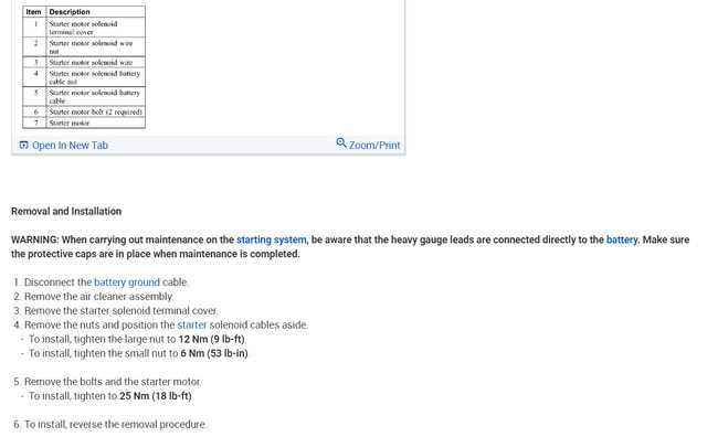

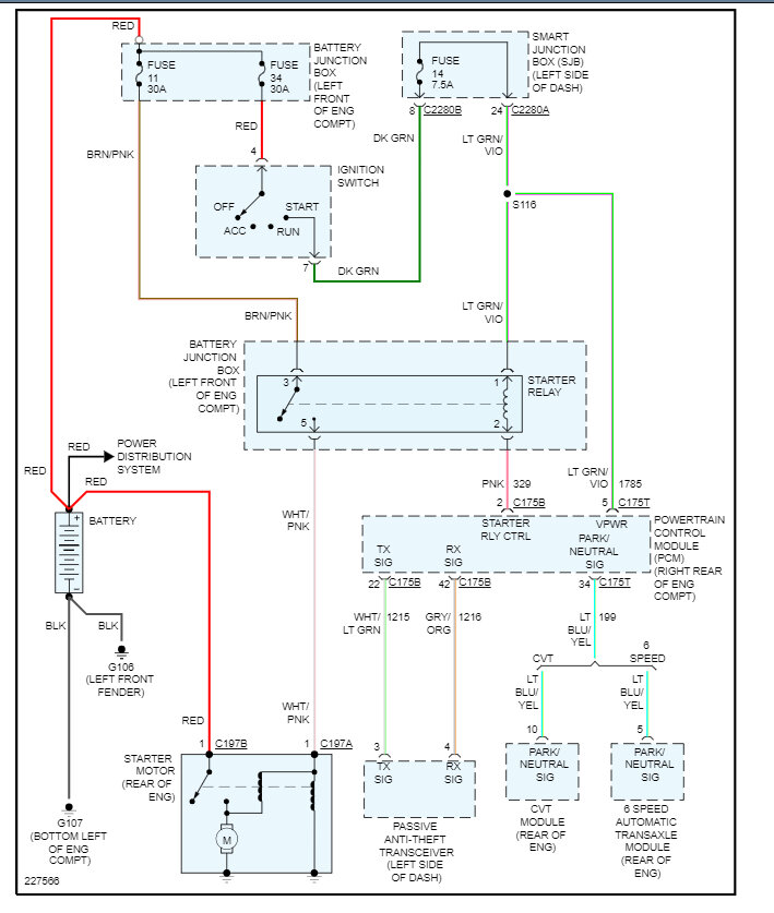

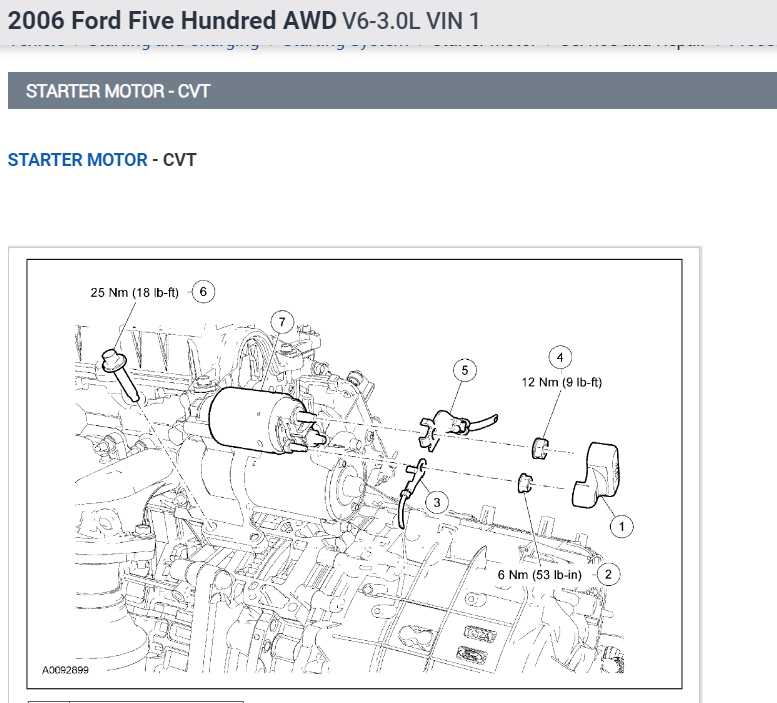

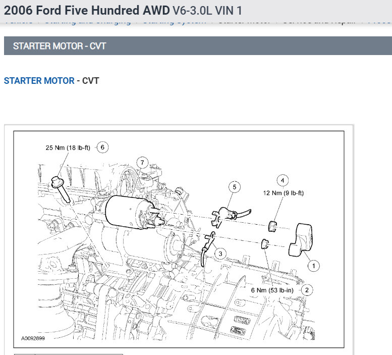

My car will not start when I turn it over there's no click no nothing, I've checked all the fuses or replaced all the fuses batteries good I'm getting battery amperage back but still doesn't start if I cross the start a relay under the hood it'll start though.
Oct 14, 2023 at 7:37 AM
  • 55,399 POSTS

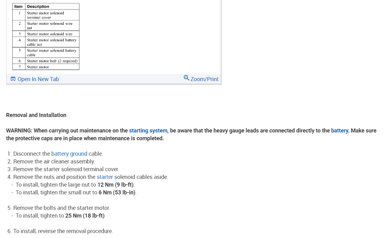

It sounds like a bad starter motor, to be sure let's use a test light on the trigger wire when the key is in the crank position, here is a guide to help and I have included the starter wiring diagrams so you can see how the starter system works.
I have also included how to change the starter motor out in case you need it. Check out the images (below). Please let us know what happens.

When I take out the starter relay and use the wire crossover it starts just fine but otherwise it won't start with the key.
Oct 14, 2023 at 12:08 PM
  • 55,399 POSTS
Okay, let's check fuse #14 inside the SJB (fuse panel on the left side of the dash). Also, is the security light flashing?
Please go over this guide and get back to us.

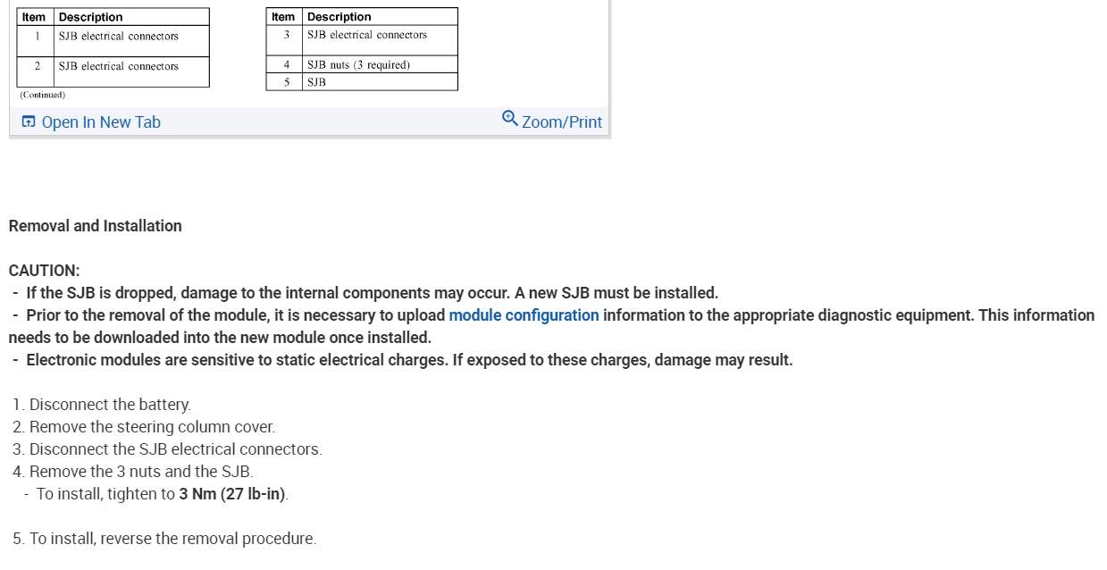

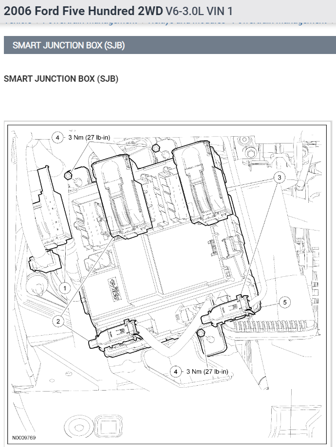

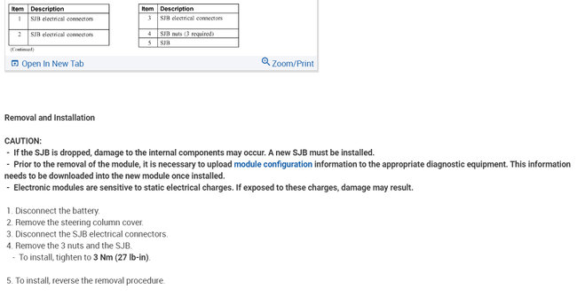

Okay, here's a problem I'm having my car, will start if cross the starter solenoid relay but when I drive it the picture on the dashboard the picture shows that a wrench and power traction control light what is the problem. also, my car won't shift and when I first turn it on the fan will come on and not shut off, I'm not talking about the A/C fan.
Oct 16, 2023 at 5:42 AM
  • 55,399 POSTS
It sounds like the SJB is shorted out, but to be sure let's do a CAN scan. You can get a CAN scanner (Controller Area Network) which will work on most cars from Amazon.
https://youtu.be/u-4syLc-ifQ
Here is how to change the SJB out in case a code is stored for it. Check out the images (below). Please let us know what happens. These modules have problems and cause these kinds of issues.
