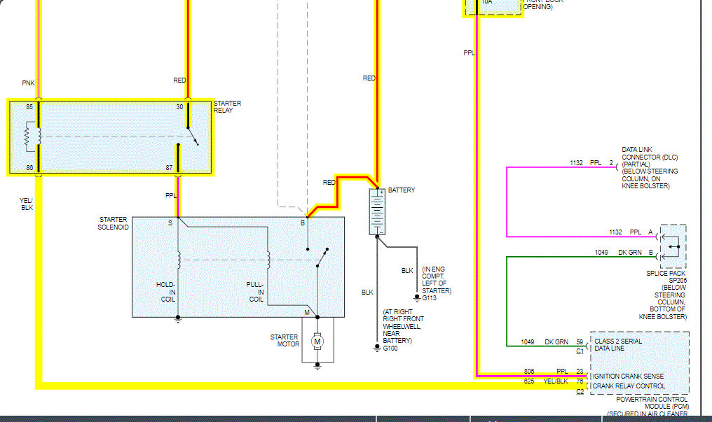

Not start with weak and short cracking
2003 PONTIAC MONTANA
82,000 MILES • 3.4L • 6 CYL • 2WD • AUTOMATIC
XJSHEN
  • 251 POSTS
When tried to test starter on the car there was a circuit shortage happened with spark. Fuses may be damaged, which fuse maybe broken?
after disconnected negative battery end released starter and tested it in AutoZone, the starter was working. When restore starter i wrongly connected battery positive end to negative ground end of starter. And when l reconnect battery negative end, the starter was running.
this error also can damage fuses and parts?
I replaced old starter with a working starter and connected with correct starter ends. But not start with weak short cracking sound.
Headlight and dashboard lights and radio were all turned on. Battery voltage was 12..40 v after charged with jump wire on other car for 5 minutes, but couldn’t start.
after two days the voltage dropped 11.90. I am so sorry for my mistakes..
Thanks your reviews and instructions and helps!

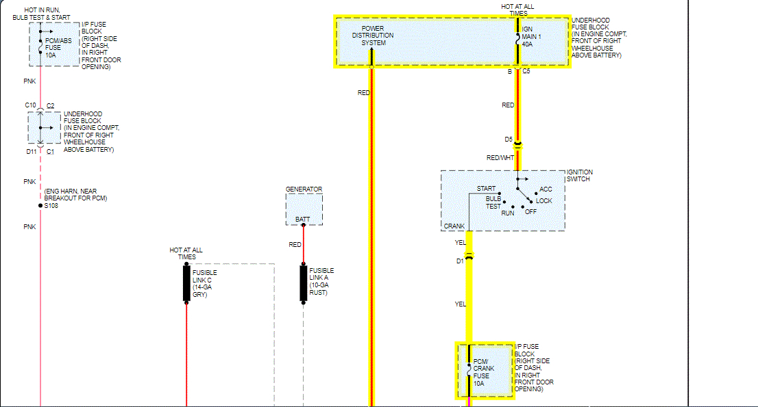

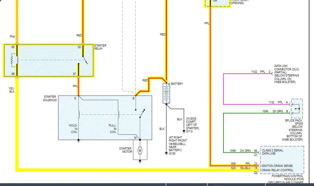

Okay, does the starter make any noise?
You may need to reset the security for the theft system.
https://www.2carpros.com/articles/how-to-reset-a-security-system

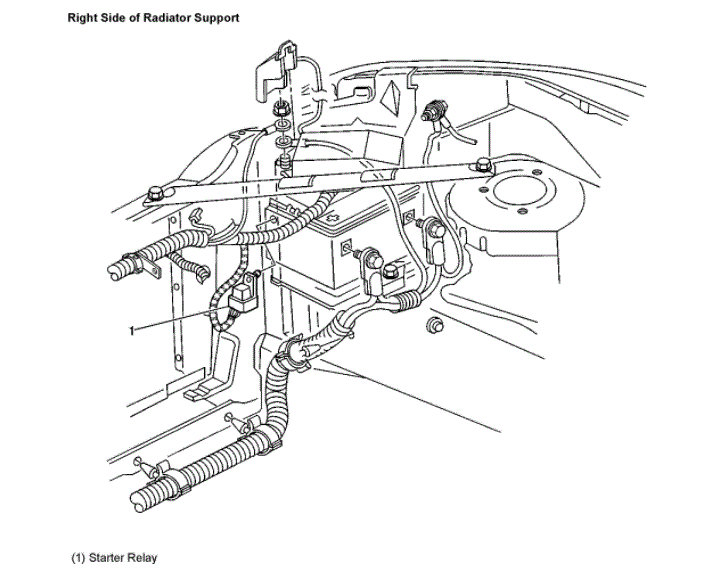

I attached a wiring diagram for you to view.
Do you have a voltmeter or test light to do some checks?
Aug 17, 2020 at 11:55 AM
XJSHEN
  • 251 POSTS
Yes. Start made noise higher than old battery, but could not start. I have multi-meter and light tester. I will check with your sent instructions and document.. thanks a lot!

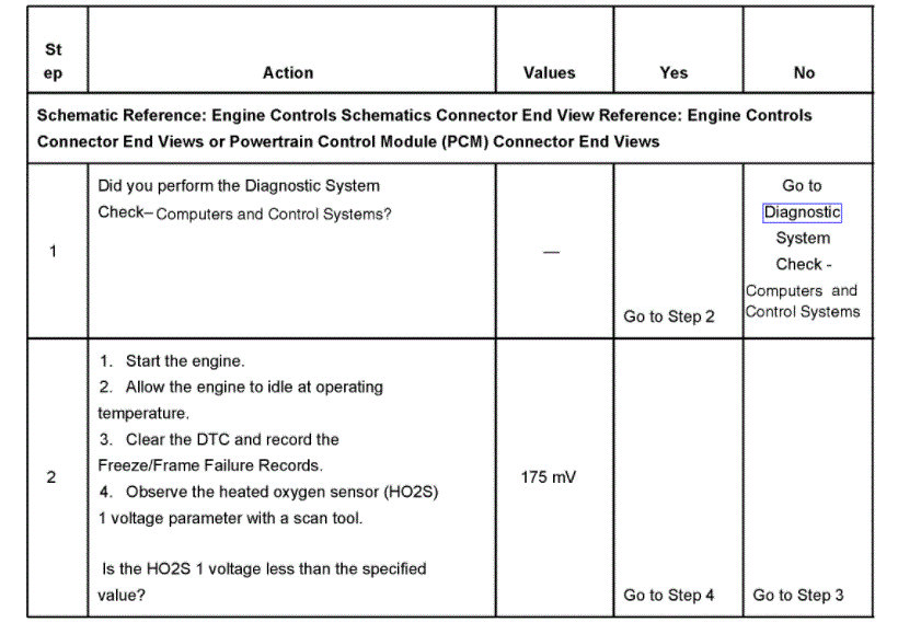

The 131 is for an O2 sensor heater circuit. I posted below about the code and attached the flow chart for you.
https://www.2carpros.com/articles/how-an-oxygen-sensor-works
https://www.2carpros.com/articles/how-to-test-an-oxygen-sensor-02-sensor
The one reading I would like to see is the long term trim reading for the O2 sensor.

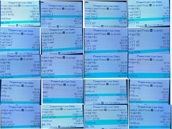

XJSHEN
  • 251 POSTS
Hello Roy,

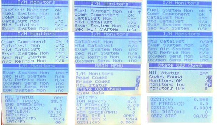

I started to fix the problem by myself. Now ignition is okay, but when start engine the RPM surged 3,200 rpm's, and down to 700 rpm's in idle condition, and up to 1,000 rpm's, and down and up 1,500 rpm's, etc. with vibration, engine running was not steadily. and when changed gear to start running the start is rough with RPM surge over 1,000 rpm's. The gear change is okay, window power, radio, dash board power all on. By short start time and running shortly 5 feet soon triggered codes P0131 and p0300. I just replaced O2 sensor bank1 but got P0131. I recorded power train live data with scanner, Innova 3130Lat+ (power chain live data) (attached first figure) and with Actron RCP9575 (I/M monitors data) data, but I do not know how to explain the data, and what was problem.
TSP value is looked high 27.5% to 30%, and O2 bank1 sensor problem is recognized.
May you provide your professional comment on the data and instruct me how to find the problematic location and parts.

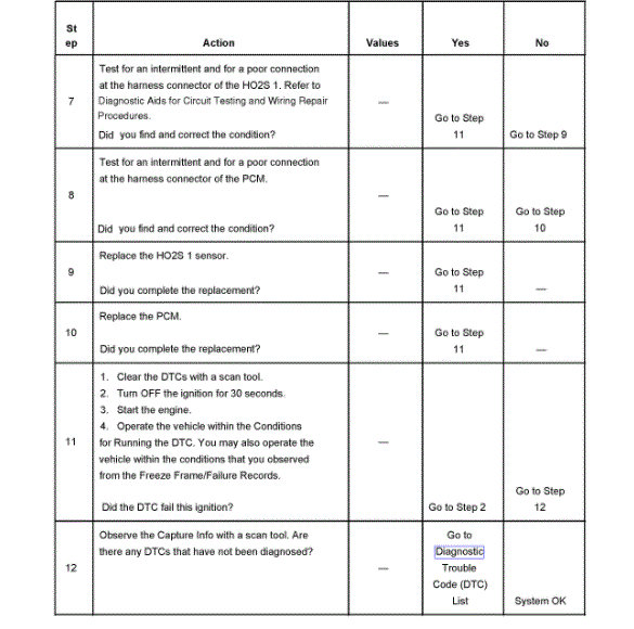

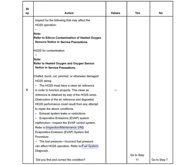

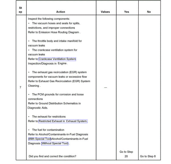

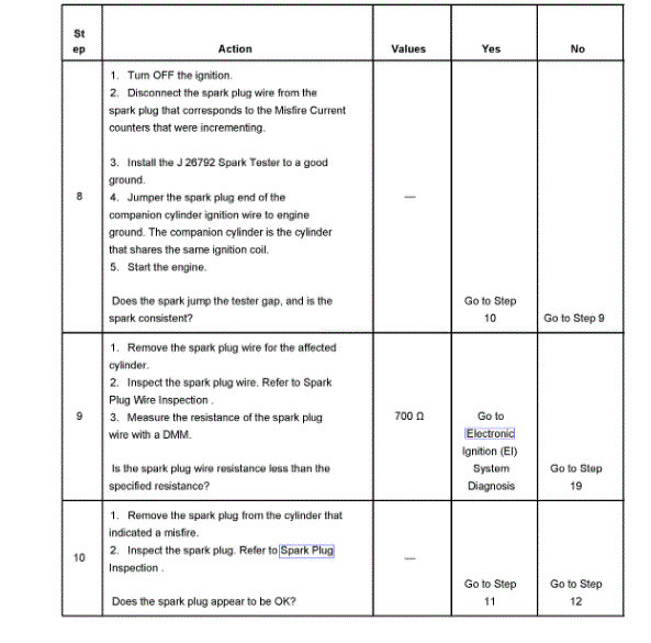

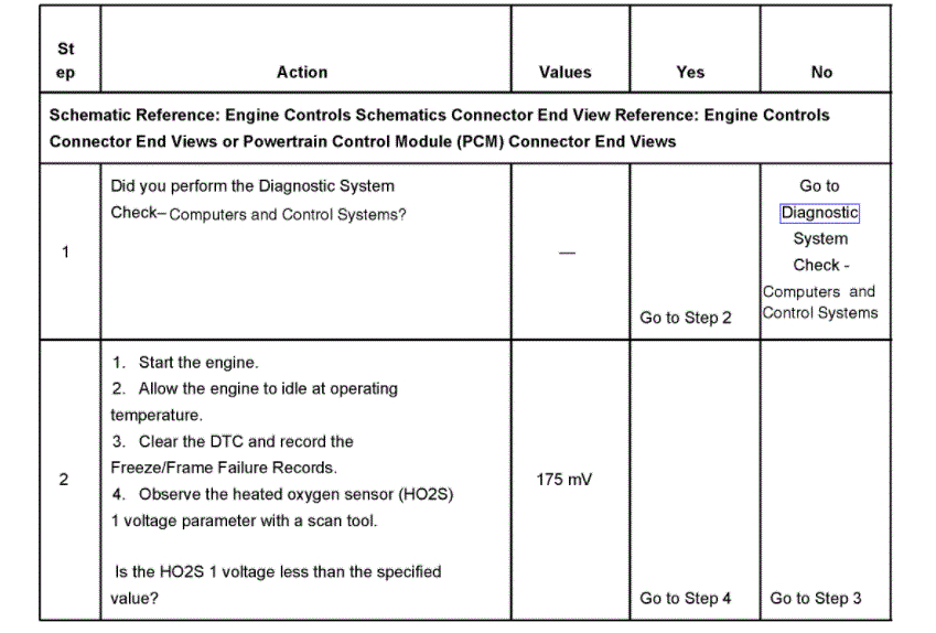

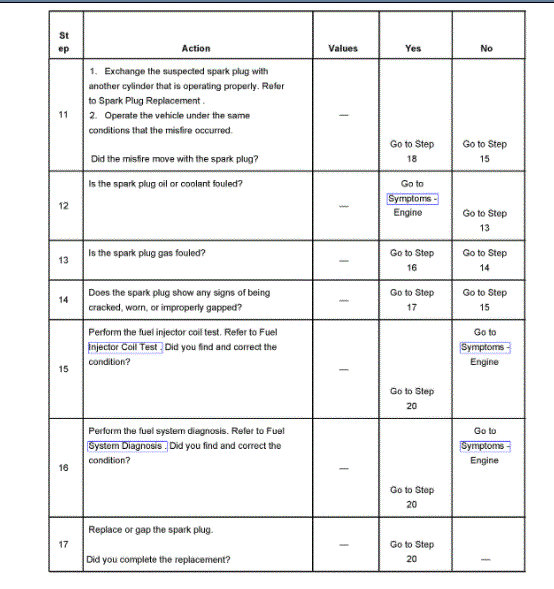

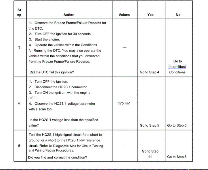

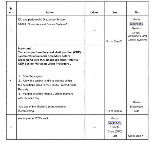

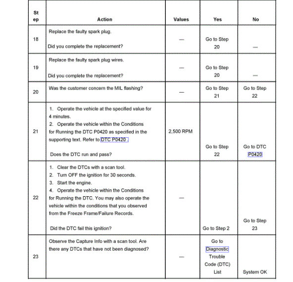

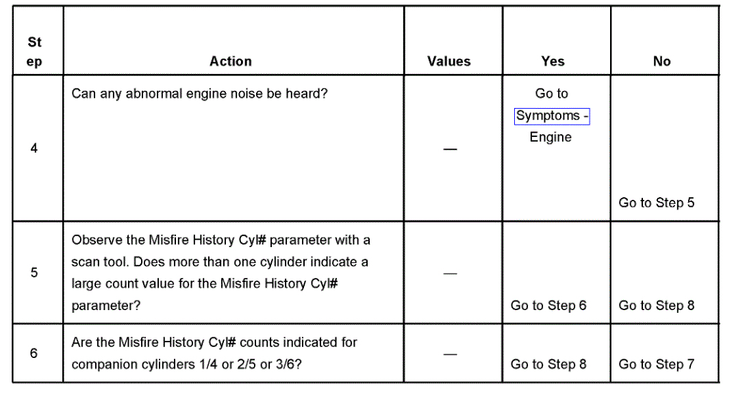

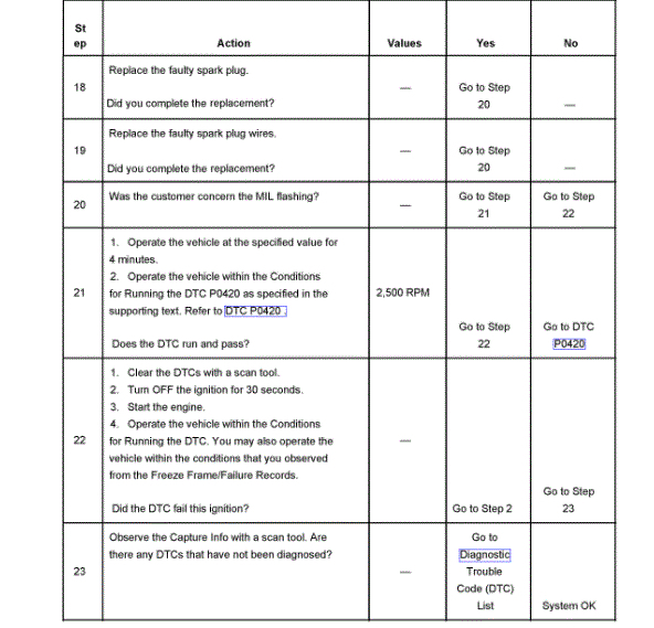

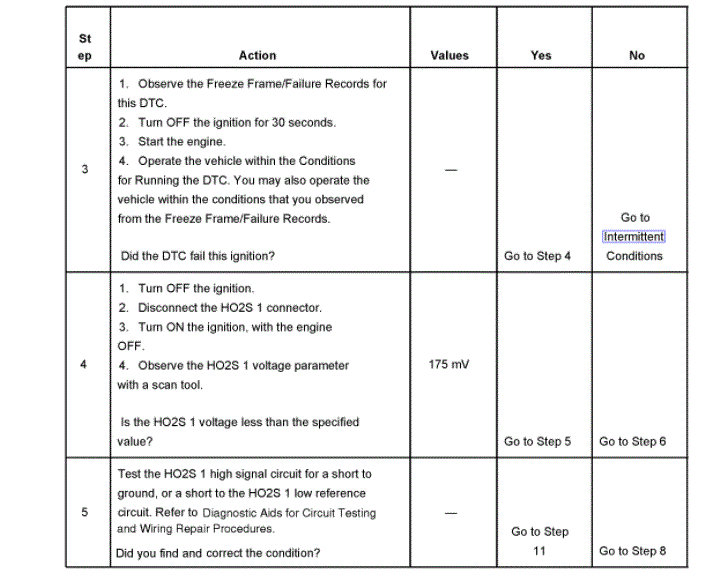

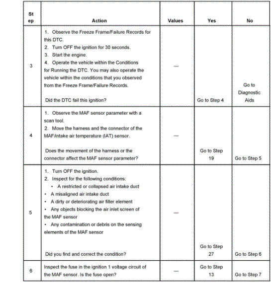

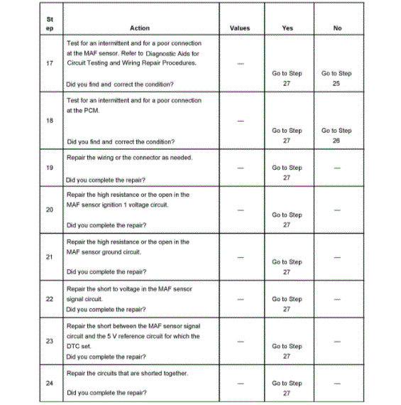

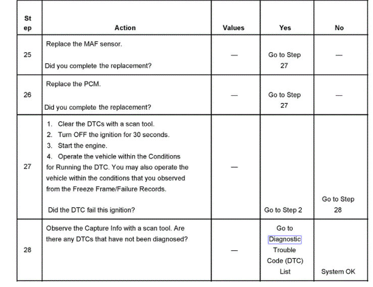

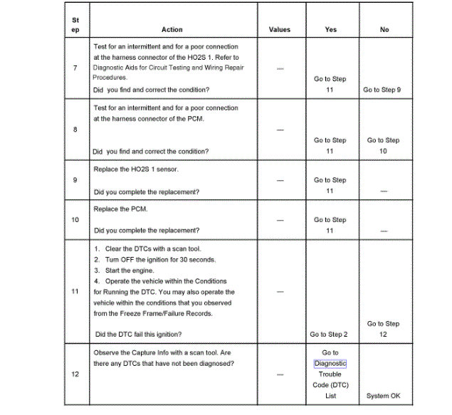

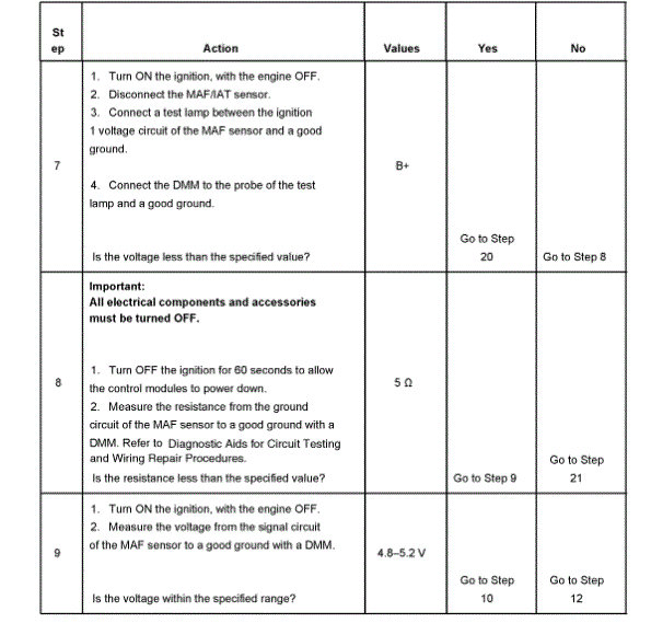

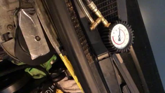

Okay, the 300 is a misfire code.
Did you check the fuel pressure? That is a common cause for this code.
What kind of EGR valve do you have? Is it a linear valve or vacuum?
131 flow chart is below for you to follow.
Let me know the results of the testing.

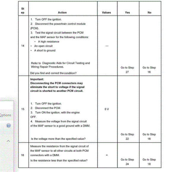

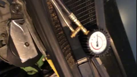

Sep 1, 2020 at 4:04 AM
XJSHEN
  • 251 POSTS
I measured fuel rail pressure on the fuel pressure test port, and image result is attached: when turn key on the ignition without turn on engine indicated about 40 PSI, and when turned key on start engine at idle was more than 55 PSI, and then decreased to 50 psi and reached to 48 PSI. after stopped engine pressure decreased to 0 PSI. What is standard fuel line pressure on the vehicle listed above? And RPM increased 2,000 rpm's to 3,000 rpm's and down to 1,500 rpm's. I do not know standard fuel line PSI. If the EGR system is not able to recycle the engine gasses right, that caused too much gas injected to engine and cause multiple misfire and created P0300? If ERG valve works normal can decrease the RPM?
I replaced throttle body sensor, idle control valve, but did not replaced ERG valve. I want to clean ERG valve first and test run, if not work buy new one.

I have not check vacuum leak yet, since there was no vacuum related codes (P0442, P0446, P0455). But I do not know how this connect to create p0131code and O2 sensor bank 1 low voltage?
Sep 3, 2020 at 4:27 PM
The fuel spec is 52-59 with the engine running.
The fact it drops to 48 pounds tells me the fuel pump is the issue with misfire code.
https://www.2carpros.com/articles/how-to-replace-an-electric-fuel-pump
The 131 code may be related to the low fuel pressure. It could not adjust the fuel mapping so it coded for it.
https://www.2carpros.com/articles/how-emission-control-systems-work
https://www.2carpros.com/articles/evap-system-code-repair
Sep 3, 2020 at 4:36 PM
XJSHEN
  • 251 POSTS
Correction: After bleed air the pressure decreased zero, but not when stopped to zero, and bleed line did not got gas, gauge adapt line got gas when released adaptor from pressure test port.
Sep 3, 2020 at 4:43 PM
What is the pressure with the engine running?
Sep 3, 2020 at 5:01 PM
XJSHEN
  • 251 POSTS
I tested again for fuel line pressure: when turned key on ignition without start was 45 psi; turned on to ignition and start engine, was between 58-59 psi about 10 seconds, then decreased to 55-54 psi, and became 53 psi, and then kept on 52 psi on idle state without running, and the rpm was 1,500 rpm's, and decreased 1,950 to 1,000 rpm's, then decreased to 500-650 rpm's. So, fuel pressure looks normal. Engine vibration is decreased but still vibrates but didn’t get engine service soon light.
Sep 3, 2020 at 8:16 PM
What is the pressure at idle with the engine running? You did not state that pressure, just with the engine off.
Sep 4, 2020 at 3:51 AM
XJSHEN
  • 251 POSTS
Idle state fuel line pressure was 52 psi. There was change engine oil light turned on while there was 19% oil life still remained before. I changed oil, and I started engine and road test. And got code p0300 and p0101. I replaced MAF sensor, after erase DTCs and just slowly running around 30 mph, and p0300 and p0101 both gone, but caused p0102 (FSC/Current) (MAF sensor circuit low frequency). After erase code p0102 the idle rpm increased from 1,500 rpm's to 2,000 rpm's at idle. when change gear to R or D, RPM decreased to 1, 400 to 1,500 rpm's. I erased code, and run again and caused p0102 code. Now P0300 and p0131 was cleared. The tow code was cleared by replace MAF sensor. but how p0101 changed to p0102? Thanks for your review and instruction!
Sep 4, 2020 at 11:21 AM
Okay, first, why are you erasing codes? That does nothing at all.

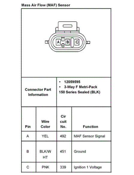

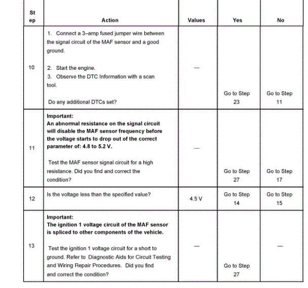

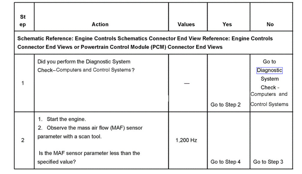

Check the hose from the mass air flow to the throttle body and make sure it does not have any rips or tears.
https://www.2carpros.com/articles/how-to-replace-a-mass-air-flow-sensor-maf
I attached the flow chart for you as well. Let me know what you find.
I also attached the connector diagram for you as well. Verify voltages to the connector.
The connector is a common failure.
The other codes will most likely return as clearing will not work until diagnostics and repairs are made.
CIRCUIT DESCRIPTION
The mass air flow (MAF) sensor is an air flow meter that measures the amount of air entering the engine. The power-train control module (PCM) uses the MAF sensor signal to provide the correct fuel delivery for all engine speeds and loads. A small quantity of air entering the engine indicates a deceleration or idle condition. A large quantity of air entering the engine indicates an acceleration or high load condition. The MAF sensor has the following circuits:
An ignition 1 voltage circuit
A ground circuit
A signal circuit
The PCM applies a voltage to the sensor on the signal circuit. The sensor uses the voltage to produce a frequency based on the inlet air flow through the sensor bore. The frequency varies within a range of near 2,000 Hertz at idle to near 10,000 Hertz at maximum engine load. If the PCM detects the frequency signal is less than the possible range of a correctly operating MAF sensor DTC P0102 sets.
CONDITIONS FOR RUNNING THE DTC
The engine is running.
The ignition 1 signal is more than 8 volts.
The idle air control (IAC) position is more than 2 counts.
The above conditions are met for more than 0.5 second.
CONDITIONS FOR SETTING THE DTC
The PCM detects that the MAF sensor frequency signal is less than 1,200 Hz.
ACTION TAKEN WHEN THE DTC SETS
The control module illuminates the malfunction indicator lamp (MIL) on the second consecutive ignition cycle that the diagnostic runs and fails.
The control module records the operating conditions at the time the diagnostic fails. The first time the diagnostic fails, the control module stores this information in the Failure Records. If the diagnostic reports a failure on the second consecutive ignition cycle, the control module records the operating conditions at the time of the failure. The control module writes the operating conditions to the Freeze Frame and updates the Failure Records.
CONDITIONS FOR CLEARING THE MIL/DTC
The control module turns OFF the malfunction indicator lamp (MIL) after 3 consecutive ignition cycles that the diagnostic runs and does not fail.
A current DTC, Last Test Failed, clears when the diagnostic runs and passes.
A history DTC clears after 40 consecutive warm-up cycles, if no failures are reported by this or any other emission related diagnostic.
Clear the MIL and the DTC with a scan tool.
DIAGNOSTIC AIDS
Inspect the harness of the MAF sensor to verify that it is not routed too close to the following components:
The secondary ignition wires or coils
Any solenoids
Any relays
Any motors
Inspect for any contamination or debris on the sensing elements of the MAF sensor.
A wide-open throttle acceleration from a stop should cause the MAF sensor parameter on the scan tool to increase rapidly. This increase should be from 7-12 g/s at idle to 150 g/s or more at the time of the 1-2 shift. If the increase is not observed, inspect for a restriction in the induction system or the exhaust system.
A high resistance of 15 ohms or more on the ground circuit of the MAF sensor may cause this DTC to set. A high resistance may cause a driveability concern before this DTC sets.
A high resistance of 15 ohms or more on the ignition 1 voltage circuit may cause this DTC to set. A high resistance may cause a driveability concern before this DTC sets.
If the condition is intermittent, refer to Intermittent Conditions. See: Computers and Control Systems > Initial Inspection and Diagnostic Overview > Intermittent Conditions

After replacement of MAF sensor, p0102 was gone, but p0300 and p0131 came back when I do road test about 10 minutes. I collected OBD Monitor Test results with Innova 3040LAT+.
But I could not explain the results. Anyway EGR valvev, EVPD leak, O2 sensor problems pop out:
- Oxygen sensor monitors and constants $05
- Oxygen sensor heater system time to activity monitor $06
- Exhaust gas recirculation system monitor $07
- Enhanced evaporative system monitor #2 (020” leak) EVPD $0A
- Catalyst efficiency monitor $0C
- O2 sensor heater system current feedback monitor $0E

Those are just your monitors that are not set from you clearing codes all the time.
