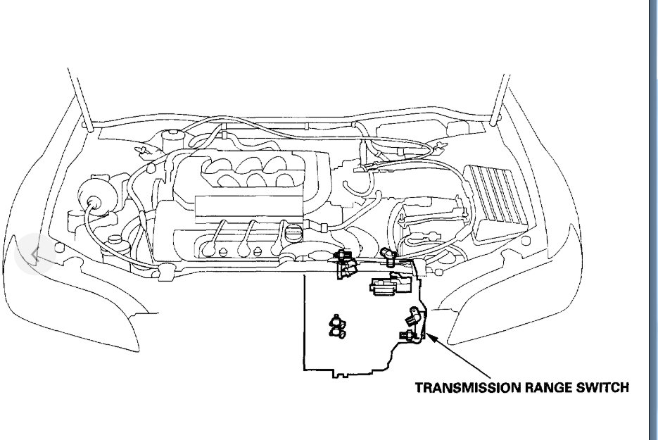

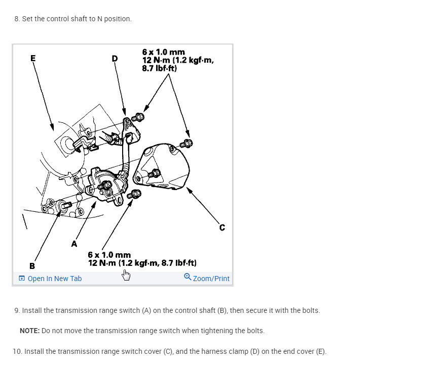

you will need to check the neutral safety switch it's mounted on the transmission where your manual shifting the transmission at the end of the shift cable. You may have pulled the wiring connector loose or might need to try and realign it. if that doesn't work you may have to replace it so it will start in neutral and park.

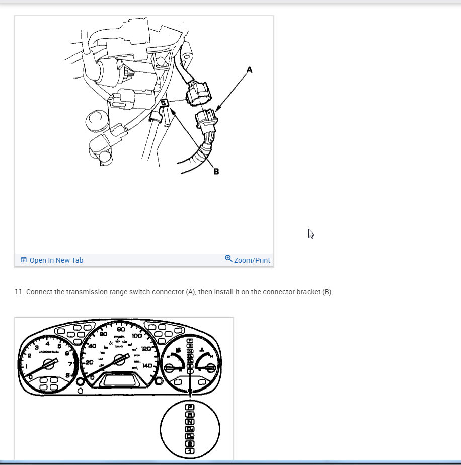

As it turns out a couple things of concern... first either my memory or the memory of the gentleman who was helping me get started reveals a bit of a lapse - critical albeit... lol... one of us dion nectar two electrical plugs on driver's side of dash (behind a pear shaped panel wherein electrical on nectar and fuses are located). Once I made that discovery and performed the subsequent reconnecting of said cables all was right with the Honda world... dash indicators worked, car started and ran!

This issue is caused by what is called the transmission range sensor. Basically it tells the PCM that the vehicle is in park or neutral and is okay to start. When this is not hooked up or not giving a good signal then the car will not start and the P and N will not light up.
I would suggest you go back and double check your work to make sure this is not unhooked. If it is not then we need replace it and then retest the issue.
