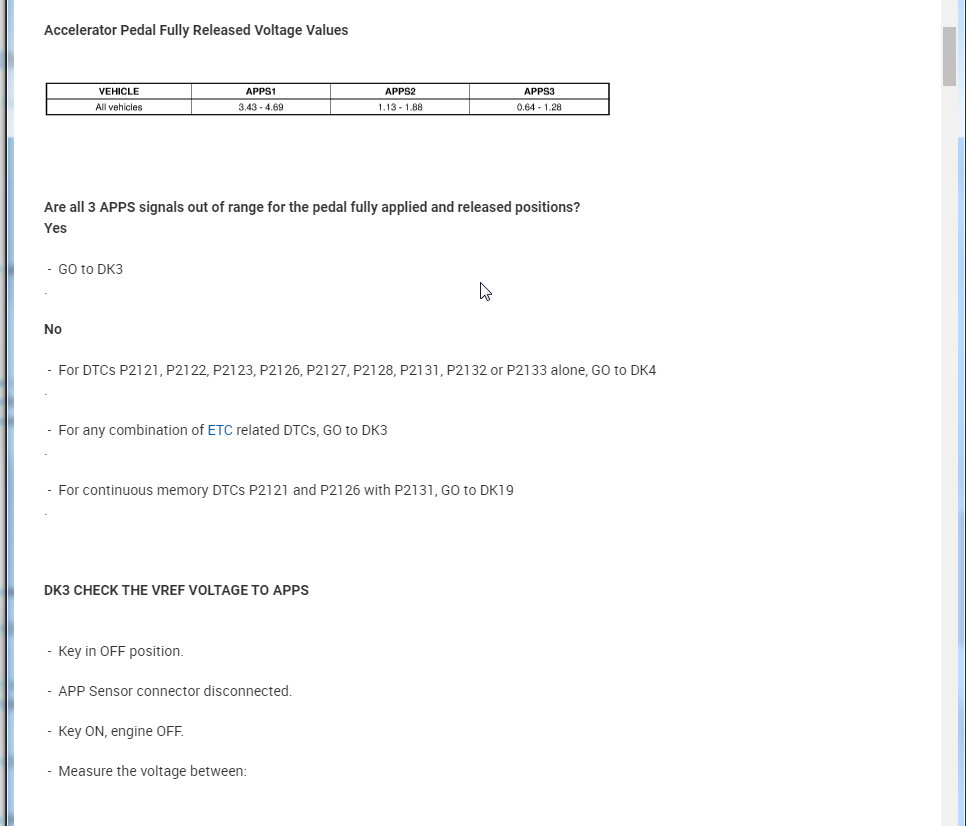

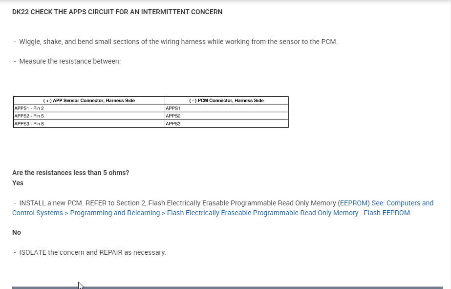

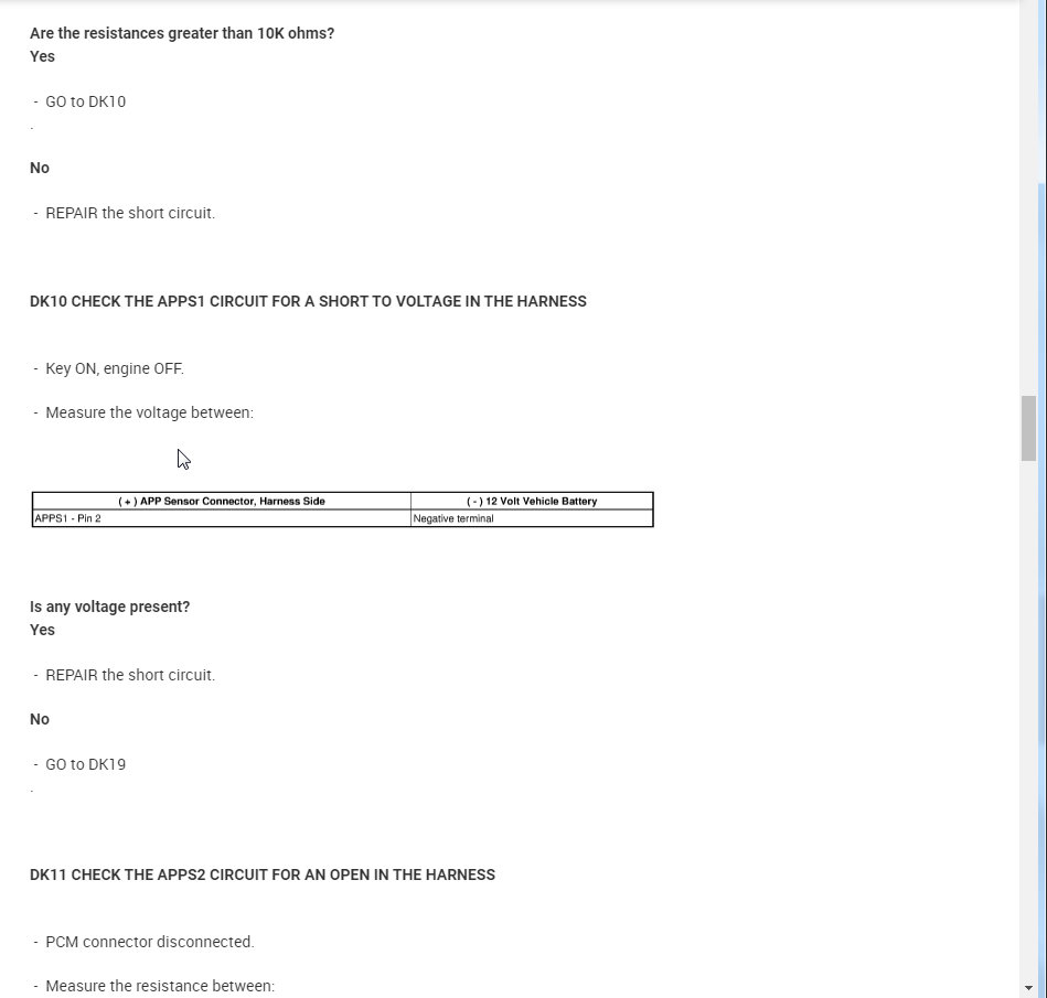

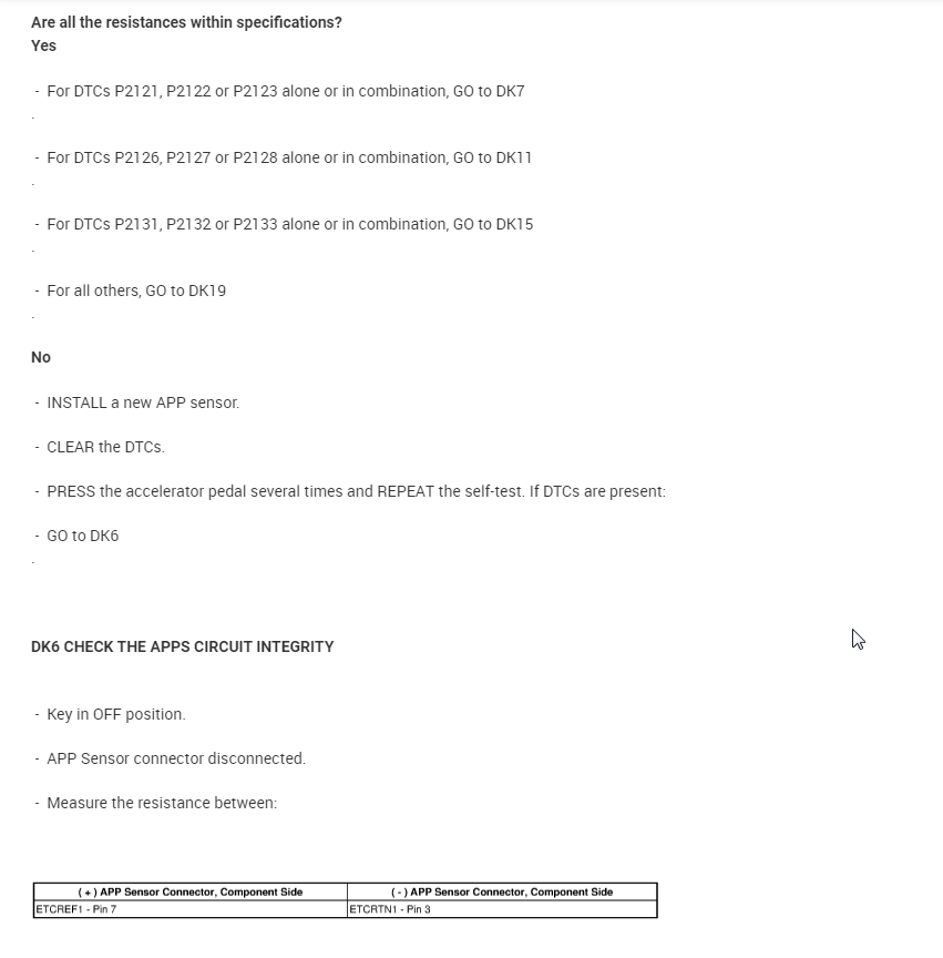

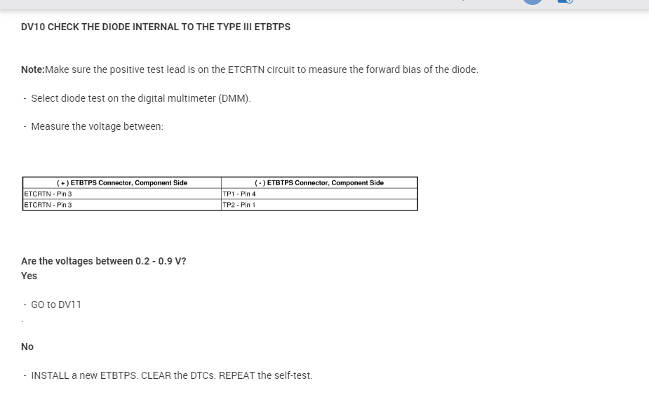

The car was drove home 2 days ago, parked and central lock with remote. i noticed the inner light stay on, so i removed the terminal head. few minutes later i realized i left something inside the car. now i need to connect the battery before i can get the door open. i did this more than 2 times that night. The next day, the car start but not revving.
Here are the trouble codes: P2104:FF, P2112:FF, P2121, P2122, P2126, P2127, P2131, P2132. the fuses are okay.
Mar 27, 2020 at 7:05 AM

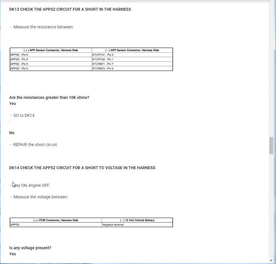

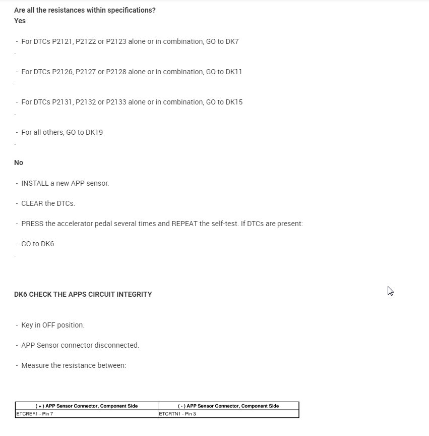

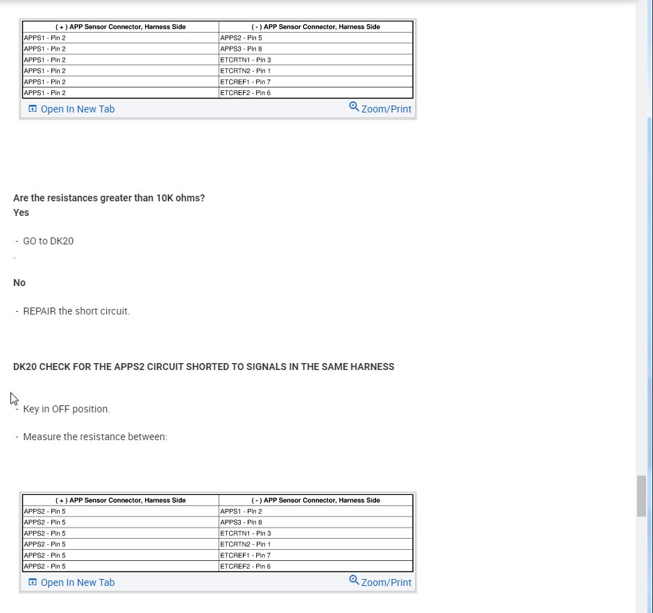

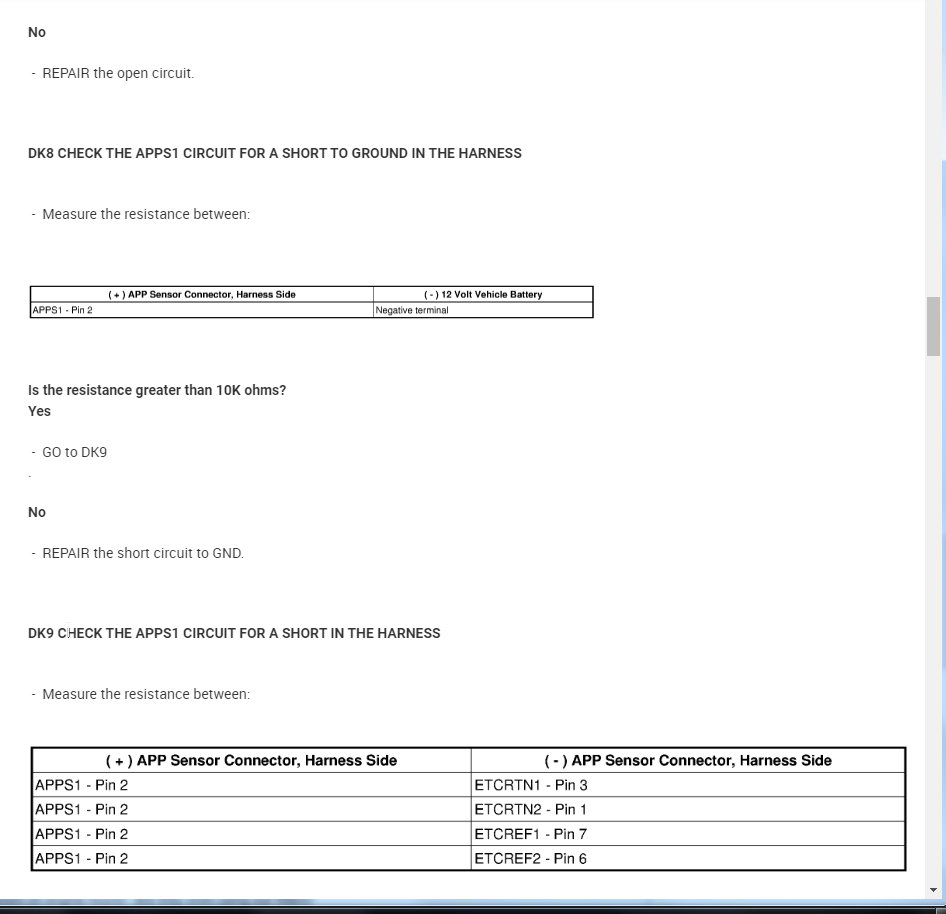

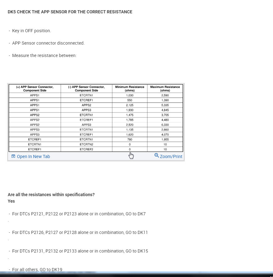

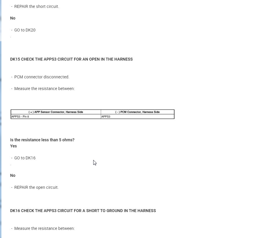

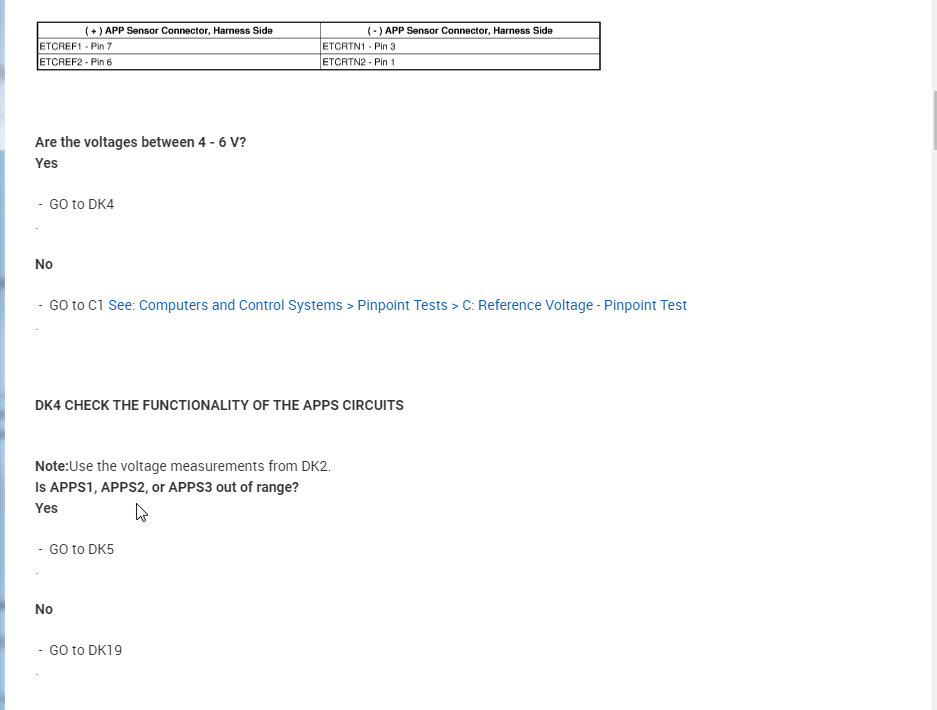

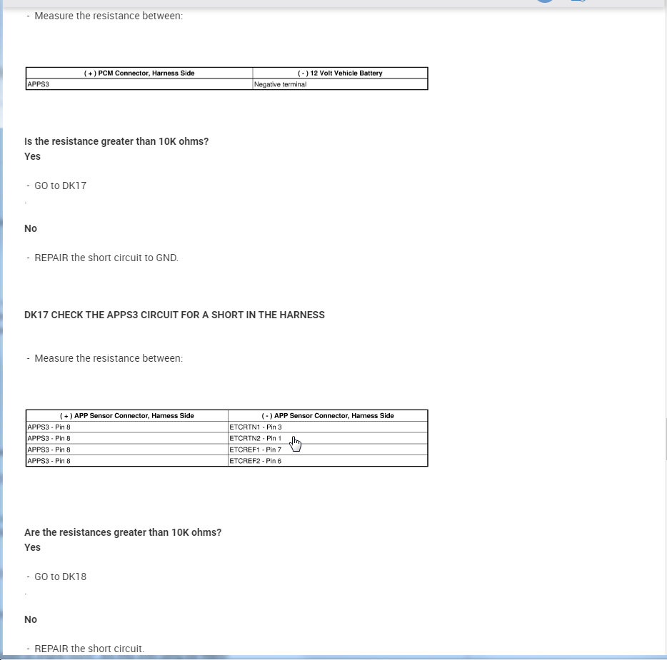

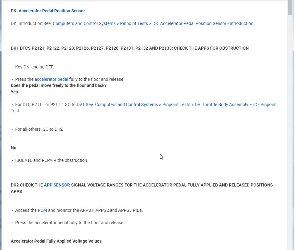

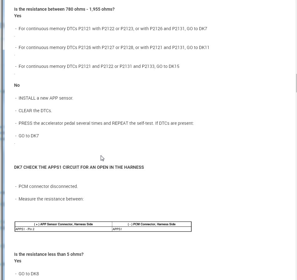

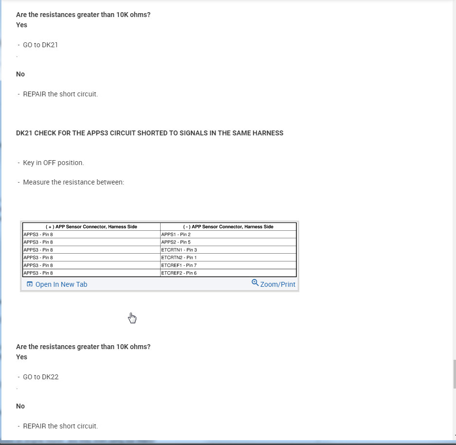

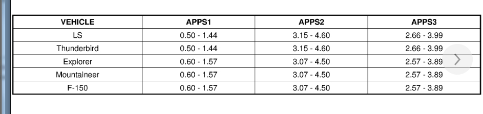

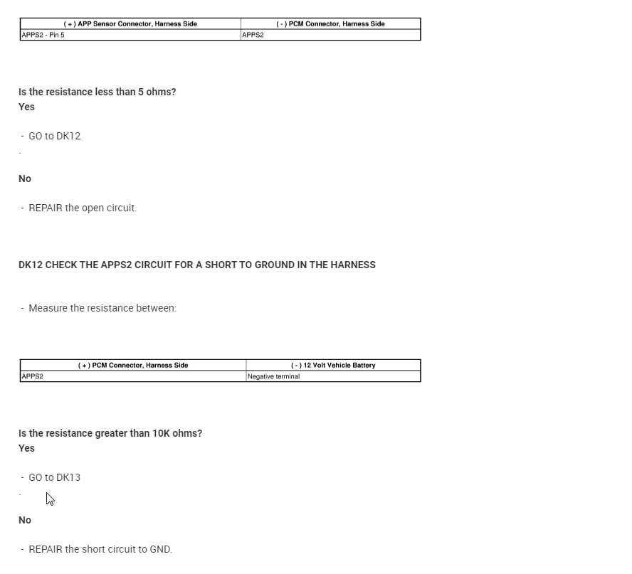

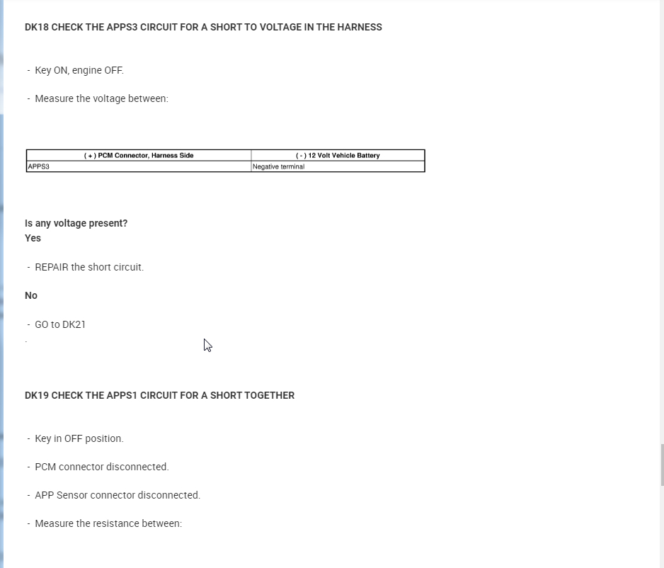

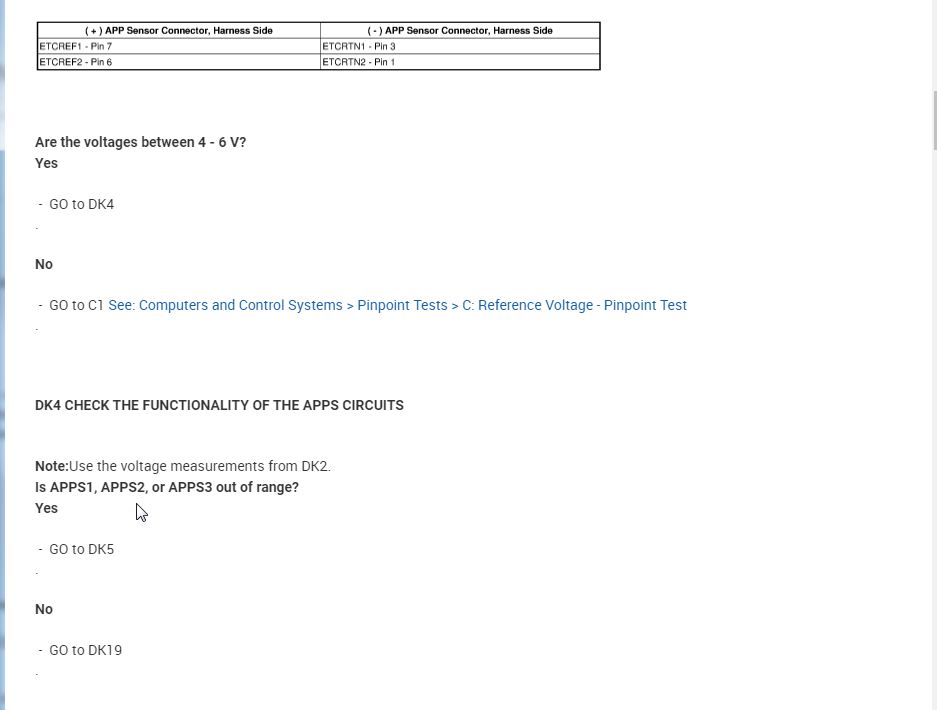

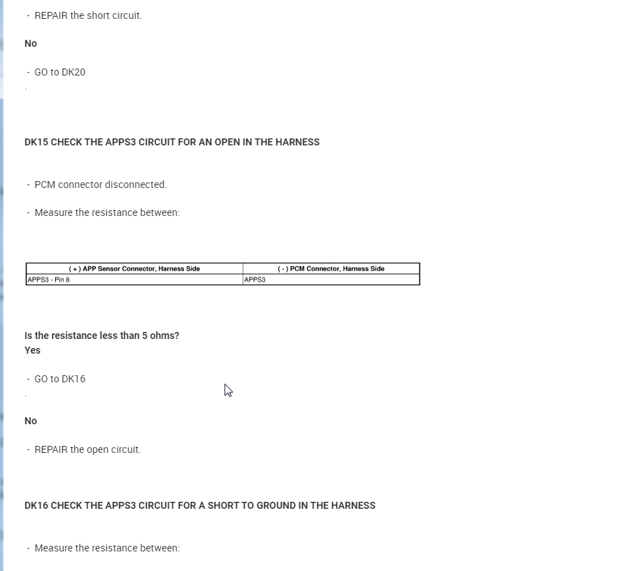

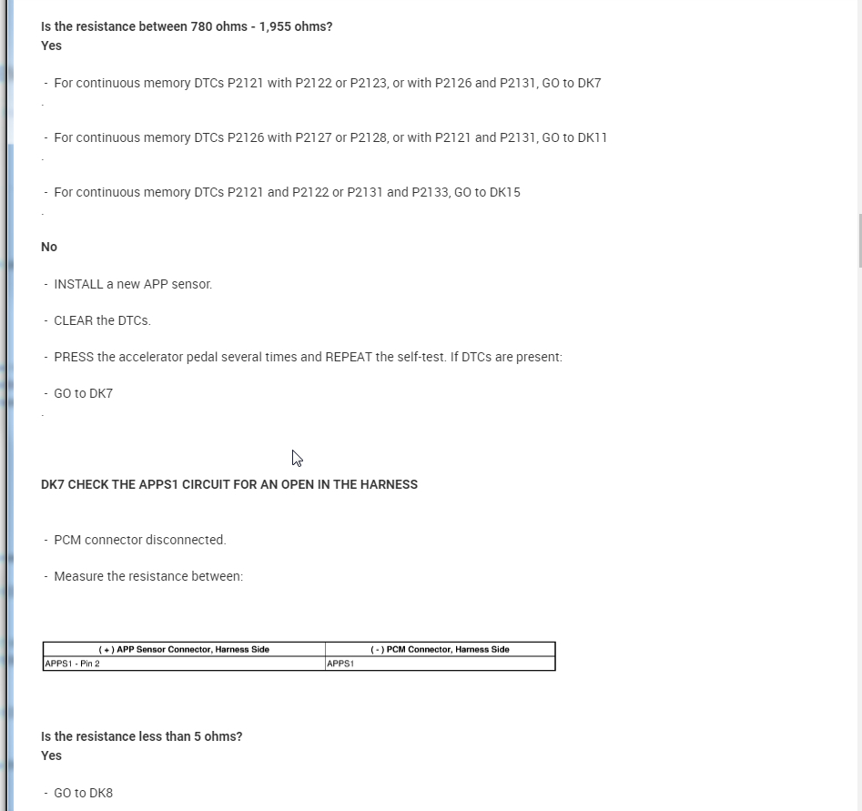

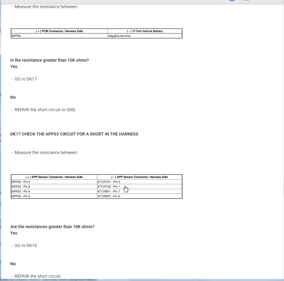

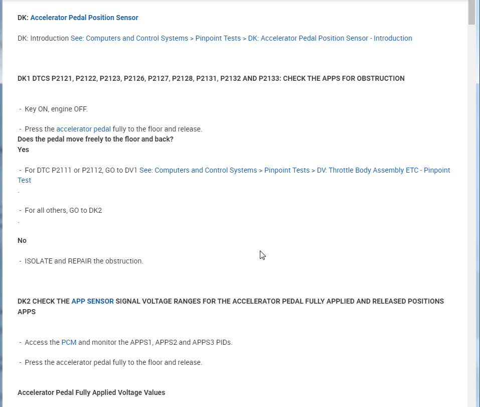

The majority of these codes are for the APP and a couple are for the TPS. If it were me, I would chase the APP codes and I suspect if those are repaired then it will fix all of them.
Let me know if you have questions but I attached the testing for the APP codes.
Let me know what you find and we can go from there. Thanks

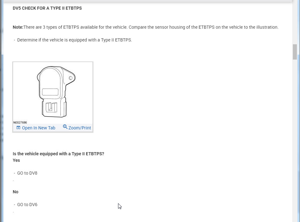

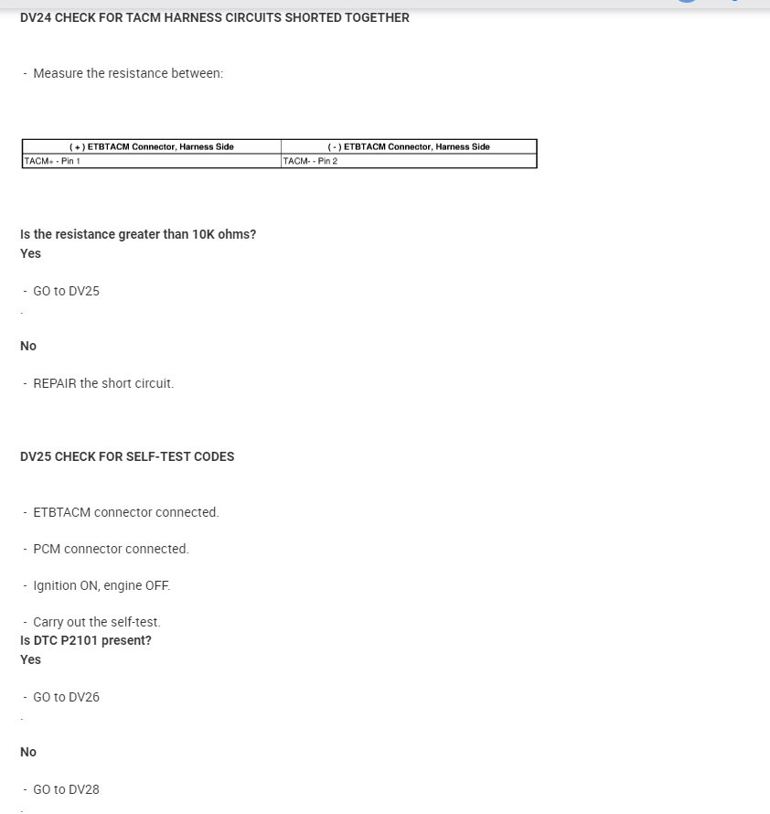

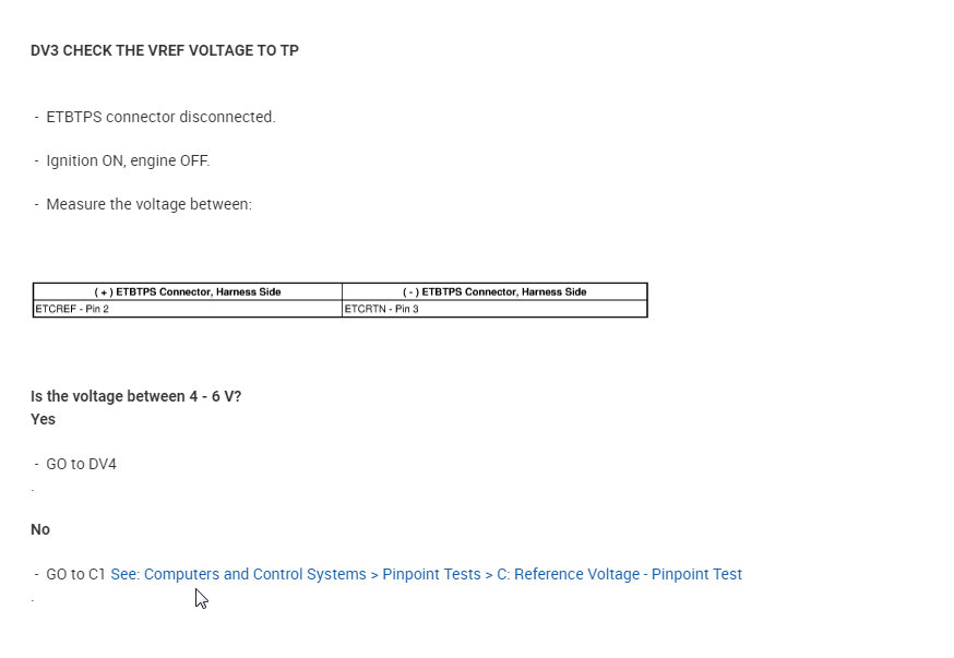

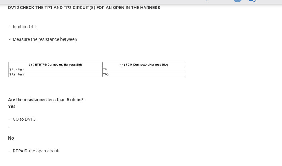

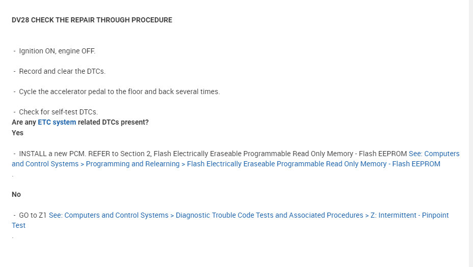

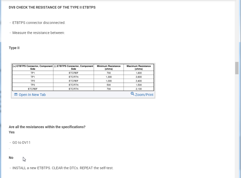

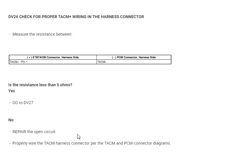

i continue the diagnosing today and i'm having 2 fault code left, which is P2104 AND P2112.
Mar 28, 2020 at 1:20 PM

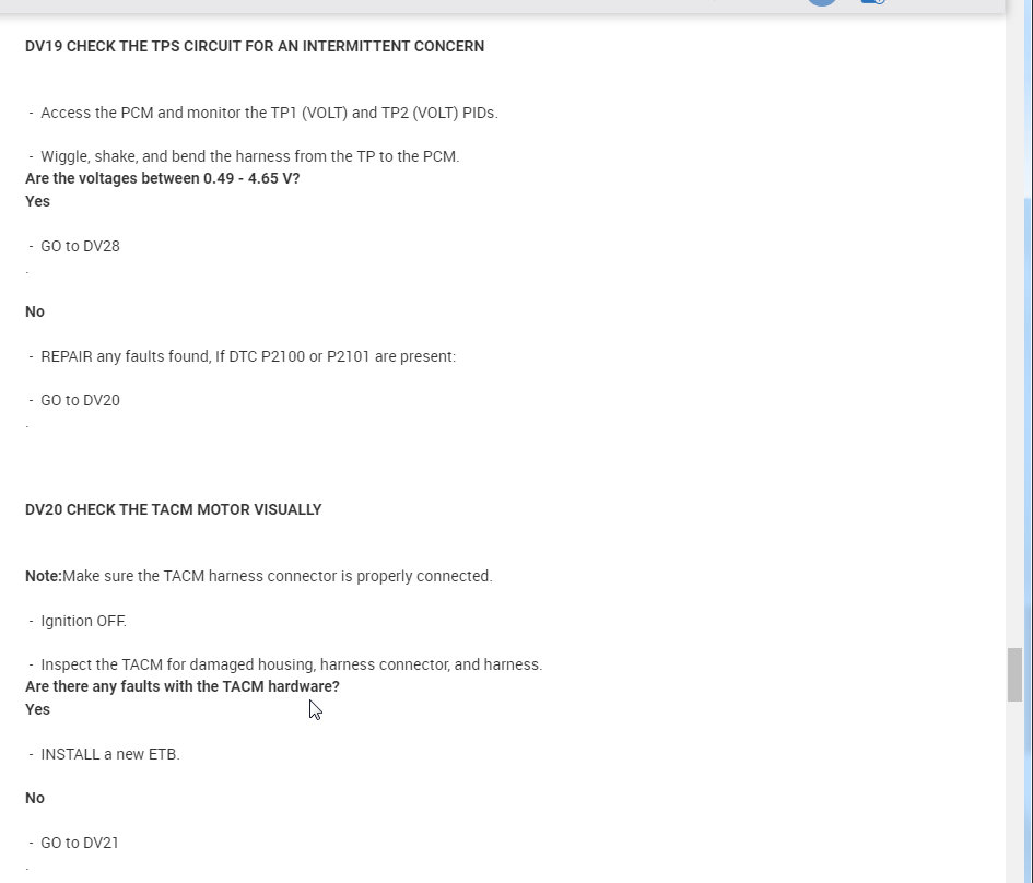

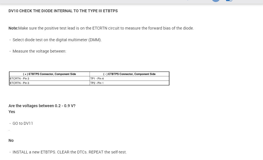

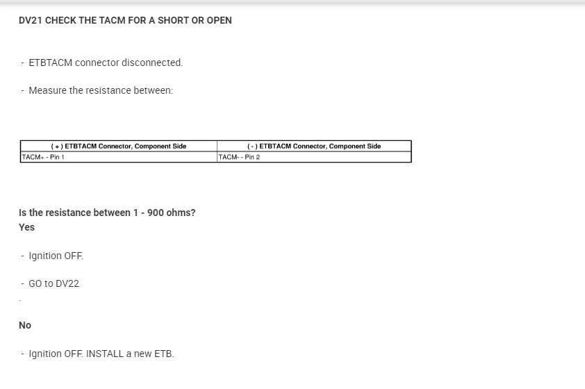

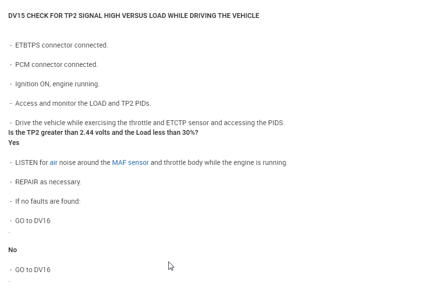

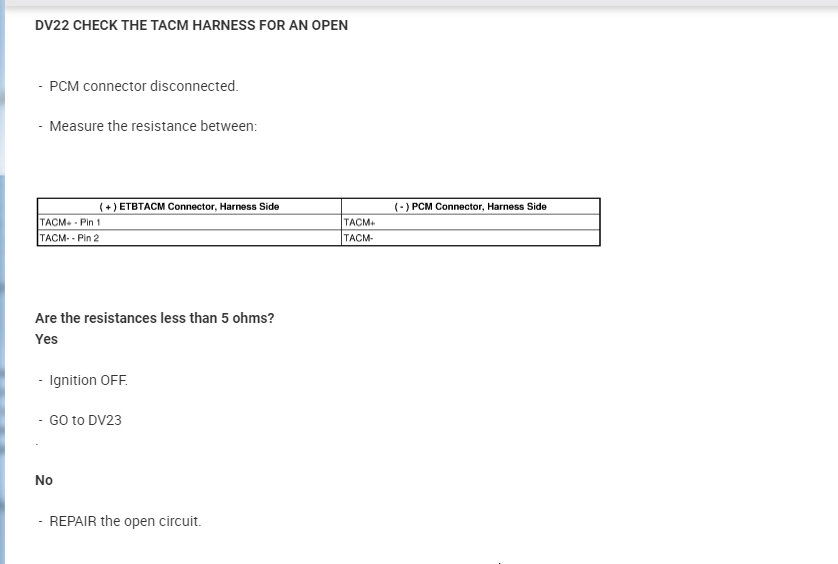

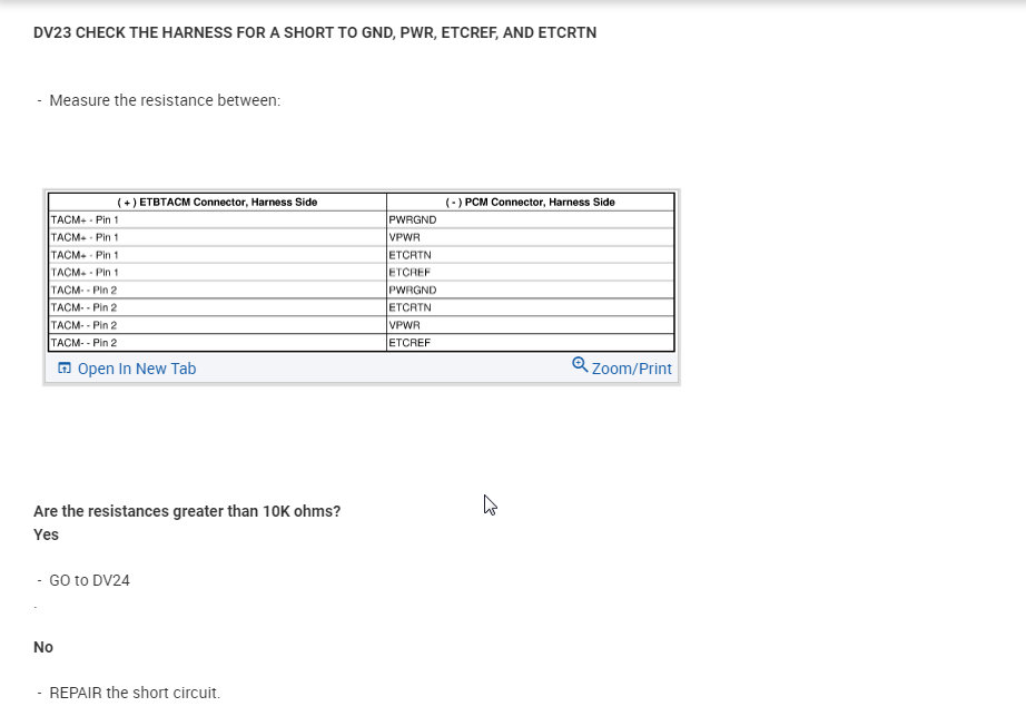

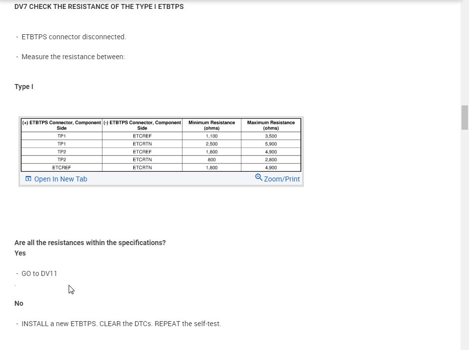

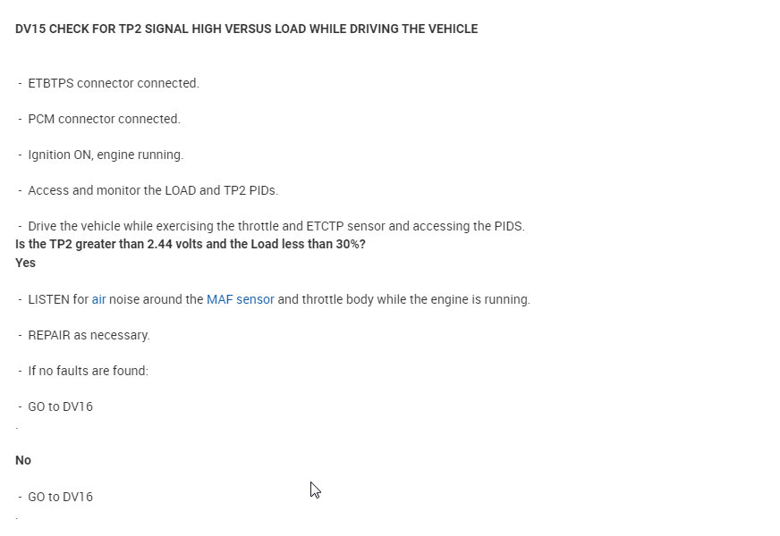

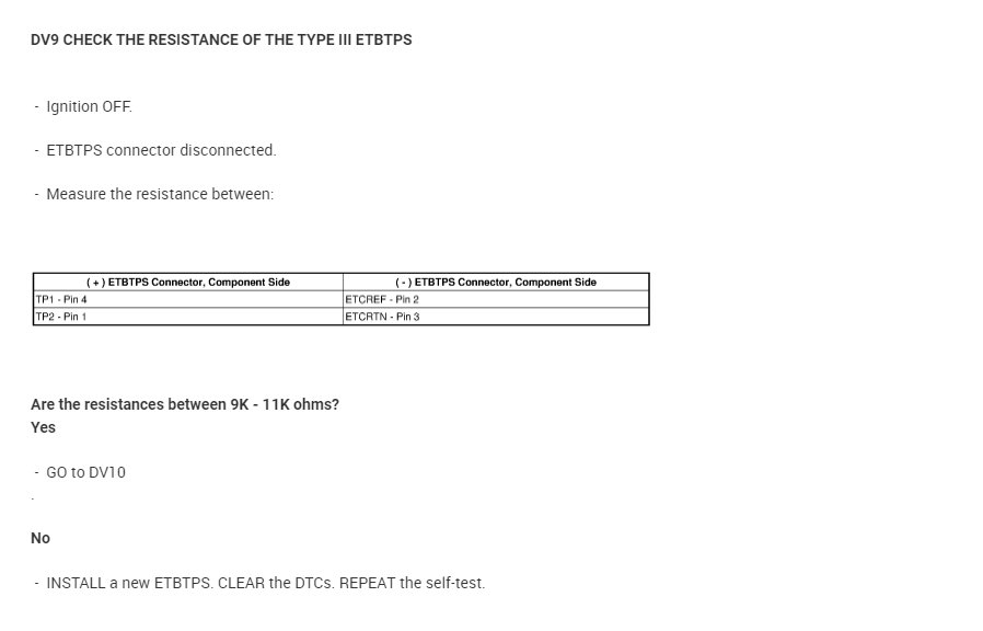

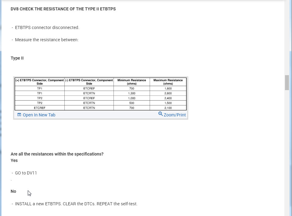

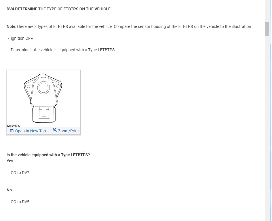

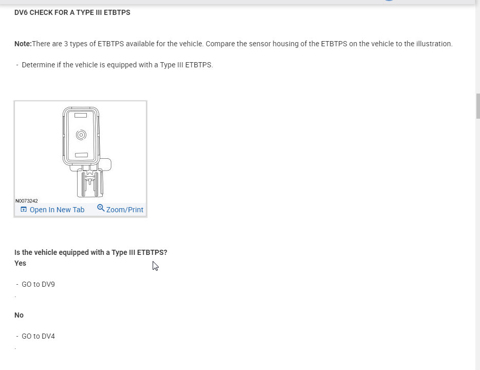

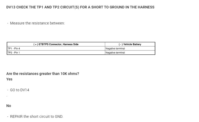

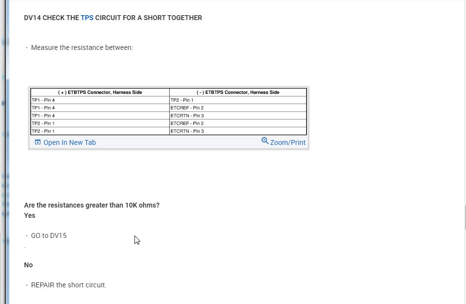

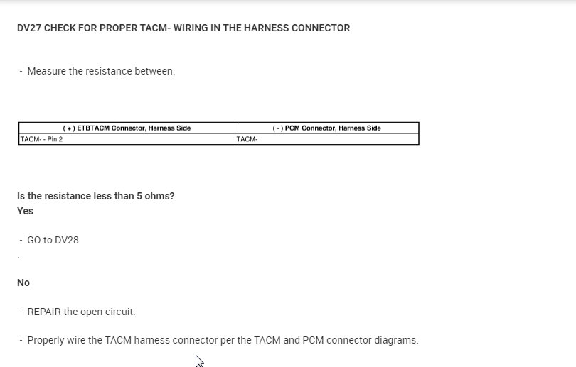

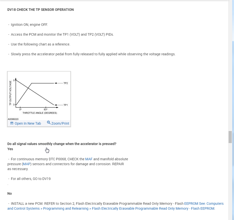

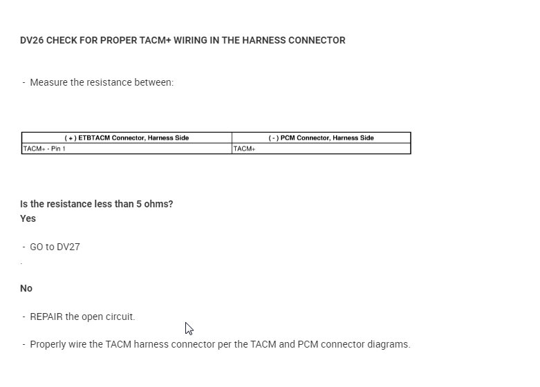

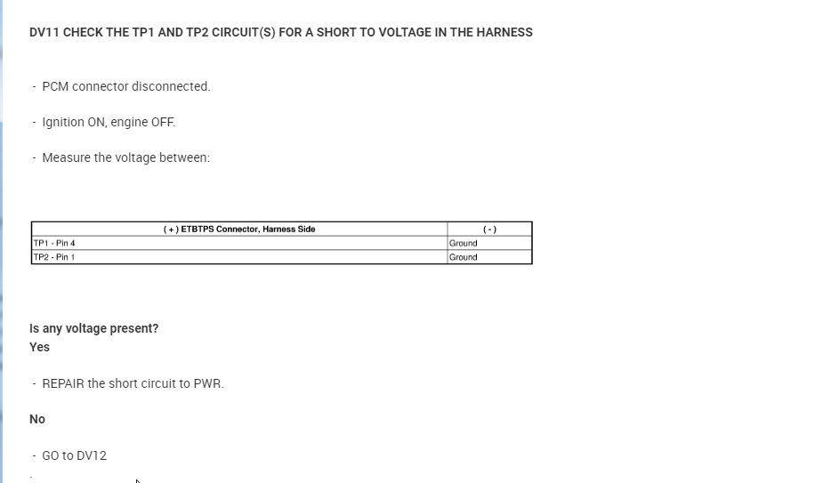

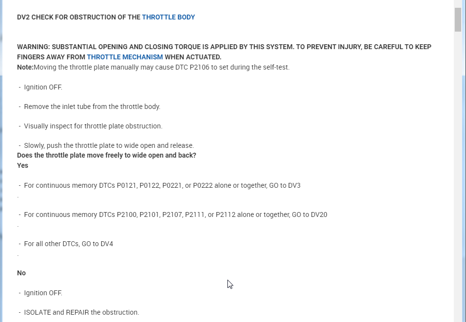

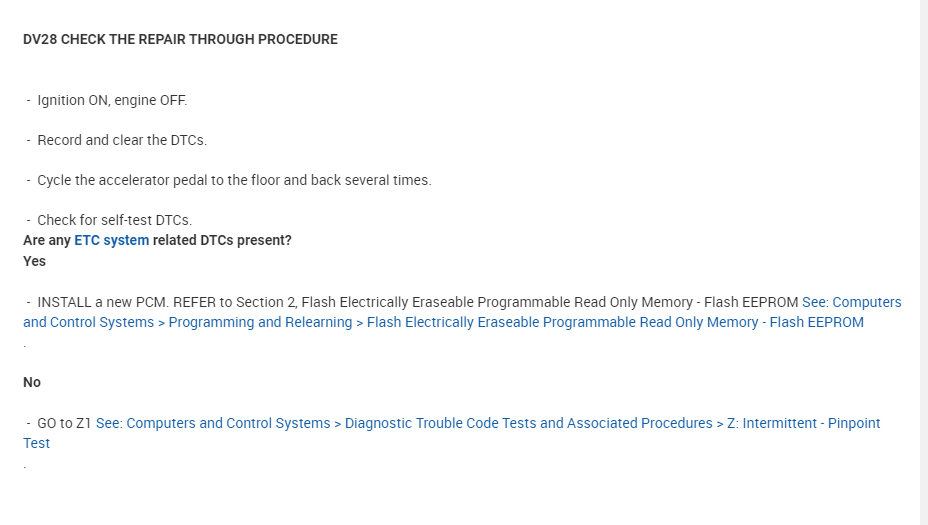

Okay. That is good news. I would have thought they were all related but these two codes I am sure are related.

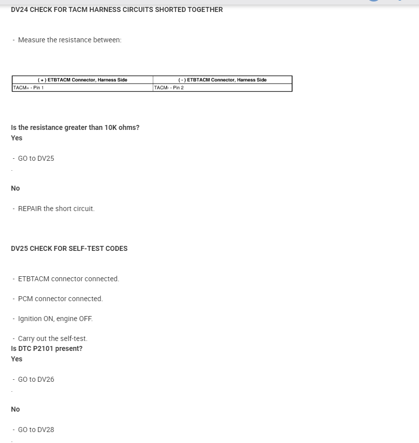

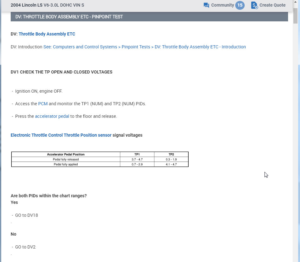

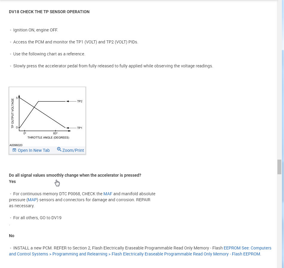

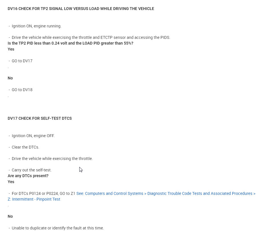

P2104 - Electronic Throttle Control ETC
P2112 - Throttle Body Assembly ETC
I attached the testing for the throttle body assembly. This one is pretty lengthy but is not to difficult to run through.
Let me know if you have questions and we can go from there. Thanks
