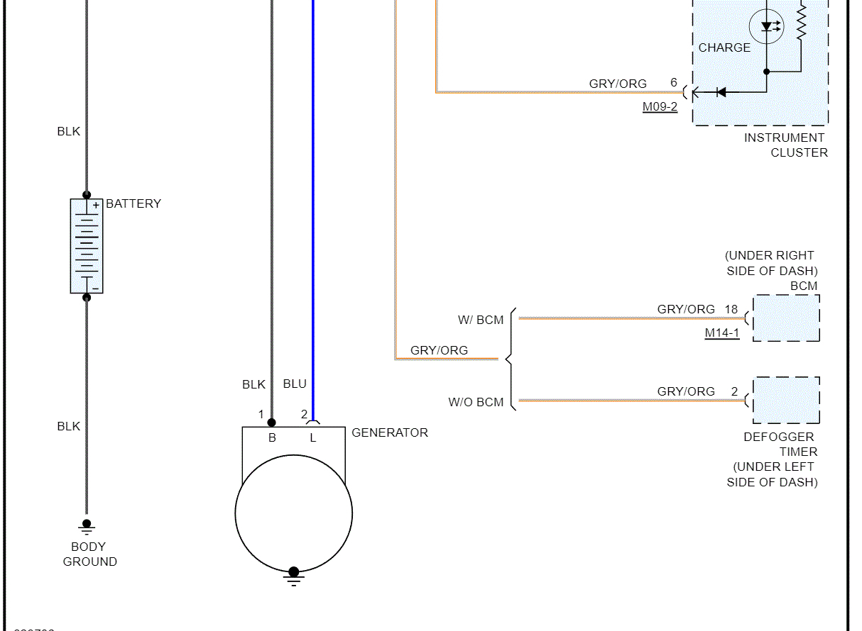

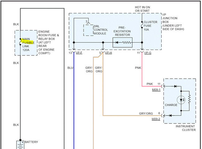

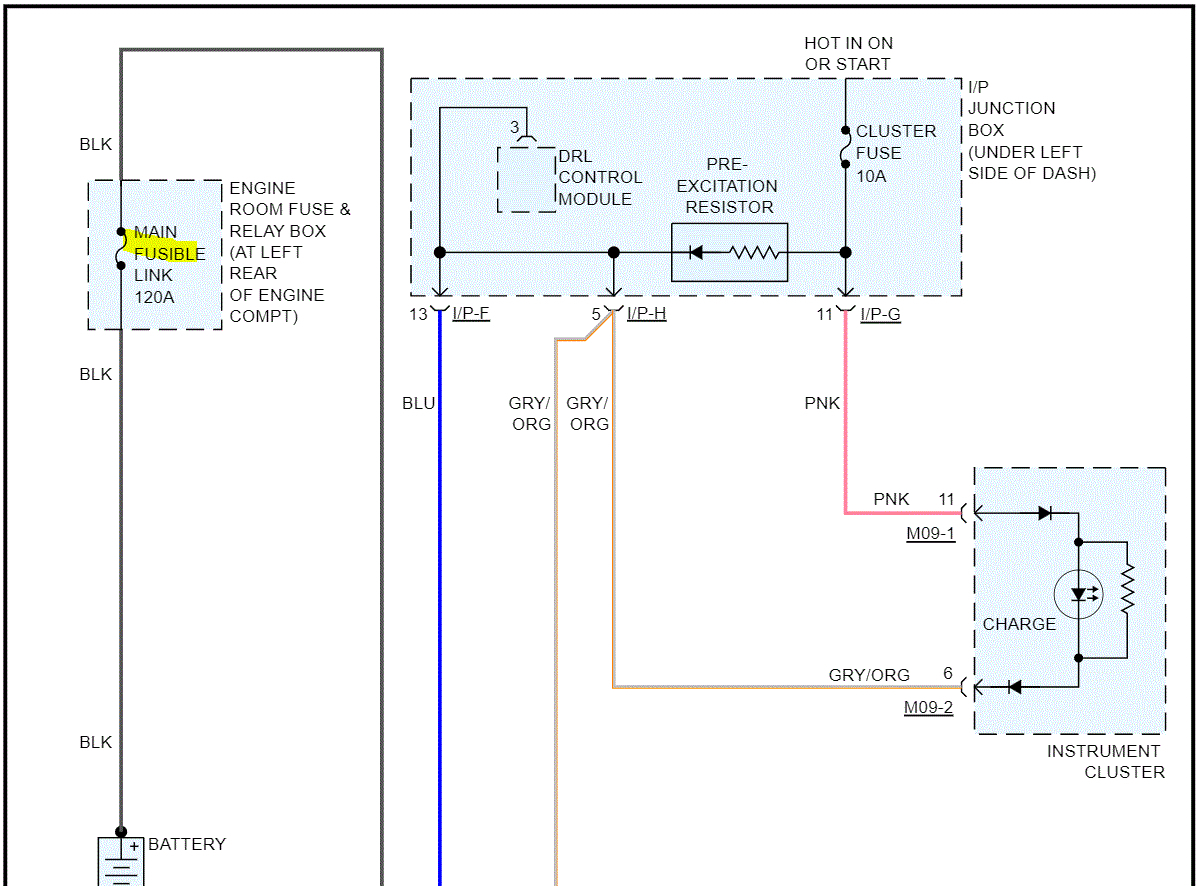

First, I attached the wiring schematic below of the charging system. If I understand, you replaced the 120-amp fusible link from which the alternator receives power. Do you have power at the black wire on the alternator?
If you do, (and I believe you indicate you do), the alternator may have an intermittent fault. Basically, it works sometimes and not others.
So, here is what I need you to do. When the light is on, I need you to check the voltage at the battery. With the engine running, you should see approximately 14v. We need to confirm it is or isn't charging when the light turns on. Here is a link you may find helpful:

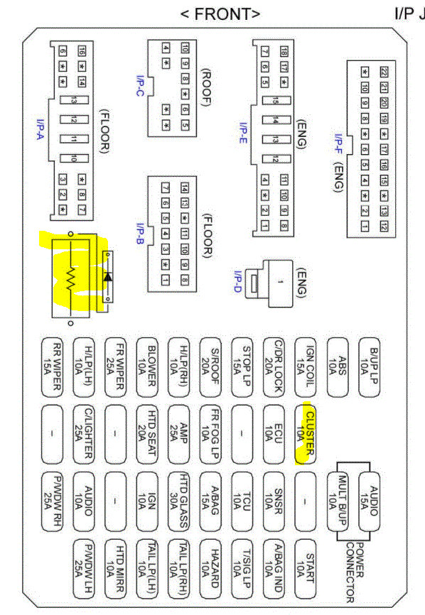

There is a chance the pre-excitation resister was damaged. Also, confirm fuse 10 in the fuse box in the vehicle is good and has power. The alternator won't begin charging unless it receives "excitation" voltage to set up the initial magnetism in the alternator's rotor.
Let me know what you find. Also, pic three shows the fuse to check in the fuse box. Also, the other thing I highlighted I believe is the pre-excitation resister. Make sure it is in good condition and has no evidence of damage.
