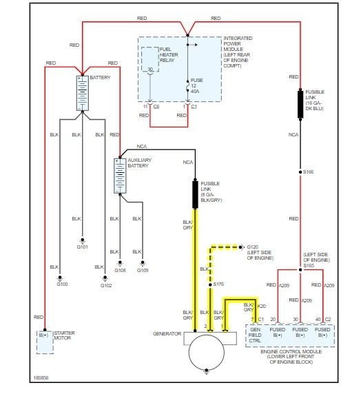

Blew the computer. Truck would not start and the gauges didn’t work. So I sent it out and had it repaired. They said the 12 volt circuit was toast. Hooked up the fixed computer and the truck runs but now does not charge. Replace the alternator and still nothing. Have around 11.4 volts at the batteries and at the back of the alternator. The 2 small wires going to the alternator I checked with the truck running and the truck off and both are a ground. The wires are black and maybe grey. Hard to see. This truck only has the computer on the driver side engine block.

First, the battery is almost dead. 11.4 will not allow much to work. You need to have 12.6 volts to the battery. I would start by charging it up.
https://www.2carpros.com/articles/how-to-charge-your-car-battery
As far as the alternator, it sounds like there is still an issue with the ECM.
