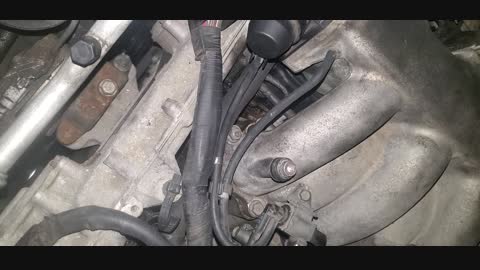

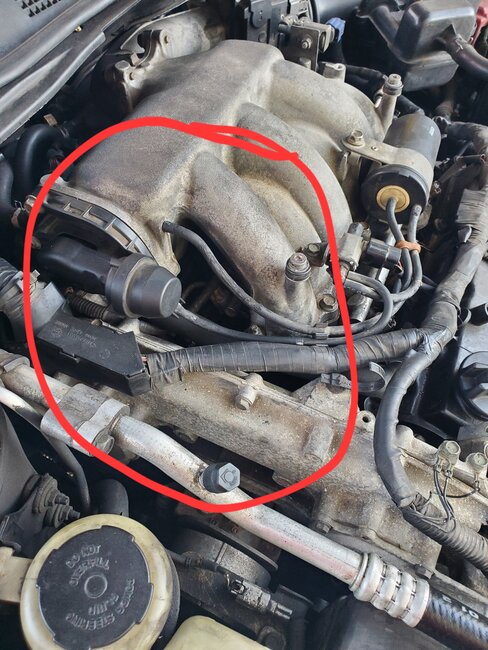

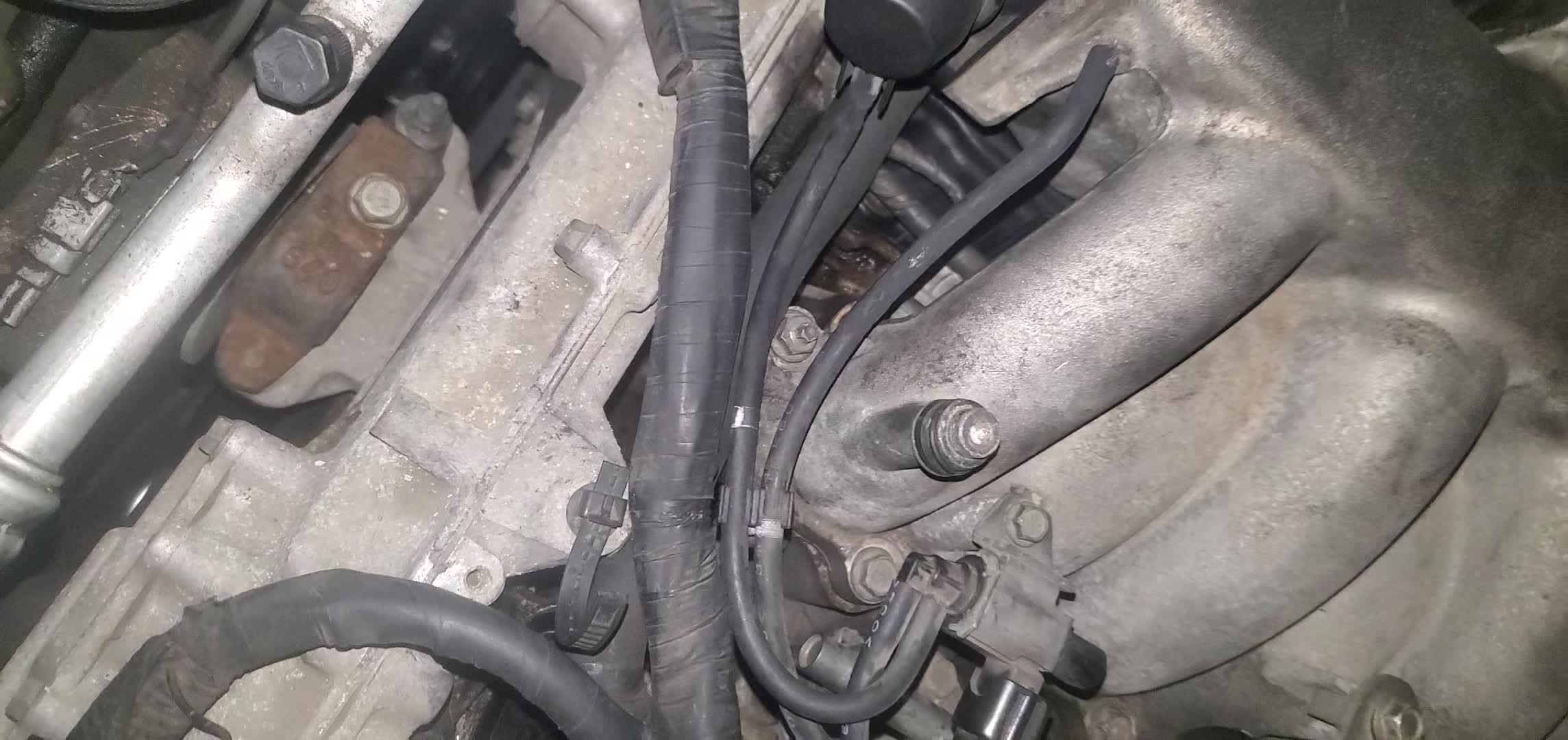

My car just started to make a high pitch coming from the back of the engine like underneath the intake manifold. I just want to see if anyone might have an idea as to what it might be? There's no other issue i.e. loss of power, etc... i can tell that could help me guess to what it is.

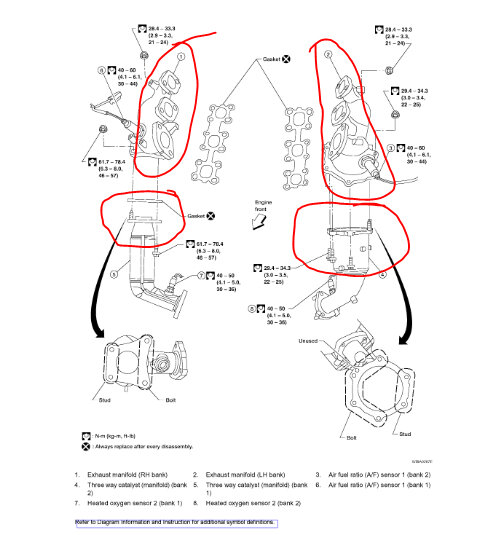

Do me a favor. First, check to see if it is louder under the vehicle. If it is, check near the exhaust manifolds and where the catalytic converters attach to see if the noise could be coming from one of those areas. See pic below.
Also, if that is a top end noise, make sure the engine oil is clean and full.

Since you have a catalyst code, I feel it is most likely a leak or the converter itself may be plugged.
At this point, I would allow the engine to cool off and then check to see if there is any evidence of a leak at the exhaust connections. Often times you will see black marks near the leak indicating a problem.
