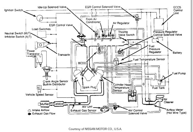

I am in need of a complete vacuum routing diagram. recently had the cylinder heads done but now that I got it back together realized all the vacuum hose were are missing, in the wrong places or just no good. I cannot seem to find a routing diagram anywhere even bought the repair manual and it was a waste of money. please help. thank you for your time.

Here is the engine vacuum diagram you requested, let us know if you need anything else.

Not following that diagram so well not making any since

this is all we get in manuals the double lines are the vacuum lines if you know the parts on the car you'll be able to follow it as they are listed which gets what on vacuum
