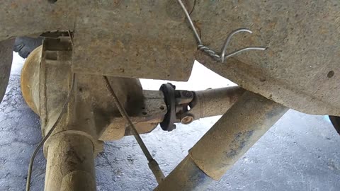

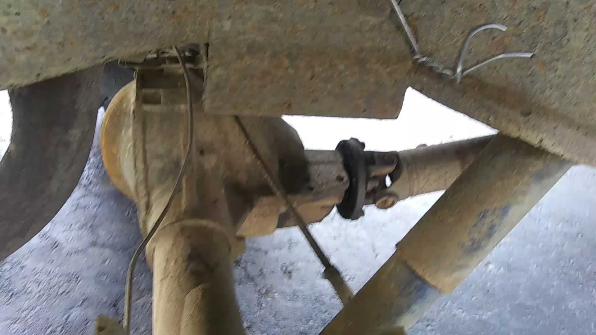

I hear a noise like something rubbing once in a while like metal. then one day it sounds like the exhaust was dragging, but when I stopped to look it wasn't the exhaust. isn't even close enough to touch anything. After I got home and backed in my driveway it had a slight jerky feeling. I can't afford a repair shop and lost my job because of it.

See if you can tell if the noise is front or back then jack the truck up and spin each wheel to see if you hear the noise here is a guide to help.
Jun 8, 2019 at 9:15 AM
BROKEDOWN1970
I was able to do a video.
Jun 13, 2019 at 1:36 AM
  • 55,851 POSTS
The differential is junk you will need a used or rebuilt unit. thanks for the video take the guessing out of it.
Jun 14, 2019 at 4:33 AM
DANNY L
  • 5,648 POSTS
Yes, the ring and pinion is destroyed.. It's possible the differential can be rebuilt/salvaged and not need an entire replacement.. Thanks again for using 2CarPros.
