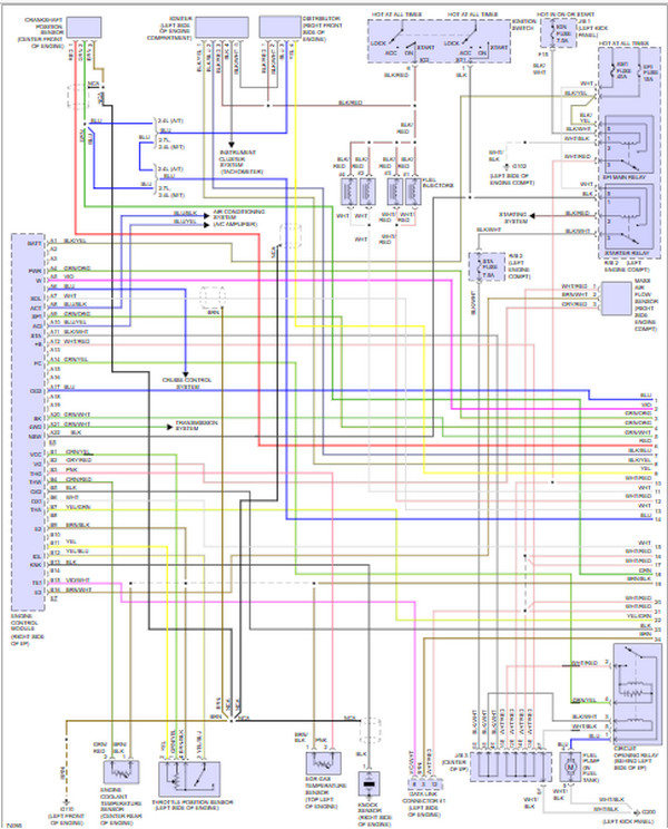

Hoping you can help me out, I can usually hear my fuel pump when i turn the key to on position and now i hear nothing , truck will crank over but wont stay running . I checked all Fuse's and EFI Relay and even switched the Tail light relay for the EFI and still checks out ok. Took the gas tank down and Fuel Pump out and gave it power and it turns on but when checking the wiring harness that goes to top of Fuel tank and Fuel Pump and No Voltage with Key in On position. Read elsewhere to check it with vehicle started but thought to ask here. This all started 2 days ago after getting Gas, the check engine light came on.

The first thing you need to understand is the pump only powers for 2 seconds and then shuts off when the key is turned on so don't expect to find power constantly. Here is the wiring diagram to track the problem down. http://i1198.photobucket.com/albums/aa448/Wrenchtech/62614214.gif http://i1198.photobucket.com/albums/aa448/Wrenchtech/62614215.gif https://www.2carpros.com/images/external/62614216.gif

OK, you're back to using the wiring diagram I gave you earlier to track down why you don't have fuel pressure. Remember, when you are testing for power to the fuel pump, it only power during cranking. Also, make sure you have spark and injector pulse to eliminate other reasons for the pump not running.

Not until you have verified power and ground arriving at the pump.

You will only see power to the fuel pump for 2 seconds when the key is first turned on and again during cranking when the computer see the RPM signal.

A digital meter has always worked for me. You just have to be looking at it when a helper turns the key on. The power feed wire will be blue and the ground wire will be white with black.
