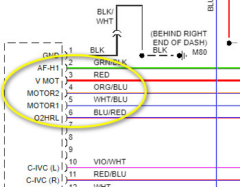

My car starts and stays running but when i press the accelerator pedal notion nothing happens. I have replaced the ECM, the throttle body, and the accelerator pedal and i still have. no response. What can the problem be?

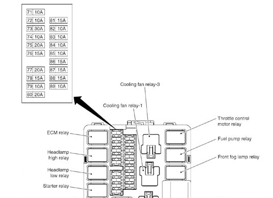

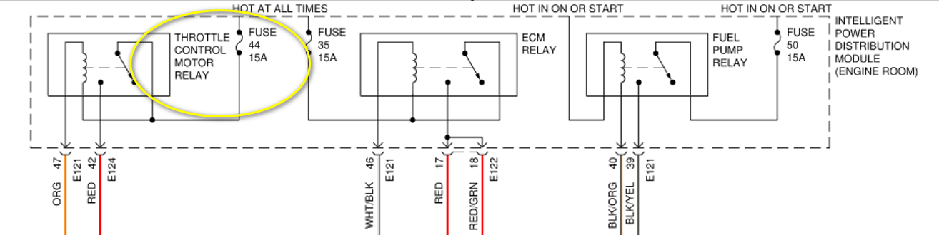

Next, I would suggest that you check fuse F44, 15A, in the IPDM. See image 1 below
This is the engine fuse block. The fuse supplies constant 12V to the throttle control relay. The relay then supplies 12V, pin 42(red wire) to the ECM, pin 3, which in turn powers the throttle actuator motor.
See image 2 below for the pin out of ECM.
See image 5 below for fuse and relay layout in IPDM.

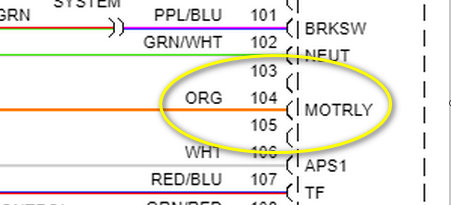

If no 12V is present at IPDM pin 42 then next check if ground/earth is present at IPDM pin 47, orange wire. This ground is a pull-down ground from the ECM on pin 104 to activate the relay
See image 3 below.

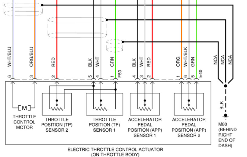

See image 4 below for the throttle control actuator.
If all the above tests do not reveal any faults, then I would suggest testing the two wires from ECM pin 4 +5, white/blue and orange/blue wires, to the throttle control actor pins 6+3
Check the wiring for continuity and resistance. Expect to see less than 5-ohm resistance pin to pin.
