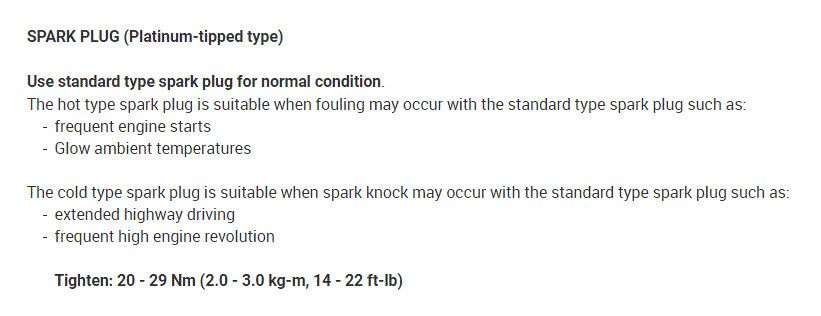

my car idles rough in gear and surges while driving so I need to tune up the engine and service the throttle bore.
Jan 31, 2009 at 8:12 AM
  • 110,194 POSTS

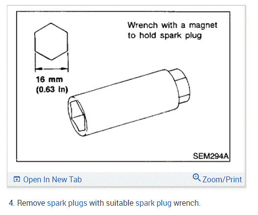

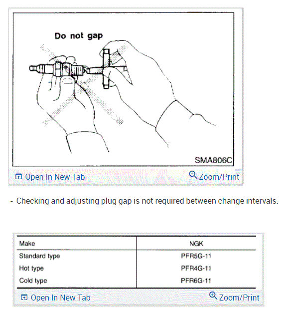

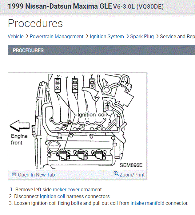

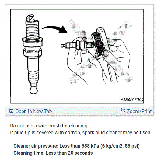

Performing a tune-up on this engine isn't too difficult to perform. Since each cylinder has its own ignition coil, you don't have to worry about ignition cables (spark plug wires).
To get you started, here is a link that explains the procedures related to spark plug removal. Additionally, it covers a few general maintenance items that should be serviced when a tune-up is completed.
https://www.2carpros.com/articles/how-to-tune-up-a-car-engine
If you look at the attached pics below, they provide the directions specific to your vehicle for spark plug replacement.
