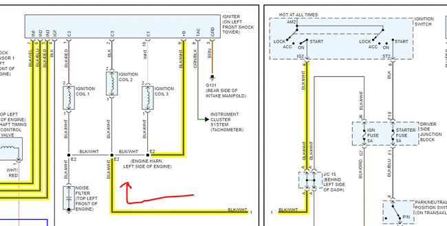

I attached a pic below from the wiring schematic. I need you to check for power to the black/white wire going to the igniter. Also, what other thing were affected? You mentioned input / output devices. Also, how have you straight wired the starter? In other words, what was bypassed to power the starter?
I noted you are a mechanic. Take a look at the schematic I attached and check for power from the ignition switch. Make sure the ignition fuse in pic didn't blow and there is power to it.

Okay, lets work backwards. You replaced the ECM. Is there power to the black/white wire in connector E6? Also, there should be battery power at the black/yellow wire in the same connector. Looking at the connector I mentioned, the power supply is coming from a 25 amp inj fuse.

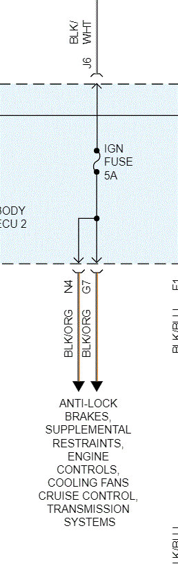

Okay, the Am2 is power to the ignition switch. It also powers the 5 amp ign fuse. Then it distributes to other components. I took a snap shot of the ign fuse (5 amp) and what it runs to.
Did the AM2 chance anything? Check to see if there is now power to the 5 amp ign fuse when the key is on.

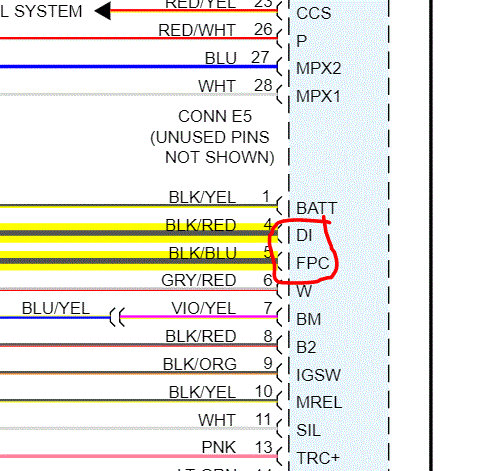

I just ran through 5 pages and can only find the injection relay. Take a look at the picture.

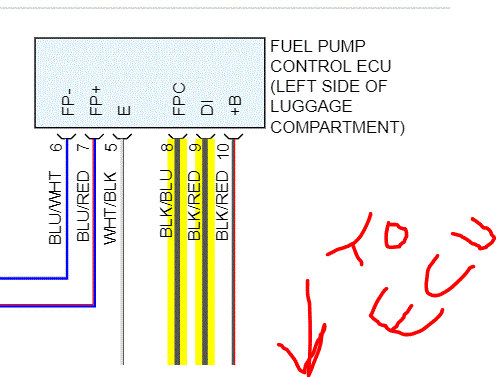

Found the fuel pump relay, it looks good however I did not put power to it. Now the relay is controlled by a module in the left rear if the trunk. It is controlled by the ECU. Any suggestions?

I attached two pics below. The first one is at the ECM, and yes it ties into the fuel pump control ECY you are referring to in the trunk. Power is supplied to the ECM via the EFI fuse. Signal is sent to the fuel pump ecu in the trunk. If you look at pic 2, it shows power distribution to the pump and power from the ECU. Check those two sets of wires for power in and out. Note, there is a white / black wire to ground. It's doubtful that anything is wrong with it, but make sure there is continuity to ground.

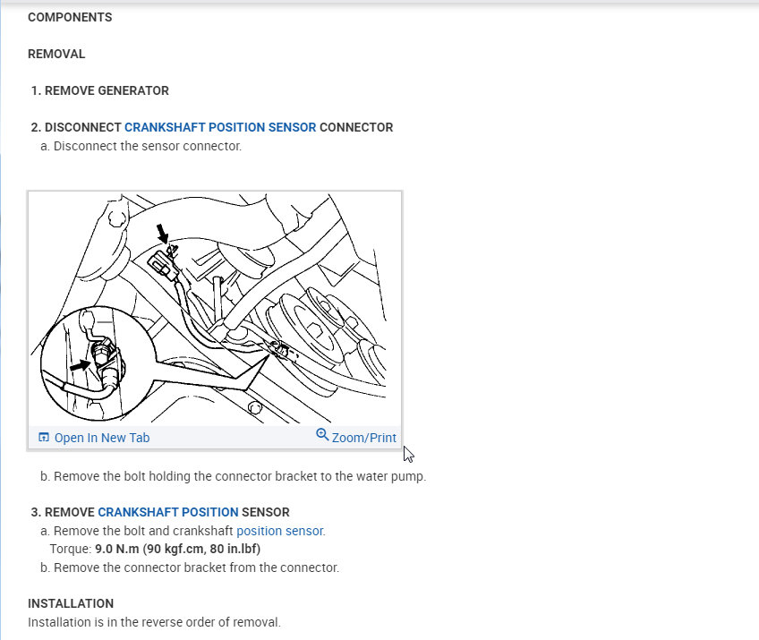

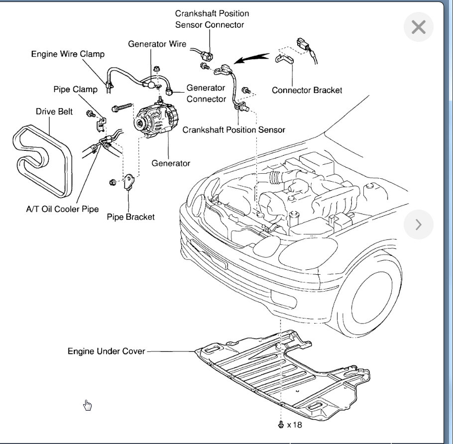

So um yeah, the pump is building pressure. The camera inspection inside the cylinder shows no pulse from the injector. So I've pulled out the crank position sensor. Thinking that something might be giving it a false readings. Is was dirty as heck.
