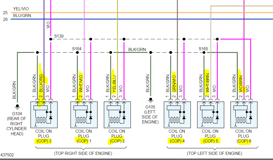

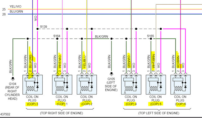

Okay. Each coil should have three wires coming to it. All will have a black (ground), Violet (power from PCM power relay/fuse 78) and then each will have a third wire that is a different color than the others (all go to the PCM) at the right rear of the engine.
First, if the only thing you did was remove and replace the coils and plugs, I can't imagine you damaged anything. Did you confirm the plugs were properly gaped? I have seen people collapse the electrode when installing.

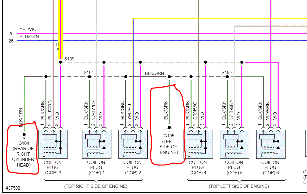

Next, if you were at all rough with the wiring harness, you may have damaged a ground. There are two grounds which all coils use. See pic 2

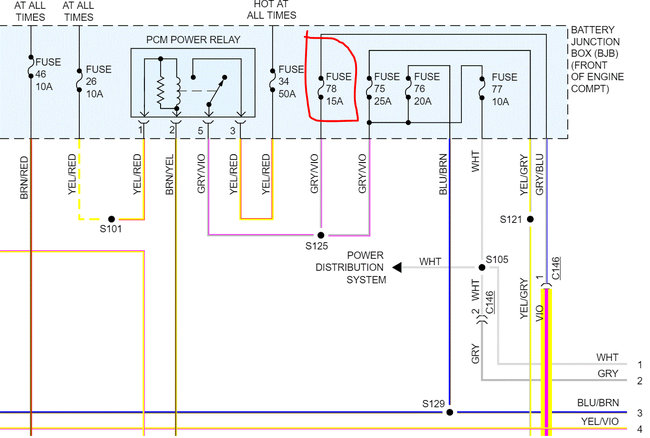

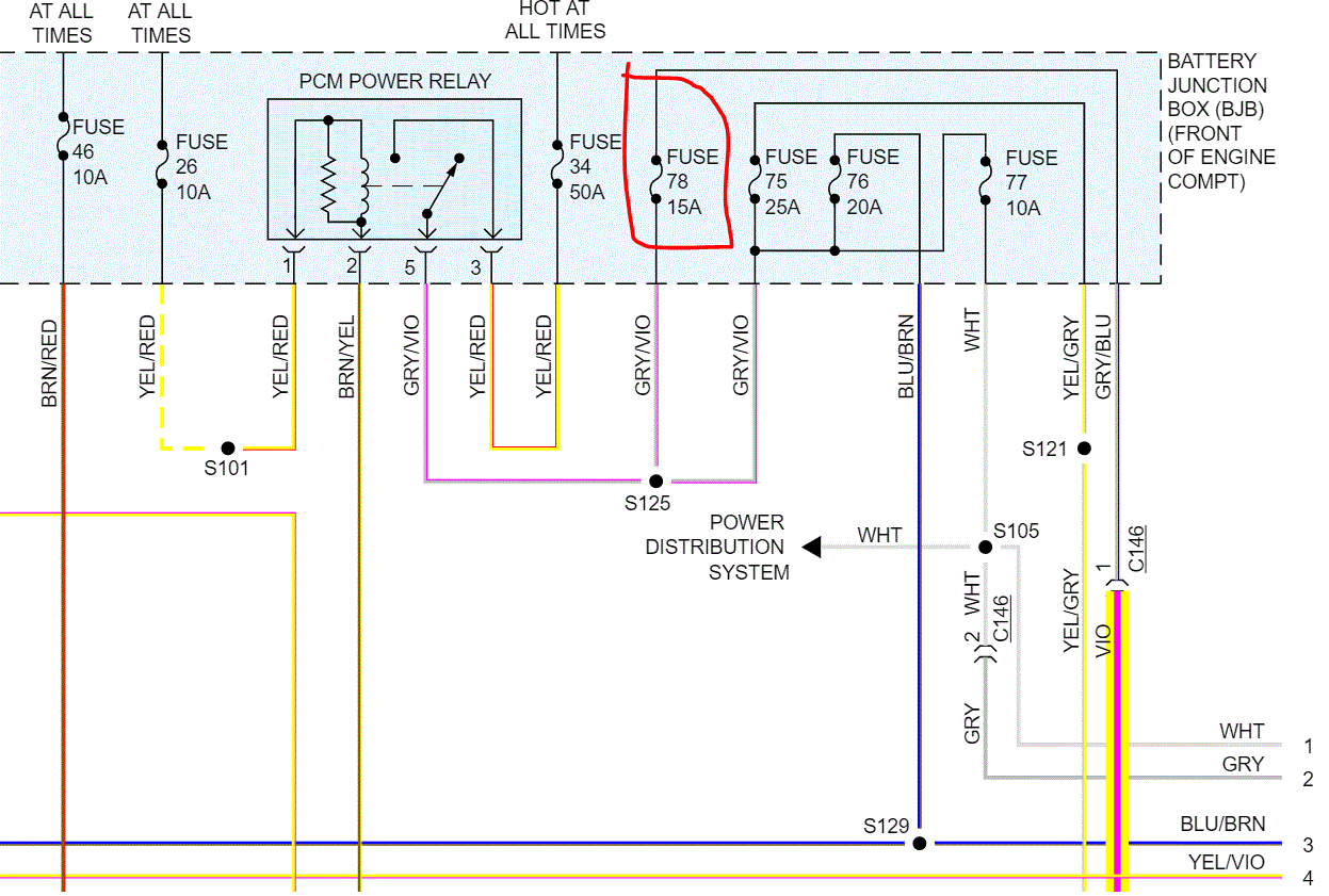

There is a chance something caused the PCM relay fuse to blow. Fuse 78 in the battery junction at the right front of the engine compartment.
If the ignition key was off, I feel the PCM is fine. So, first confirm fuse 78 is good. See pic 1.
While you are in there, check to make sure fuse 77 is good as well. That sends power to the PCM (VPWR) which simply stands for vehicle power.
If the fuses are good, the Violet wire should get power when cranking.
Next, check the black wire for continuity to ground. See pic 2.
I added pic 3 just so you can see the one different color wire to each coil. Those are the wires that go to the PCM. I can't imagine anything happened there, so we won't worry about that at this time.

Also, just so you understand the schematics better, although it seems that the coils always have a ground, that isn't the case. The PCM opens a ground path in the coil allowing the ground to activate. So even though it looks like they are attached directly to a ground (and they are) the ground circuit isn't completed until the PCM tells it to be.

You were right fuse #78 was blown #77 was okay. So we took all the old coils out, replaced them with the new ones and put in the new spark plugs also. But when we turned the ignition on it blew that #78 fuse again. After unplugging all the coils and plugging them back in one a time, found out that the coils or at least most of them were either bad or the wrong ones. Put the old coils back in with all new boots, put in new fuse and it started right up. I think after looking at the new coils they were not the same as the old ones. The new ones only had two prongs where the old ones had three. Thanks for all your insight I really appreciate it. Be safe and the best to you.
