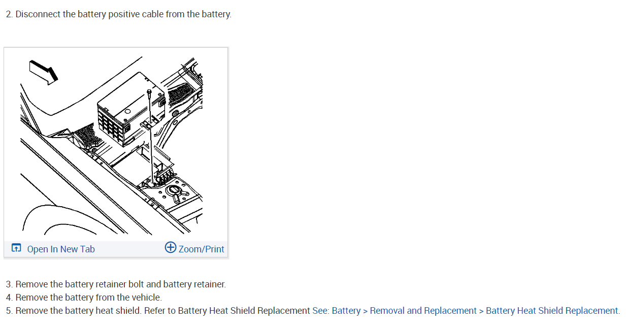

cleared evap code in computer then car wont start.can jump the starter and car runs for 2 seconds theft light don't blink

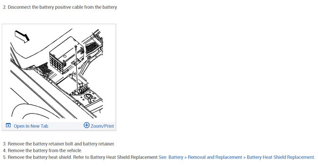

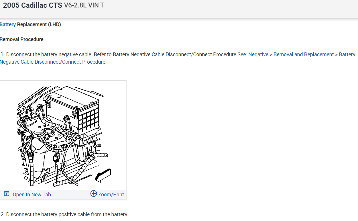

He said the security light is not flashing so no security issue. To me it sounds like the battery has shorted out internally, I would remove it and take it to the auto parts store for testing. Here is how. Check out the images (below). Let us know what you find.
