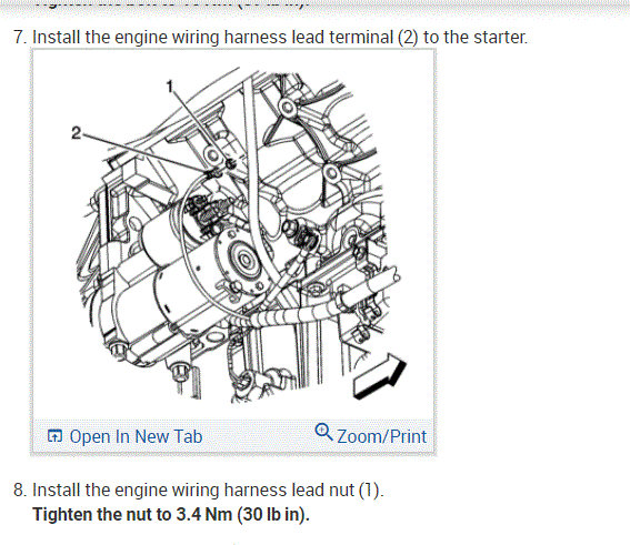

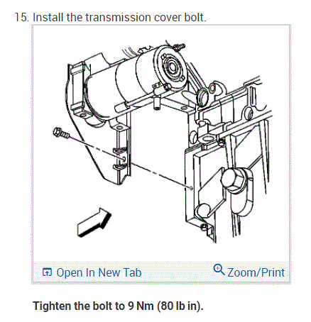

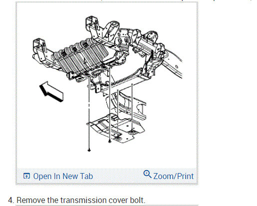

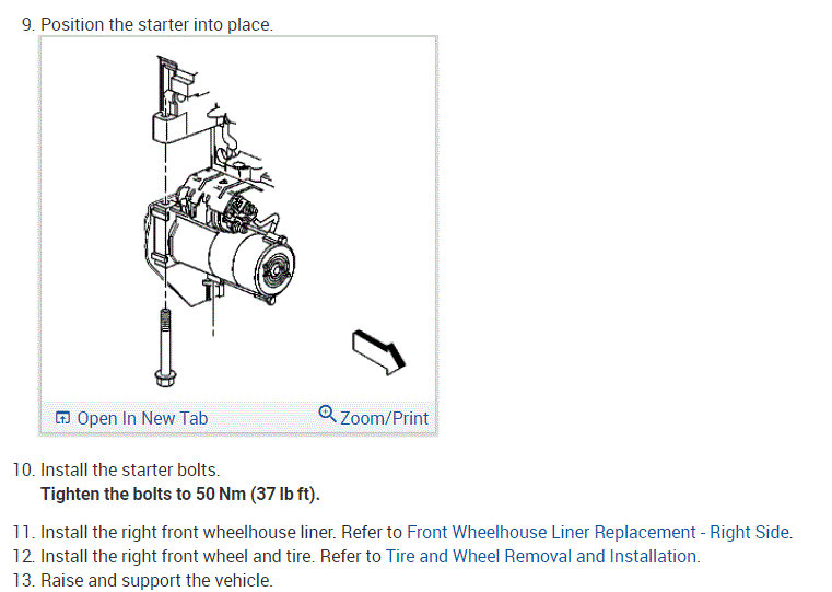

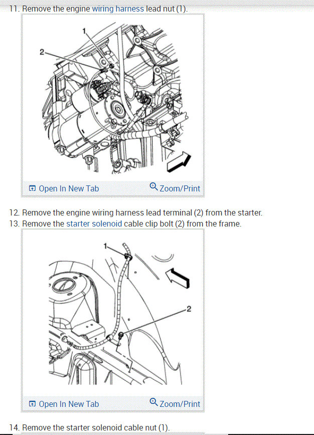

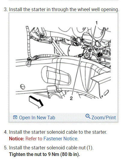

I need clarification on something. When you say the starter spins, do you mean it spins without turning the engine or it spins the engine but doesn't start?

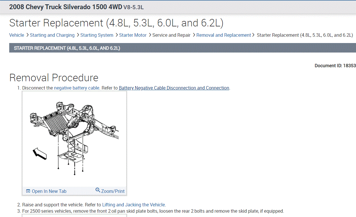

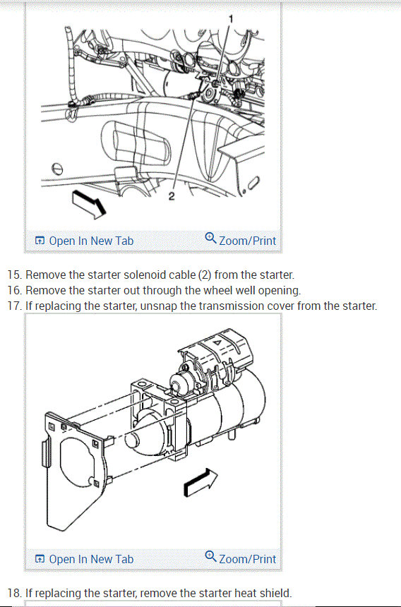

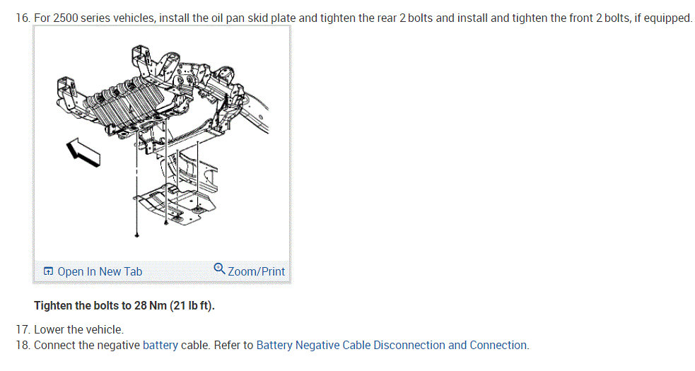

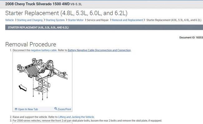

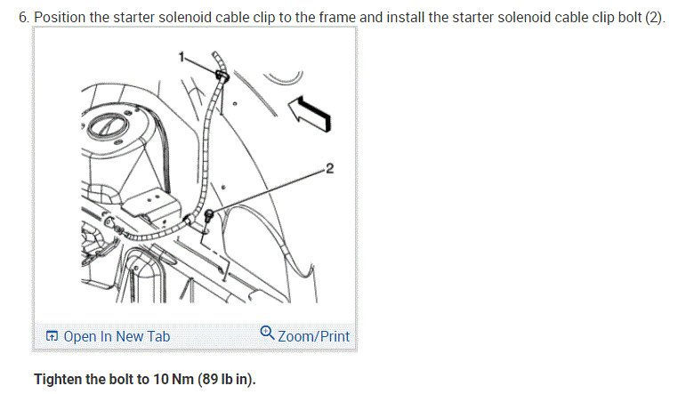

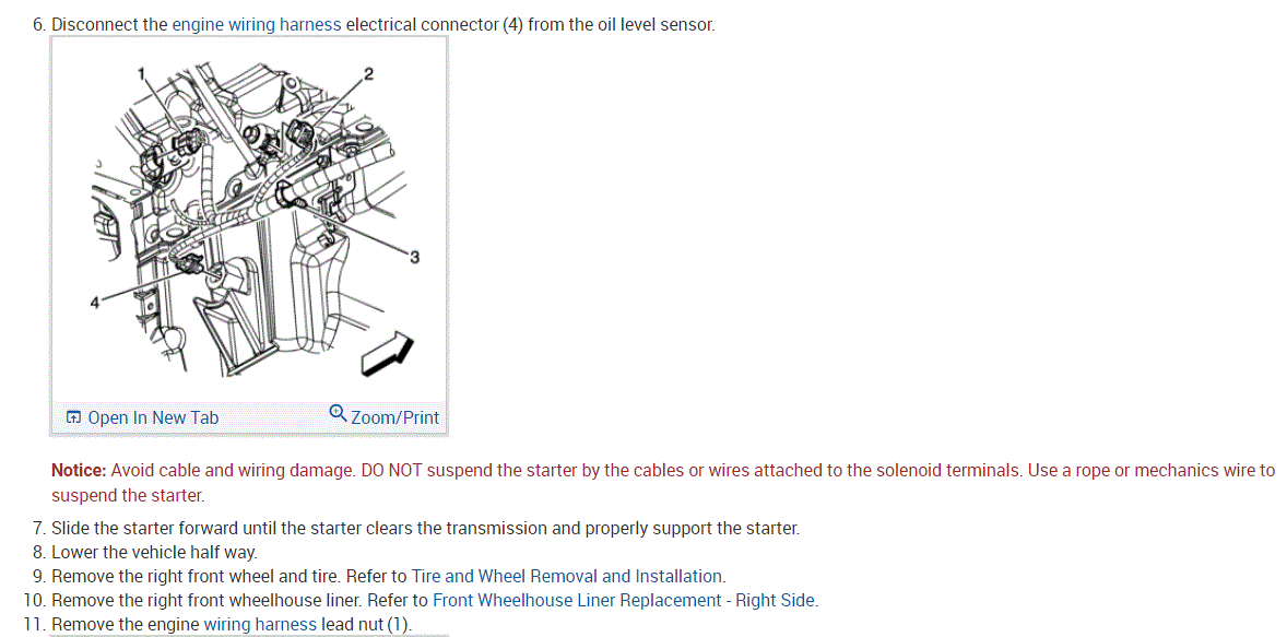

If the starter is turning the engine, it could be a few things. First, take a look through this link. It identifies the most common causes of a crank no start condition.

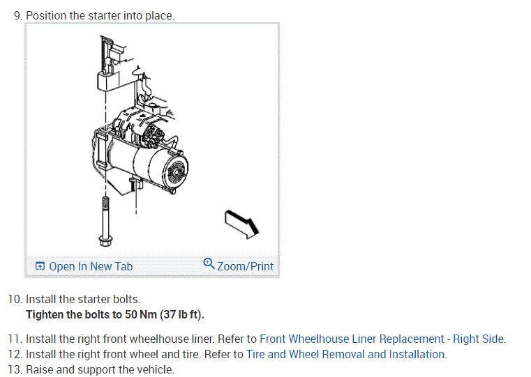

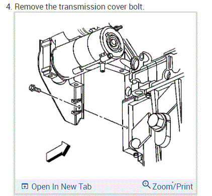

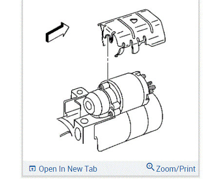

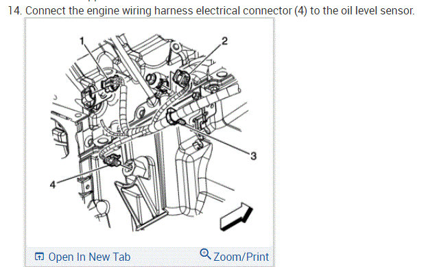

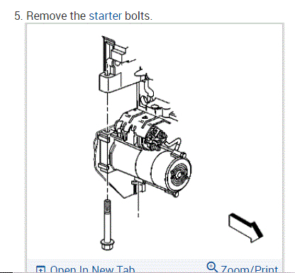

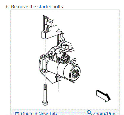

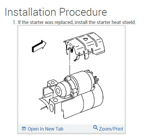

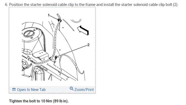

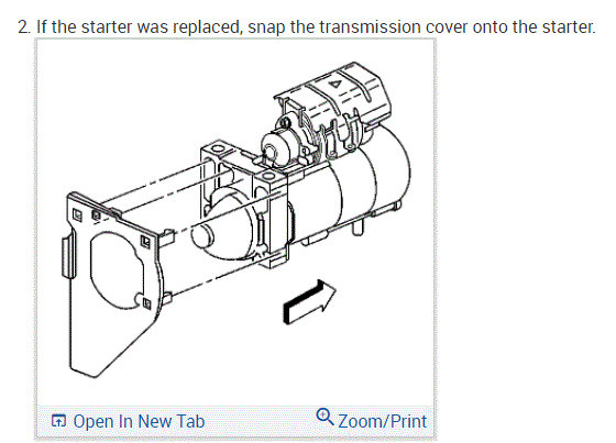

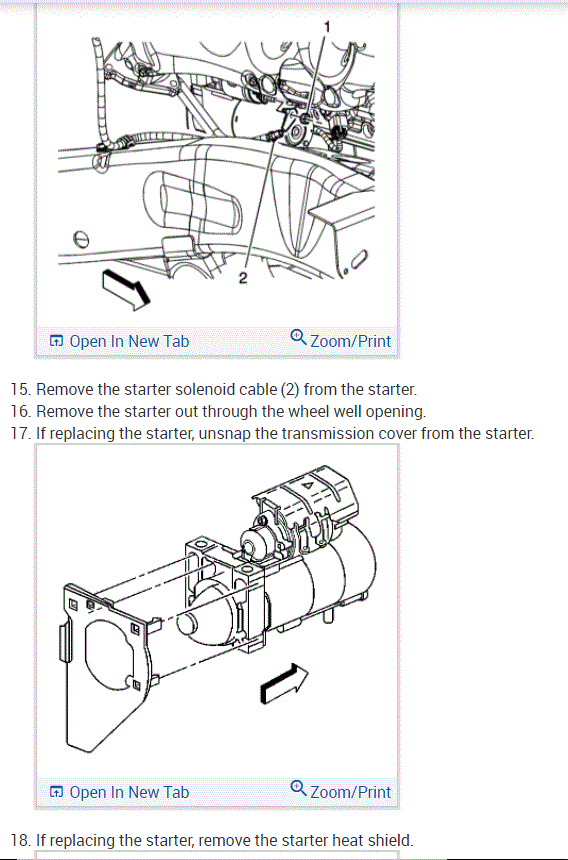

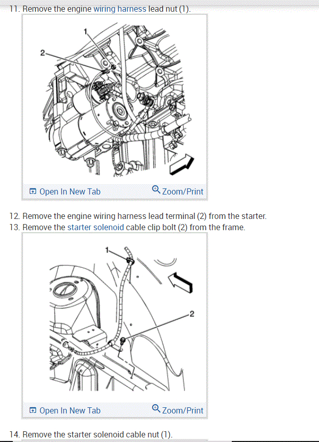

Next, if the starter spins but doesn't turn the engine at all, chances are you need to replace the starter because the Bendix isn't engaging the starter/flywheel.
If that is the case, here is a link that shows in general how it's replaced:
If you look at the attachments below, they provide the directions specific to your vehicle for replacement.
