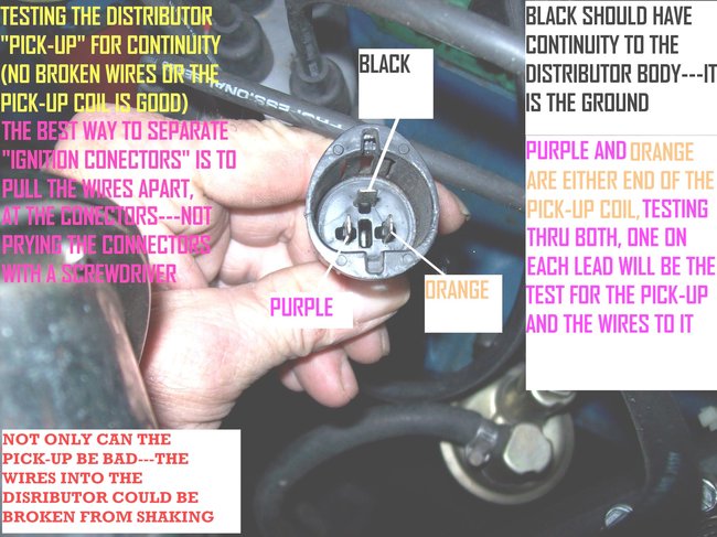

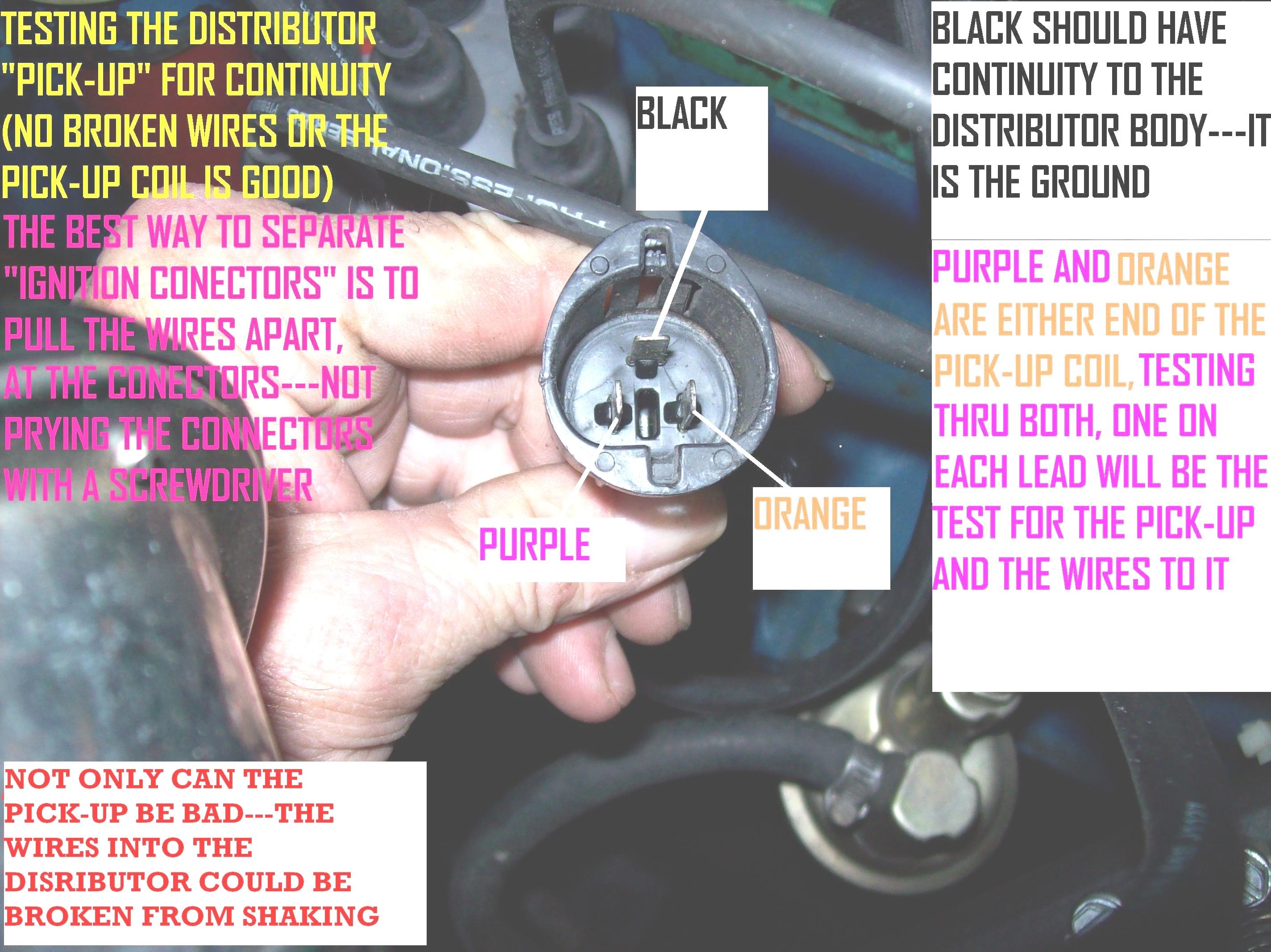

Let's go through the ignition stuff before we mess with the distributor.

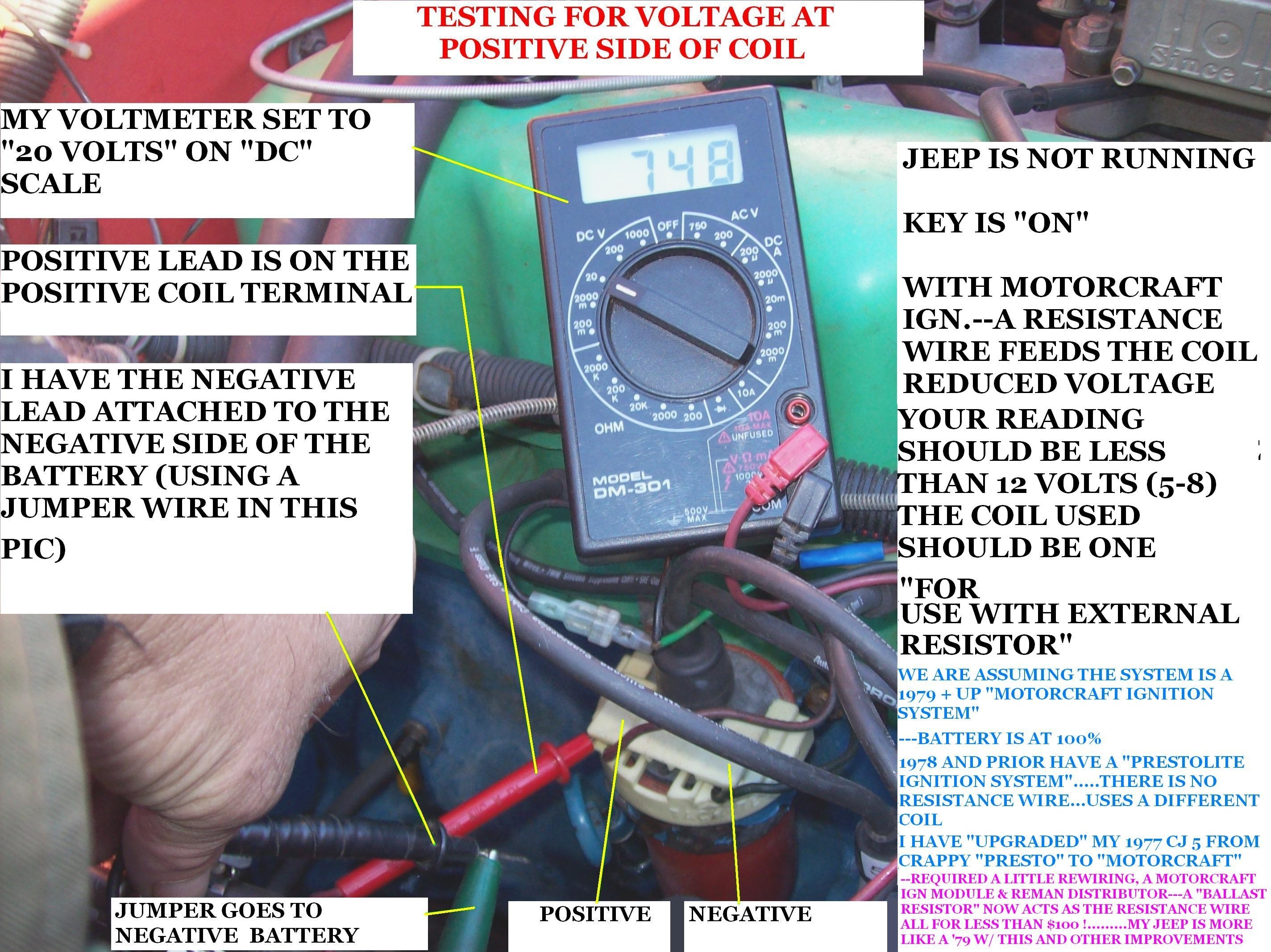

Key "on", what do we have at the positive side of the coil?

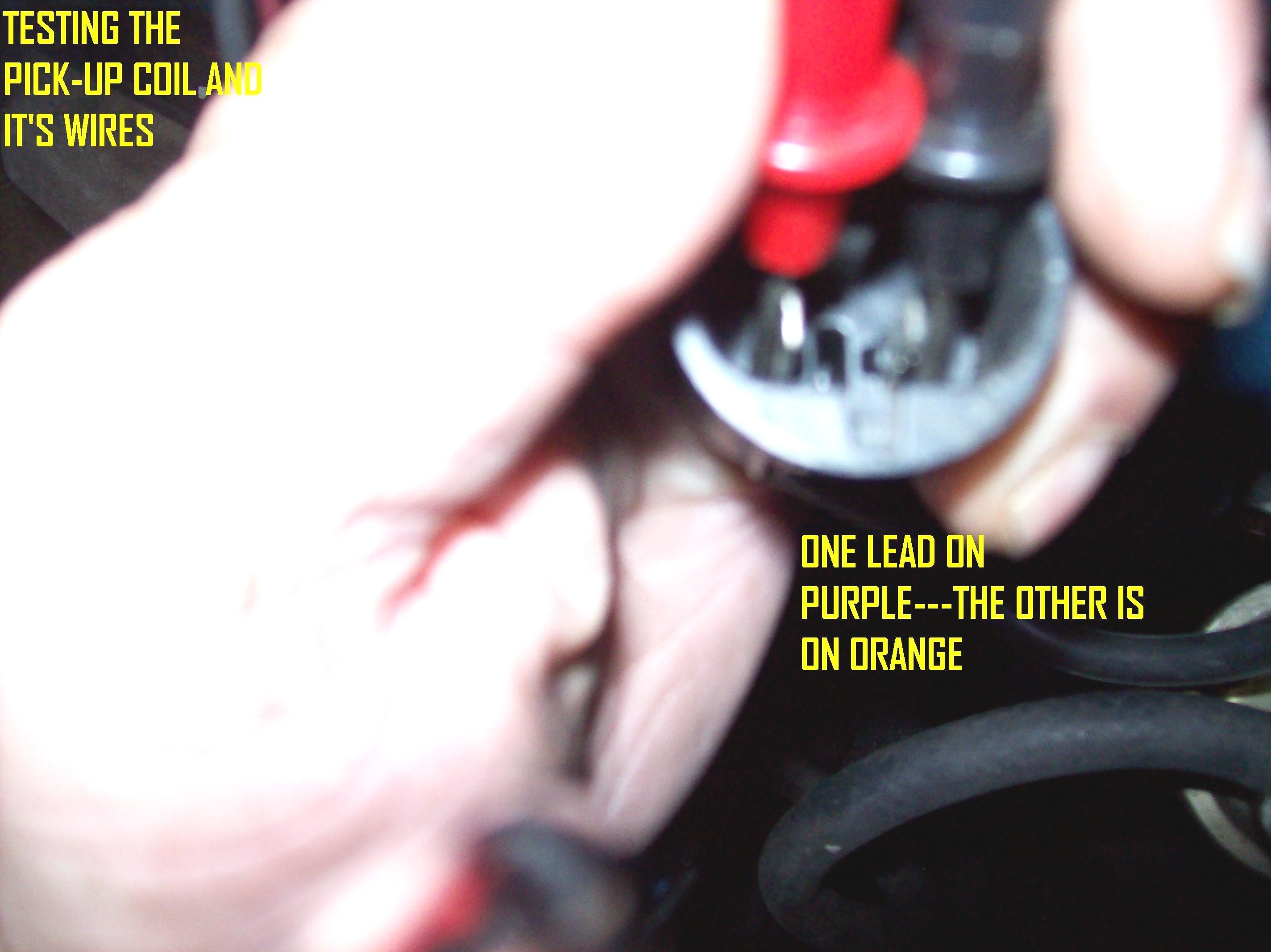

Test distributor pick up coil through the connector using continuity.
See pictures.

Hey, I have 6.72 volts on the plus side of the coil. I have cont on all wires.

What is the voltage at the coil while you are cranking?
