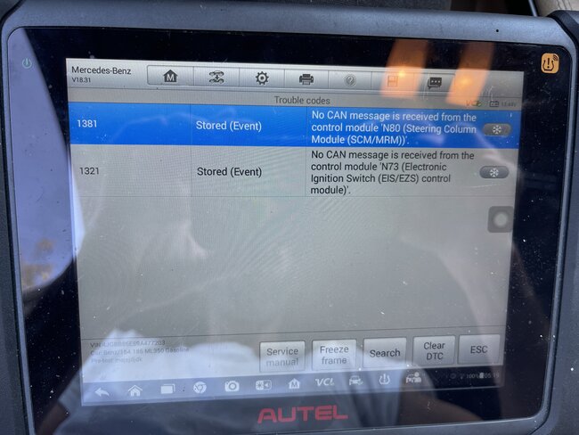

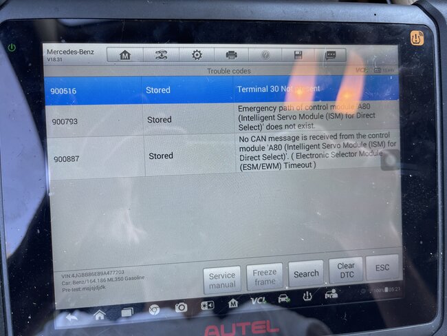

A friend of mine sent me this car to look at. all of a sudden one day it won't start, no clicks or any noises, not the battery, I doubt it is the starter as well. scanned it and it has codes:
0722
c002
c426
2226
C426 is the main one I think, I am trying to find if it's the common module behind the key ignition that requires soldering or the SAM.
I'm not sure if the ignition module would cause a no turn signal or horn. Fob still works and locks and unlocks.
All lights come on when you turn ignition on.

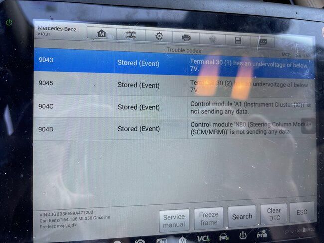

I disconnected the battery cable and connected back after few seconds and it started, ugh, not sure what is going on.
Aug 17, 2023 at 10:43 PM
BHAMDOC1973
  • 2,007 POSTS
While its still running i scanned it.
Aug 17, 2023 at 11:23 PM

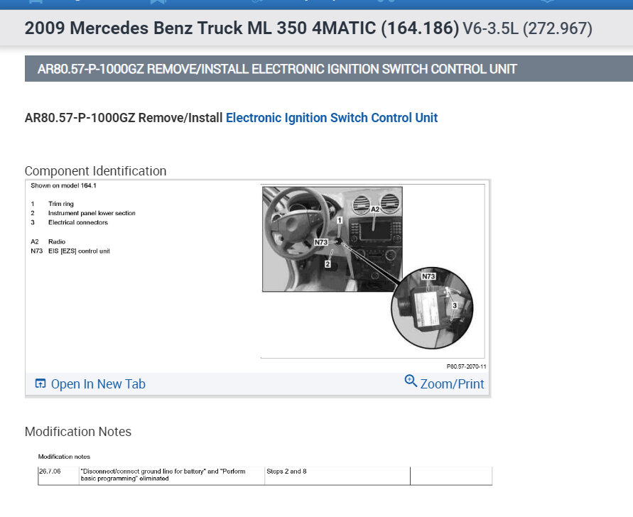

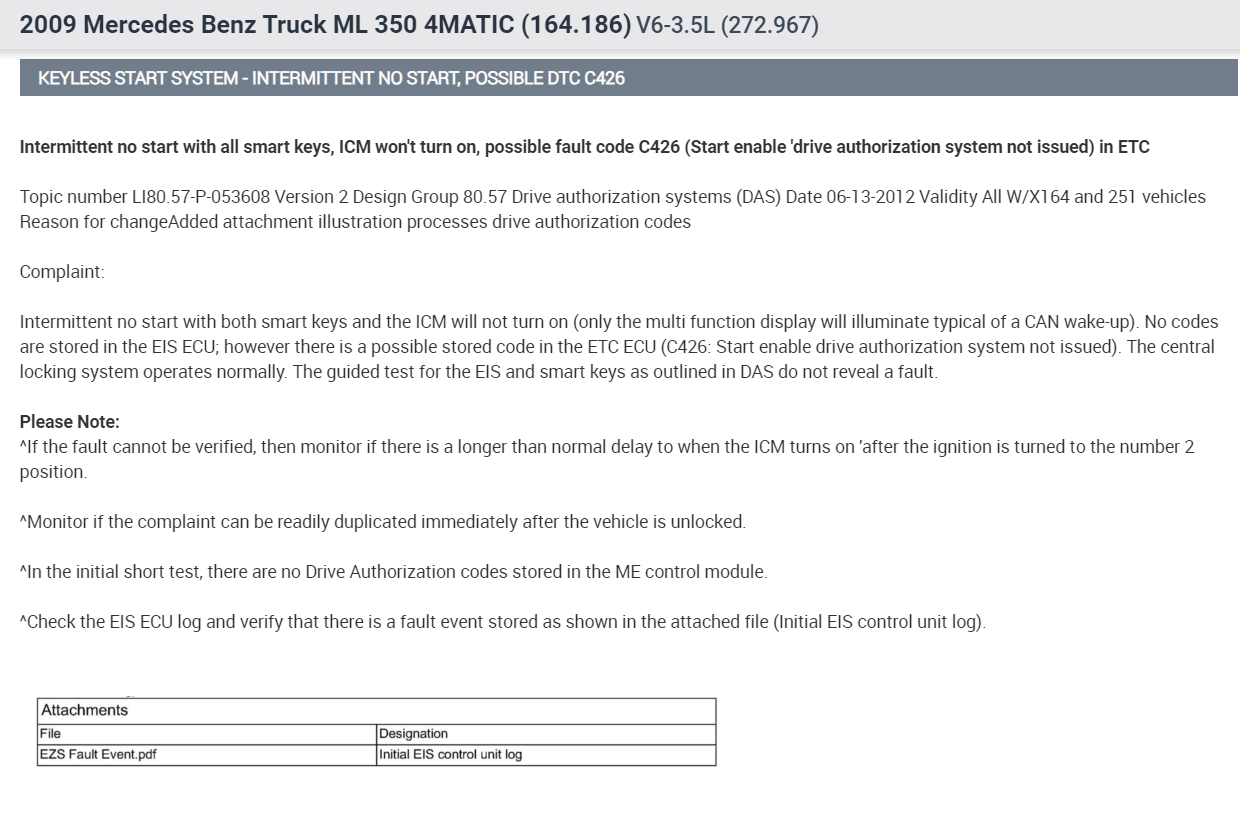

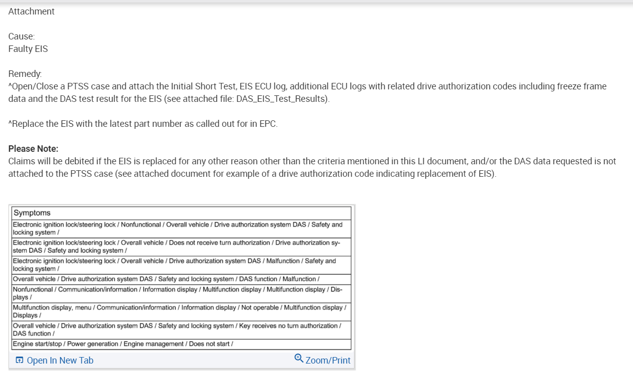

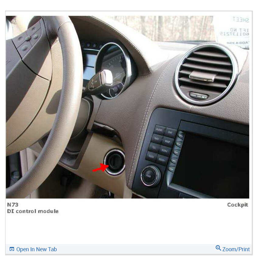

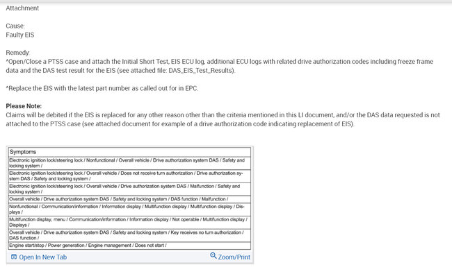

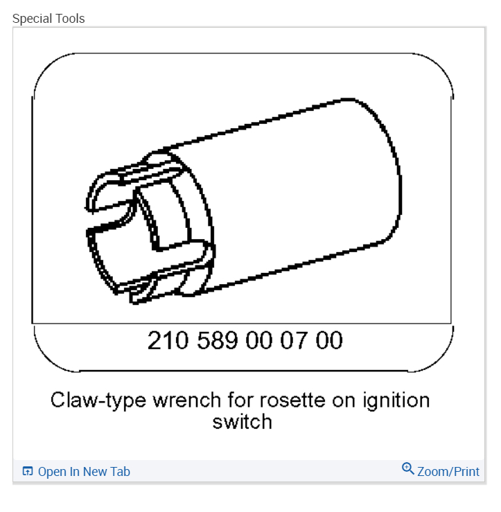

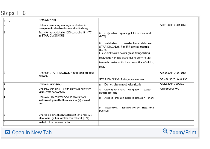

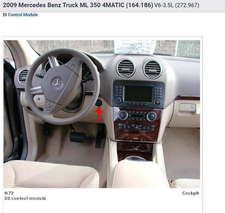

I would start by checking all fuses with the systems on.
If the fuses are good, it sounds like the EIS needs to be replaced. There is a TSB for this problem which I have attached.
