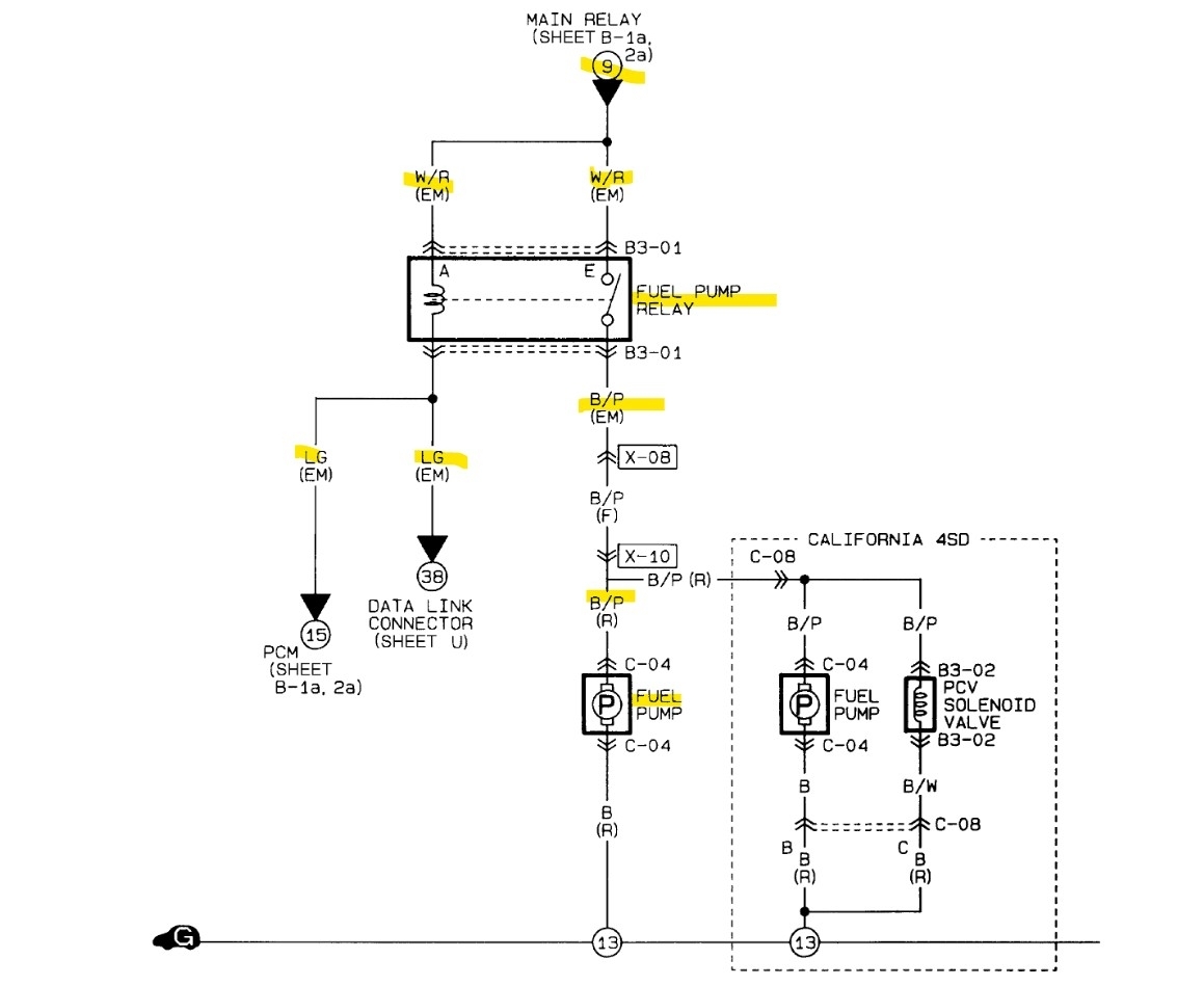

I can confirm the light green wire is for fuel pump activation as i found it on the ecu and the relay on the relay it is connected with 2 green wires and 2 white and red trace wires in one pin and in the middle i think pink and black. On the other only 2 white with red tracer wires but all this still does not add up to no spark or no pulse. From distributor. I have no diagram for color codes on distributor and not sure how to test it or how to hard wire a test for distributor only but since all is connected to ignition system. i think not everything is turning on, on car the main fuse checks and i do have 12 v on distributor and ECU.

Okay, that VIN is not showing up, are you located in the US? But the only models with a 1.8 are the two I listed previously. I'd be really surprised it doesn't have a check engine light, even pre-1996 (OBD1) had check engine or malfunction indicated lamps. There should be a tag either under the hood or in the driver side door frame that has a build date on it, just a month and year (ie, 06-94 for example).

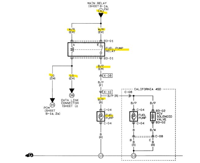

But for the MX-5 on the MAIN ECM relay I do see 2 White/Green wires going to one pin which feed the load side of the relay, that relay in turn, feeds the fuel pump relay on the White/Red wire, the White/Red wire also powers the fuel injectors and bunch of other things.
The MAIN relay also has a double pin Black/White wire which is the ground for that relay, its activated by the ignition switch feeding it power.
If you can post a picture of the VIN, I can search for that a little bit more.

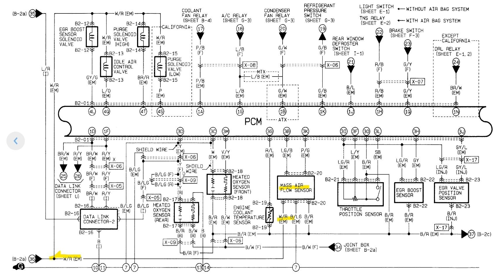

For the Protege that White/Red wire comes from the relay labelled "MAIN Relay (FUEL INJ)" but it powers many other components as well as the ECM with the key On. It also powers the Distributor so that's probably why you aren't getting any spark, but the two vehicles have a slightly different setup when it comes the engine harness wiring.
Just trying to look over this as close as possible, the Protege has a Distributor, but the MX-5 looks to have two coil packs, so we'll go with the Protege wiring diagrams for now.

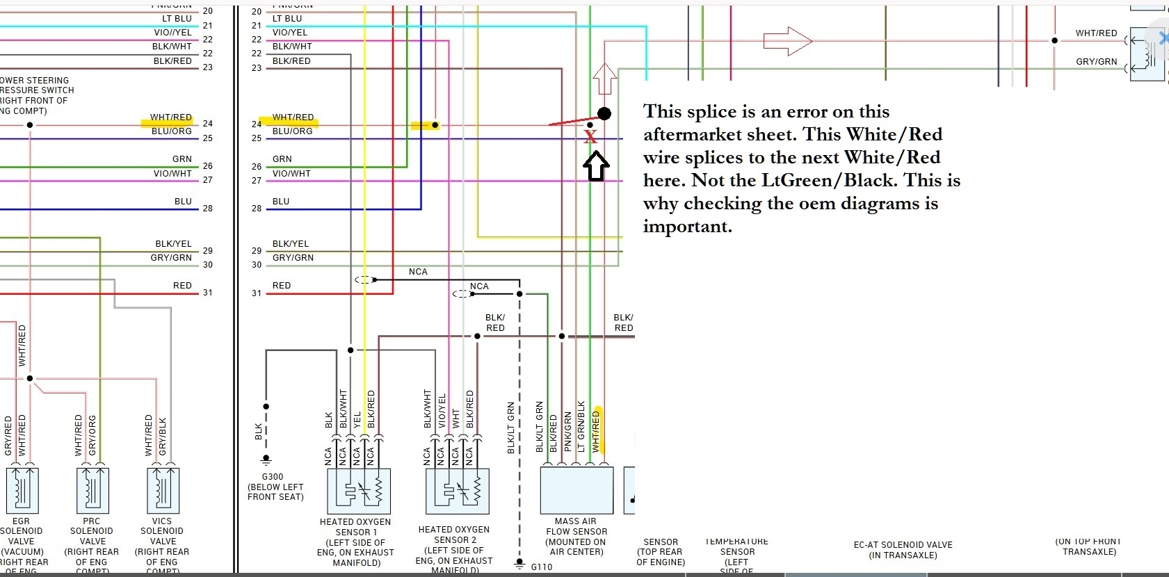

The White/Red wire does have a splice after leaving the Main relay, where it breaks of continuing as a White/Red, but also a White/Blue wire, which can also cause some confusion when trying to trace down these wires, the White/Blue wire feeds the injectors.
Strangely enough the White/Red wire goes to another splice which turns Lt Green/Black and that feeds the MAF and runs to the ECM.
So, some really stupid wire colors changes that shouldn't be like that. I'll go over any OEM diagrams as well if there are any,

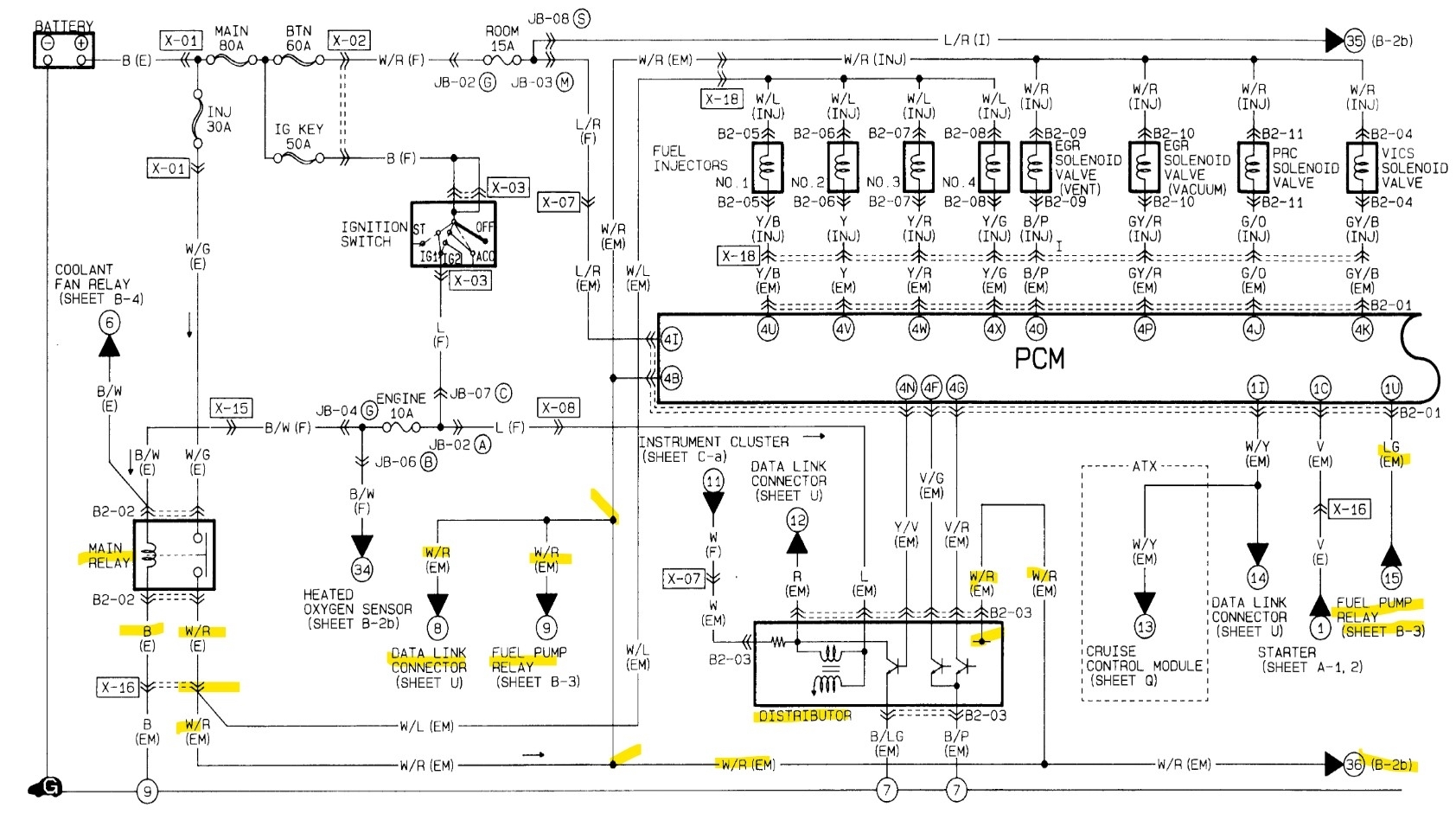

This Main relay should have a constant ground on the black wire, so that's something you can check with a test light hooked to battery positive, with the relay out, the Main relay should have one pin with constant power, then the black/white wire with power from the Ign switch, You can check those with a test light hooked to Battery Negative. And then I would move on to the Fuel pump relay if that first one is okay.

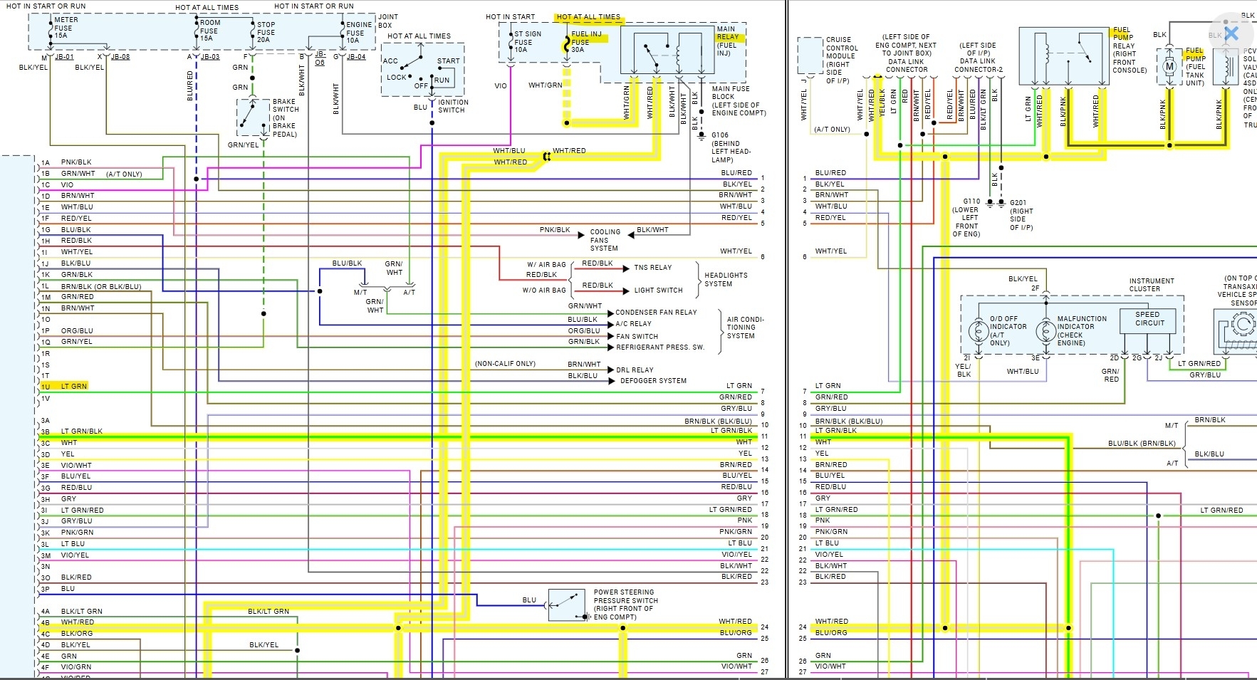

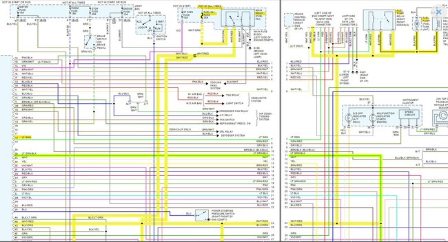

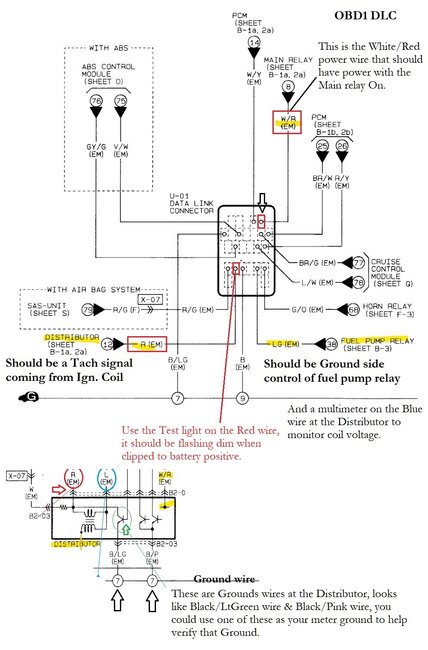

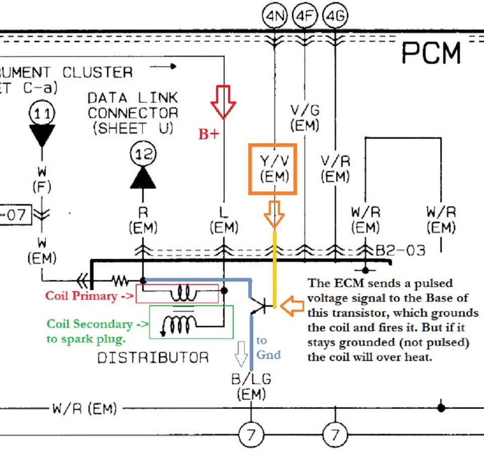

I'll post the diagrams i'm looking at here.
Jan 13, 2025 at 1:19 AM
AL514
  • 5,639 POSTS

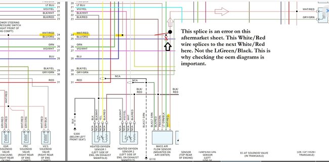

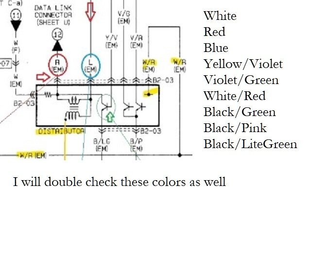

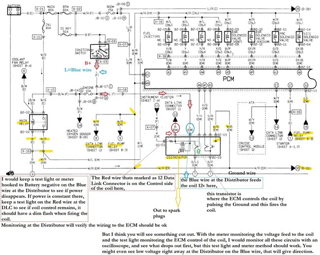

There is an error on the first diagram here, I've shown it better in diagram 2, then added the OEM ones (3-6) which shows the White/Red wire going to power the MAF.
So if these are correct, power comes from the Main relay via the White/Red wire, powers both side of the fuel pump relay (control and load) and then the ECM grounds the fuel pump relay on that lt green wire, which looks like you should be able to check if it's being grounded at the DLC. I'll look for DLC pinout for you as well.

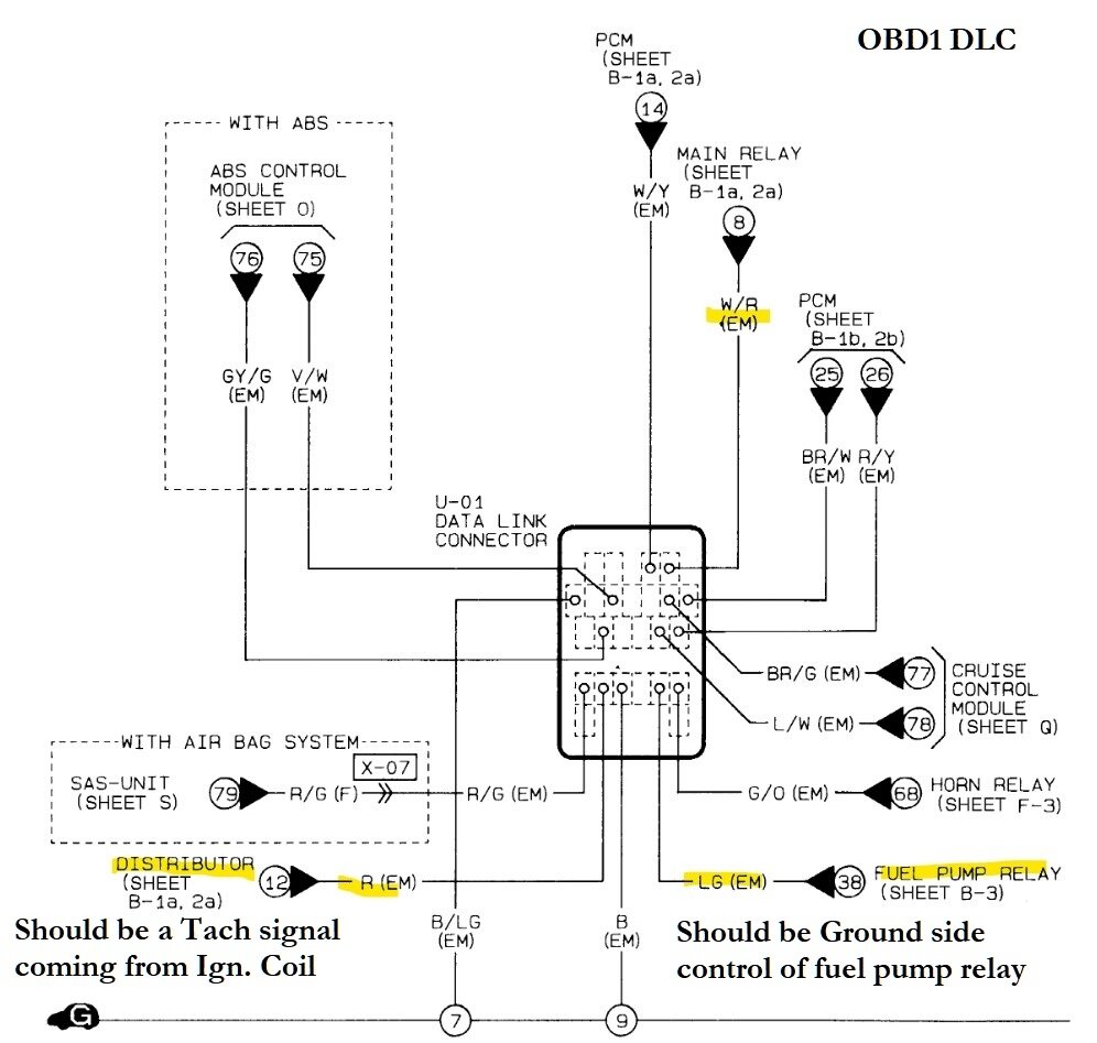

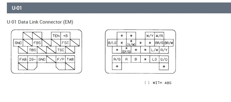

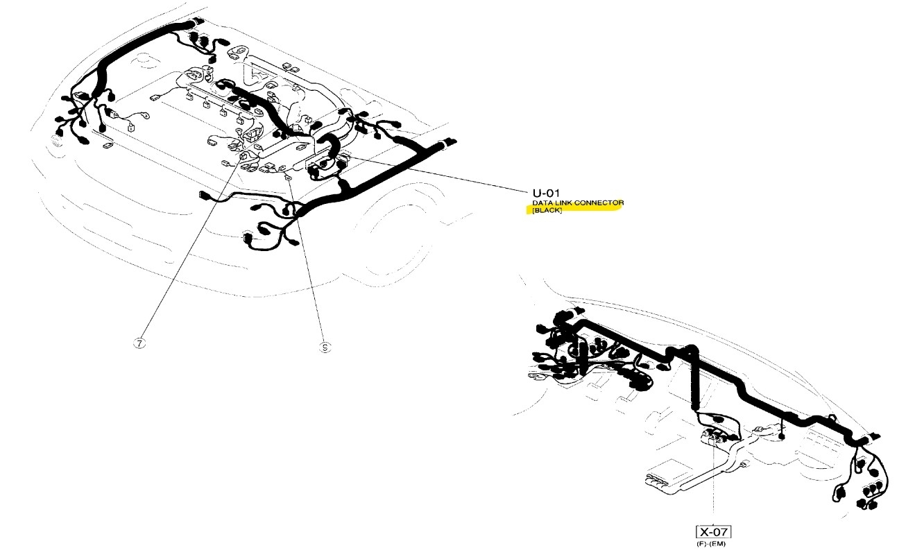

Here is the data link connector location and pinout, let me know what other diagrams you may want and what you find during testing. It's definitely an OBD1 connector.

Sorry for asking what is dlc. And thank you for all your trouble, it seems like you go through a great deal of effort to help guys like me. You're great thanks
Jan 13, 2025 at 5:44 AM
BENNIE ZINN
  • 35 POSTS
And yes, that is the data link connector i have and if i ground the light green wire it does turn on fuel pump. I noticed when i crank the engine (only for like a second) it's like the oil pressure light goes off and remains off for maybe 2 seconds then comes back on.

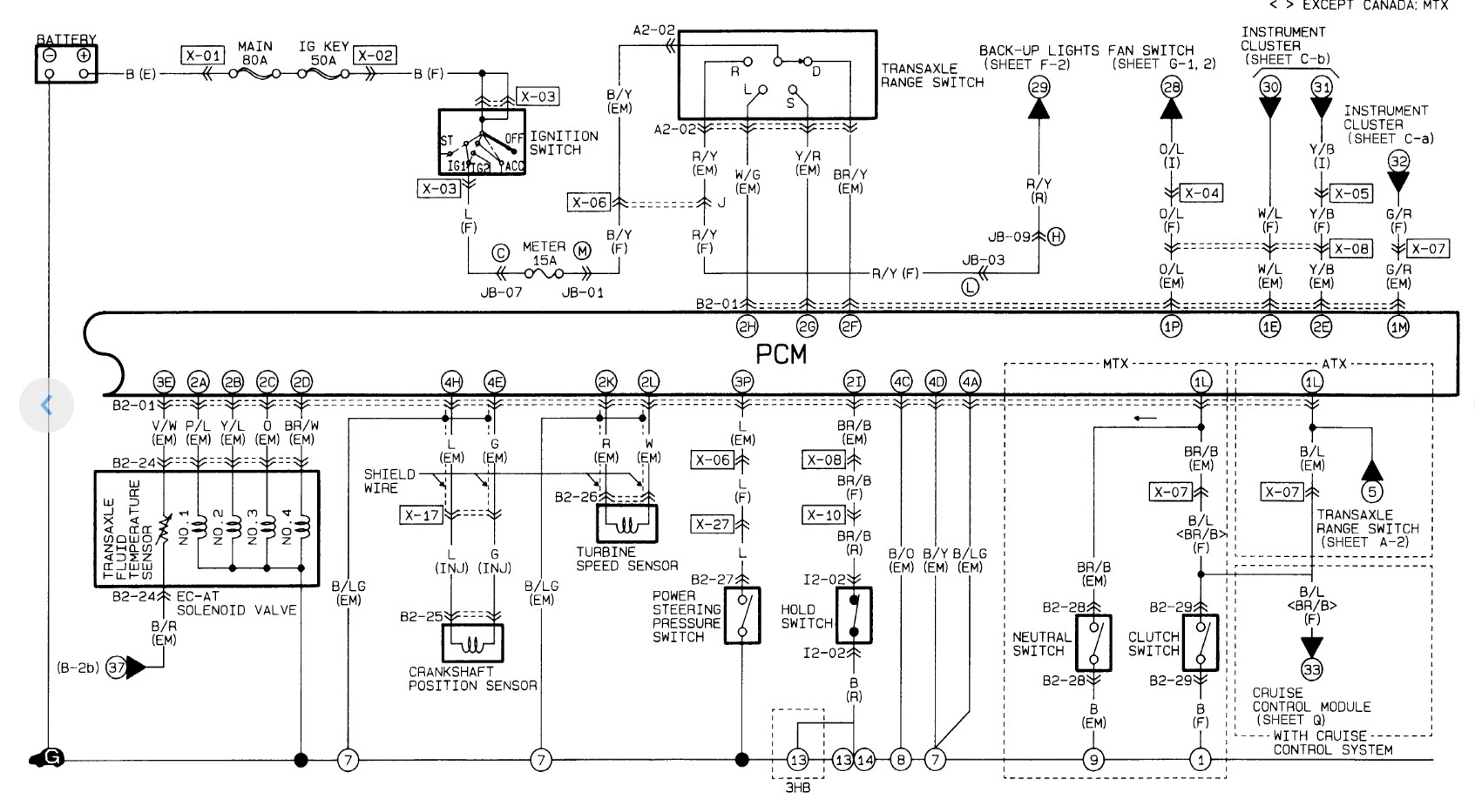

I'm looking at a "Central Processing Unit" which has a switch for when the key is left in the ignition, it should chime and remind you it's been left in. This module has all the door switches, seat belt switch, parking brake switch. It does go to the cluster, mostly warning lamps, I think.

Sorry just seeing your other comments, the data link connector is not like the 16 pin OBD2 ones we have now.

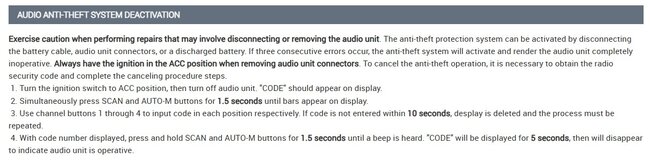

This is what is listed for anti-theft, it's mostly about the radio code, but if there's a light there has to be a system for security of some kind.

Jan 14, 2025 at 7:15 AM
AL514
  • 5,639 POSTS
Sorry there's a lot of information here for testing using a meter and test light at the same time in the first diagram, 2nd diagram shows the pins at the DLC you can test the coil control on the Red wire with the test light, you can also monitor the White/Red wire there for constant power from the ignition switch.
The pin to the right of the red wire (coil control) is a Black wire which is ground that can be used when monitoring the White/Red wire for power.
you're probably going to need someone to crank the engine for you so you can watch the test light and meter, the flash on the test light from the coil control is going to be a dim flash, so watch closely.
Take picture of the security system wire splices for me, if its aftermarket, I have to disable those quite often and they are pretty obvious.

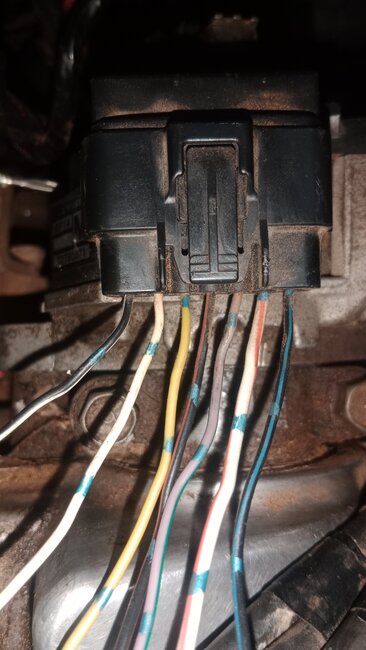

BENNIE ZINN
  • 35 POSTS
No original loom is:
3 pin plug
Black
Red
White.
6 pin plug it is
White red tracer
Black green tracer
Purple red tracer
Purple green tracer
White red tracer
Black pink tracer.
Jan 17, 2025 at 5:26 AM
BENNIE ZINN
  • 35 POSTS
On the other it only has 6 pin plug.
Black/white tracer
White
Yellow
Black/red tracer
Purple/green tracer
White/red tracer
Black/blue tracer
Jan 17, 2025 at 5:28 AM
BENNIE ZINN
  • 35 POSTS
Got a joined connecton on original loomwith 2 plugs
3pin plug
White
Red
Black
. 6 pin plug
Brown yellow tracer (instead of white red tracer )
Black with green tracer
Purple with red tracer
Purple with green tracer
White red tracer
Black pink tracer.
Jan 17, 2025 at 5:36 AM

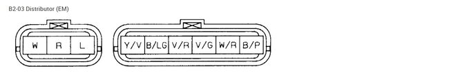

Okay so the only thing different on your vehicle is the 3-pin connector in service info has white, red, blue, Then the 6-pin connector is the same except the 1st wire which is Yellow/Violet(purple).
On the 3-wire connector the blue wire is shown as 12v power from the ignition switch, so that's something you could check. I found the connectors pinouts, Ill post that in a sec.
The Yellow/Purple wire in the 6 pin is supposed to be the coil control wire from the ECM.
Do you not have a 12v test light? I realize you being in South Africa access to tools is probably limited there. Let me know what you do have for tools, such as multimeter or not. I understand testing would be very difficult without these things.
We might be able to improvise if you're lacking a test light, by using a marker lamp bulb or head lamp, I apologize, I didn't really think about that.
These are the two connectors for the Dist.
But if we can rig up a couple test lights, you could see if you're losing power to the coil when it's not producing a spark.

Okay, if the coil is getting hot and not firing, that means current is flowing through the coil, that's why it's getting hot. And in most cases when a coil is getting super-hot, I will find that the control wire is shorted to ground, I see this happen a lot with 2 wire coils where the ECM doesn't have the ability to shut down the coil to protect the ECM in case of a fault.
When the coil is not firing, check with your test light if the control wire from the ECM is on constantly, in the below diagram the highlighted blue-ish wire I marked is the wire that runs from the coil through the transistor to ground. But for current to flow that transistor has to be either active from a voltage signal from the ECM or its starting to fail inside and shorting itself internally allowing current to flow through the coil to ground.
Thanks for the picture of the 6-pin connector, I see the wires are not in the same location as the diagram. The diagram shows the Yellow/Purple wire is supposed to be the wire the ECM will send out a voltage pulse to the Base of the control transistor. So, with an LED test light hooked to ground it should flash as the ECM signals to the transistor's Base, I tried to show as best as possible on the diagram below.
Using an LED test light is the best way to test ECM circuits because they are such low current devices.
