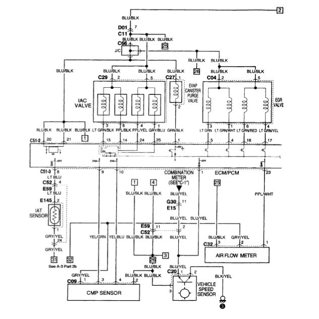

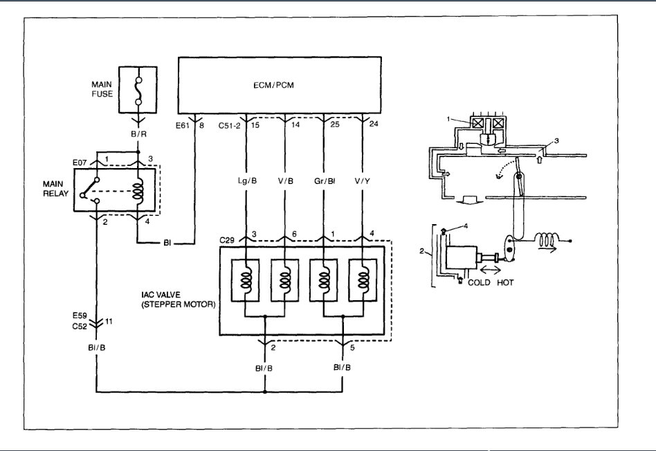

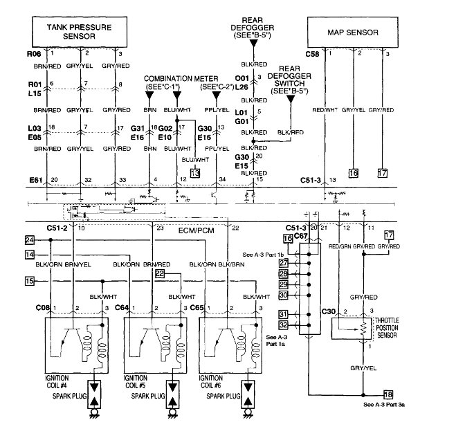

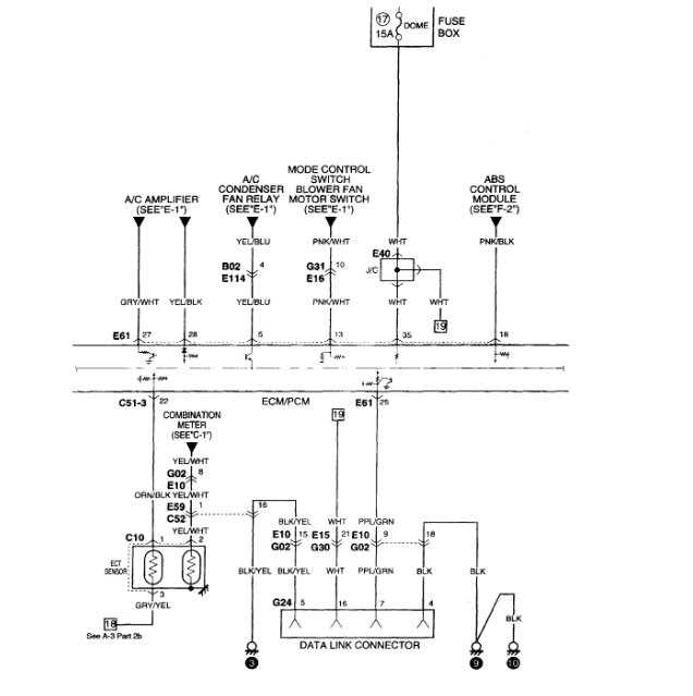

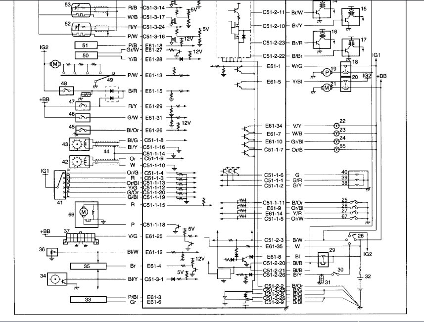

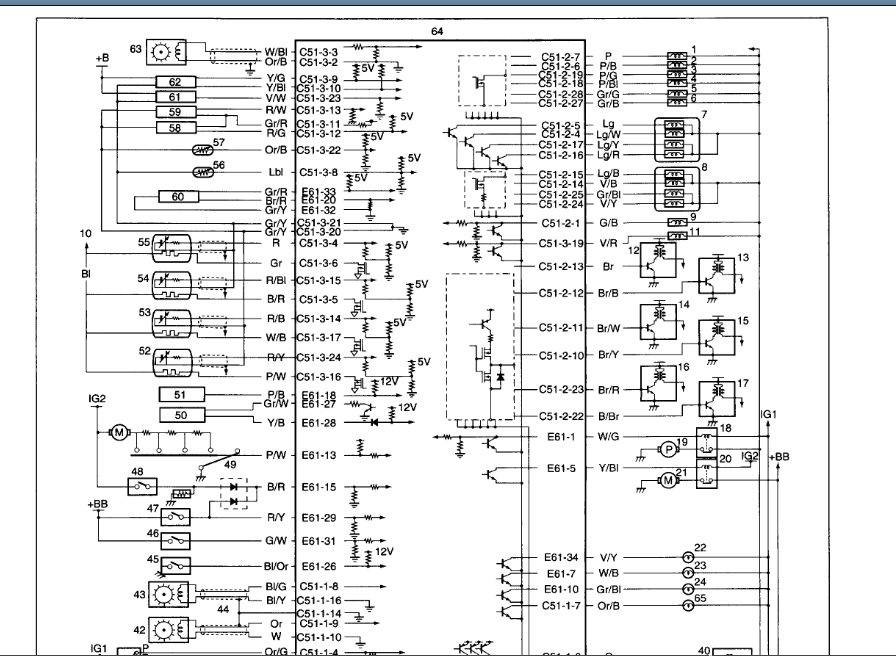

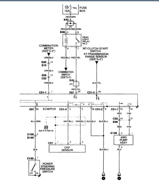

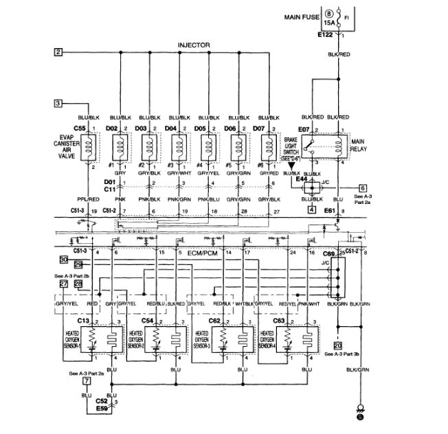

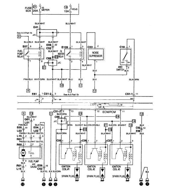

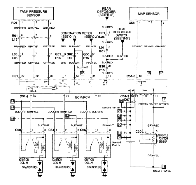

This sounds to me like your vehicle's Power-train Control Module [PCM] or "computer" has an internal short in it. In the diagrams down below I have included your vehicle's electrical schematic and wiring diagrams for ignition and engine performance for you in the diagrams down below. Please go through these and get back to us with what you find out. We have instructions for the removal and installation of your vehicle's PCM if you would like them. Let us know.
Thanks,
Alex
2CarPros

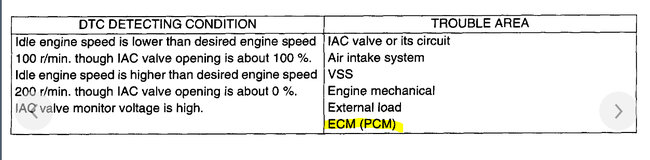

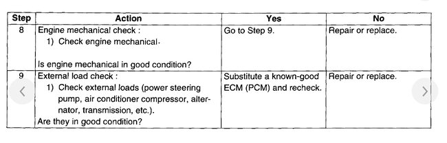

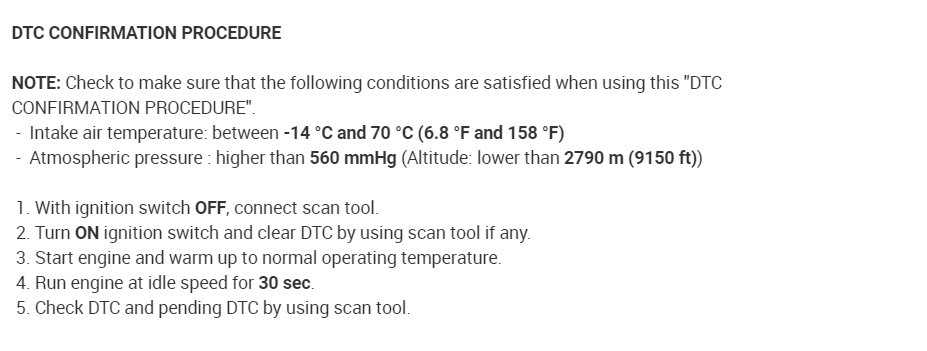

Hello again,

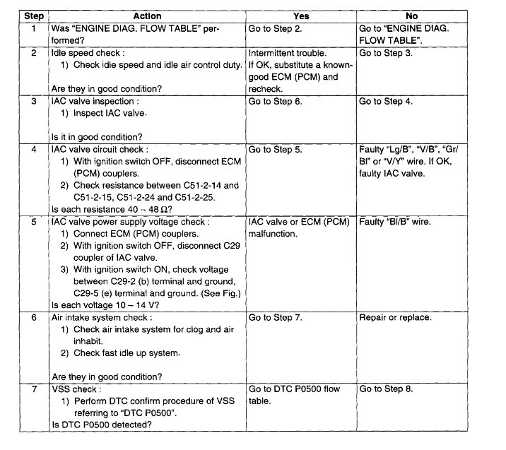

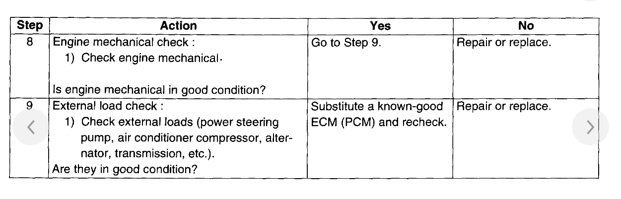

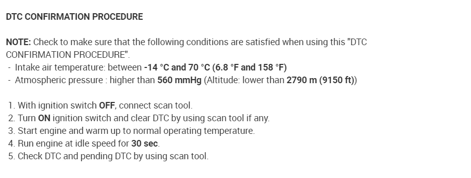

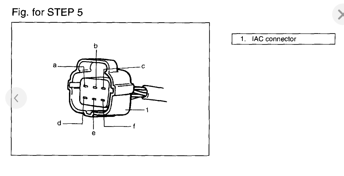

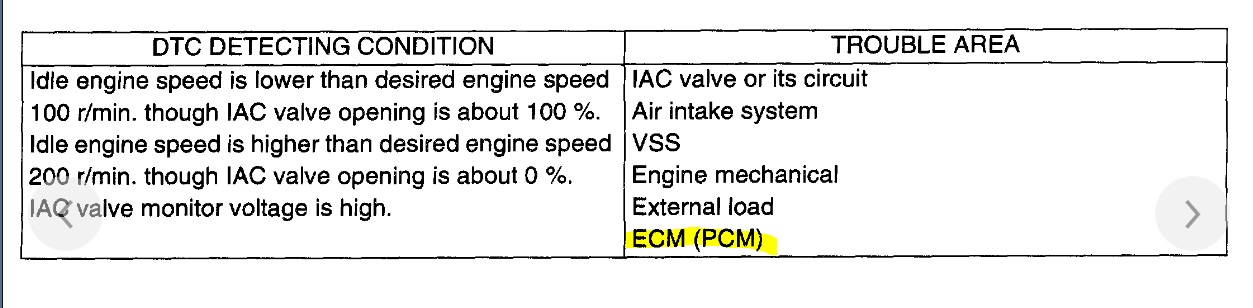

I sent along some guides for you on my last reply, but here I have the vehicle manufacturers troubleshooting flowchart for your vehicle for Direct Trouble Code[DTC] P0505. Please go through this guide and get back to us with you are able to find out.

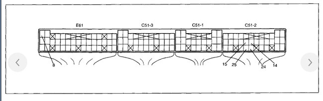

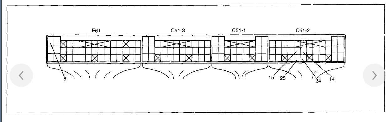

Just to add, I would go through and check all the ECM powers and grounds right at the back of the computer by back probing the pins (carefully) with a multi-meter. And do this with the ignition switch in the run position so that the circuits are loaded. Problems can be missed if the circuits are not turned on.

OTHELLOST
Thank you very much for the assistance. It appeared to have been the PCM. It had water damage. Just have to locate another. Much appreciated.
