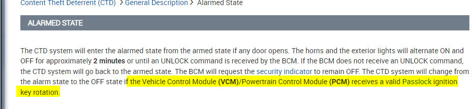

If you take a look at the information below you will see how the system works.
Let us know if you have questions. Thanks

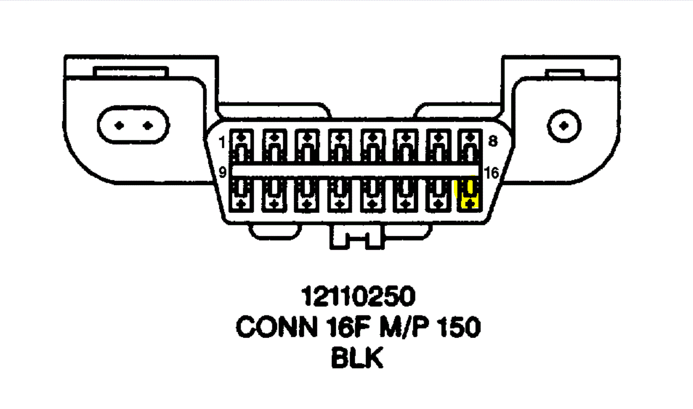

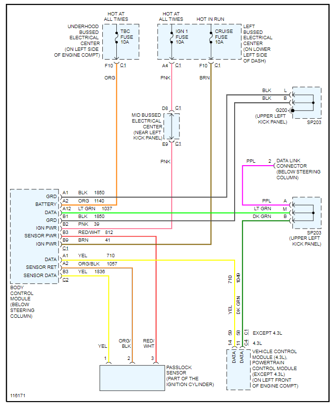

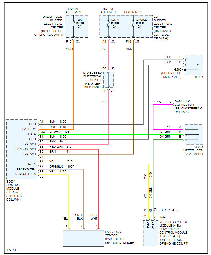

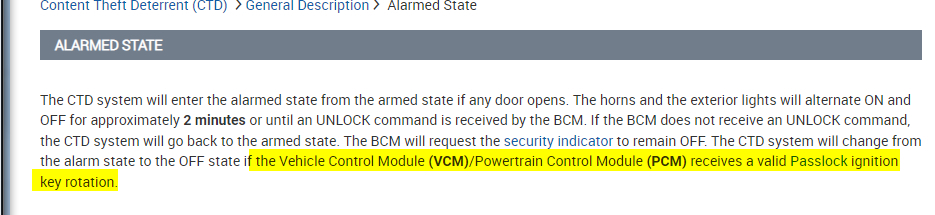

So recently I unplugged the computer in the truck listed above k1500 and left it unplugged for a few days. When plugging it back in the security became engaged and the security light is steady on not flashing. Unable to fix that I wanted to check the obd codes. The tool says no communication with vehicle. Have done some research and discovered the check engine light does not come on at all. The check gauges light comes on for a few seconds but not he check engine light. Where should I start with figuring out why the check engine light isn't functioning and does this immediately mean the PCM is bad? The truck has been running or weeks and haven't ever noticed the check engine light coming on.
Wednesday, May 5th, 2021 AT 9:41 AM (Merged)
  • 109,885 POSTS

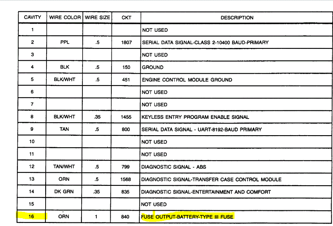

Did you have the battery disconnected when you unplugged the PCM? Also, if you leave the key in the on position for approximately 10 minutes, does the security light turn off?
Check pin 16 in the DLC to see if there is power present. See the attached pics.
Let me know what you find.

JOSHUA WAYNE
Okay, will do. First thing in the morning. Honestly can't remember if the battery was unhooked or not. Have tried several relearn procedures with the key. Light does not go off. Doesn't even blink.
JOSHUA WAYNE
The obd tool isn't self powered however and does power on so I assumed there wasn't a problem at the obd plugging for power.

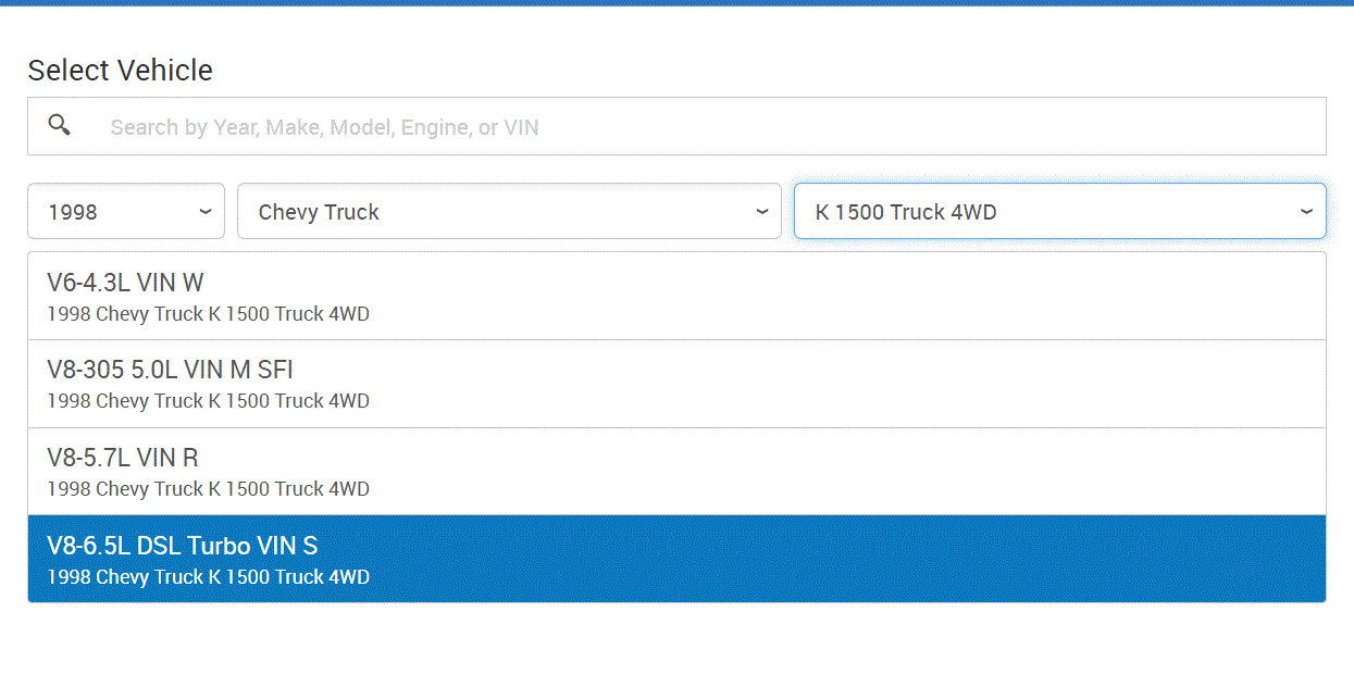

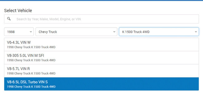

  • 109,885 POSTS
I should have asked this earlier, but can you confirm the engine size? The 4.8L doesn't exist on this vehicle. If you look at the attached picture, it shows what I am seeing. I need to confirm the correct engine to really dig into the wiring schematics. Pin 16 is a standard power supply. That's why I was able to get this far.
Also, if you disconnected the PCM without having the battery disconnected (disconnected or reconnected), it could have caused damage to the PCM.
