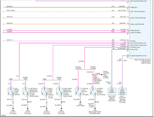

van will not start and dash lights will not come on with the key turned on. battery is fully charged. (obd2 code reader won't link up to computer on my van listed above but linked up fine on my 2002 Grand Caravan) i used a jumper on the starter relay and the starter engaged and cranked the engine over. Could the pcm be bad or could it be another issue that i'm missing. all the fuses and relays checked out okay.

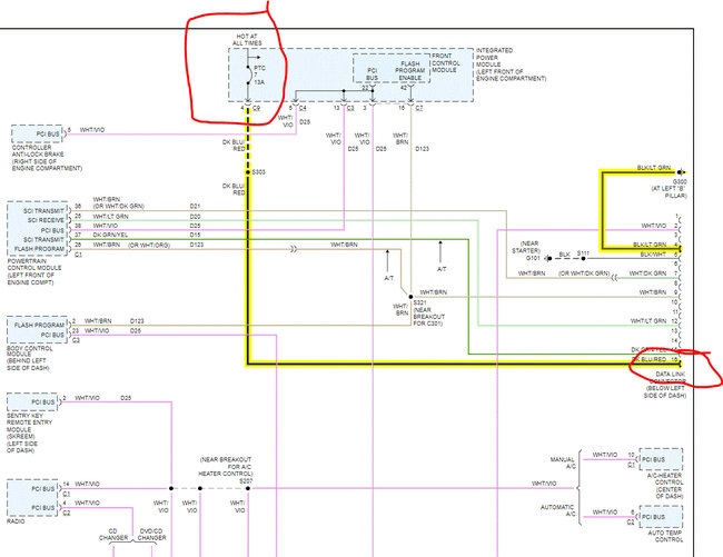

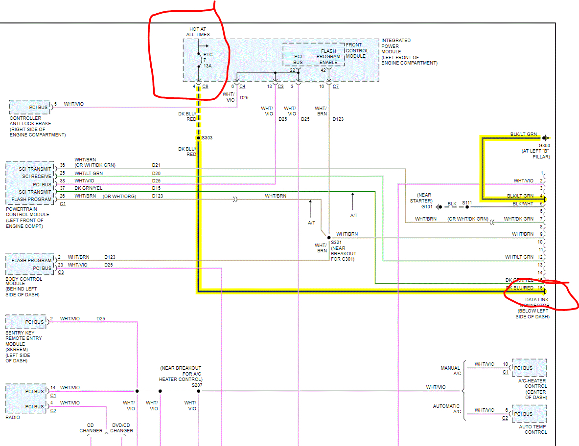

The PCM could be an issue. However, let's start easy. First, I need you to check for power at pin 16 at the DLC connector. Is there power? If not, check fuse 7 in the underhood power distribution box. (Integrated power module).
Note: When checking fuse 7, make sure there is power to it. The totally integrated power modules (TIPM) are known to have issues with the connector pins. Here is a link you may find helpful:
If we have power, then we need to confirm ground at the DLC. Pin 4 should be ground. Confirm there is continuity to ground.

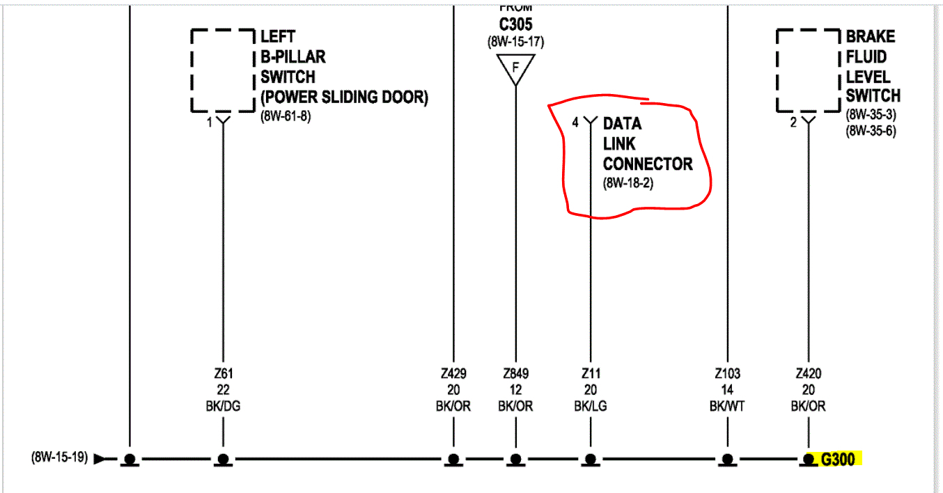

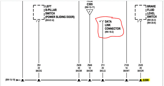

See pic 1 and 2 below. That is the wiring schematic for the DLC. Note: I had to cut the pic in half to make it readable. However, I did overlap them so you can follow from one to the next.

Pin 4 is the ground. Without that, it won't work. Check it with both the key on and off. If there is no continuity to ground, try running a new ground wire to see if that makes things work.

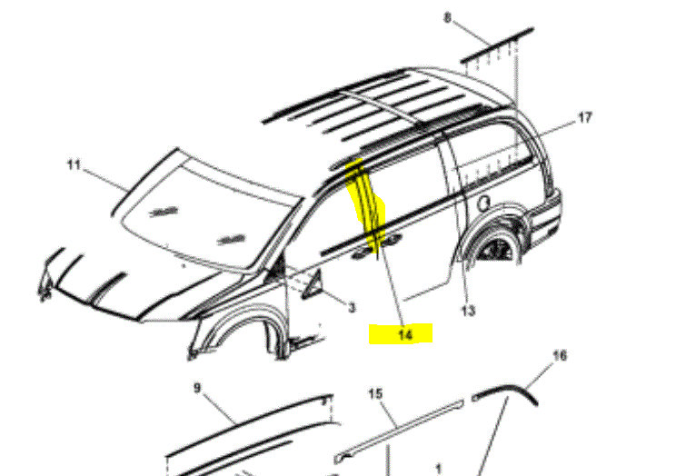

I just ran through the wiring schematics. The DLC ground is referred to as G300. It is located at the left B pillar. There are a number of components that use G300 for a ground location. Most of the things you mentioned as working ground at G300. So, if you have no continuity to ground at pin 4, then chances are the wire is broken at some point. It doesn't go through the PCM. It goes straight to ground.
If you look at pic 1 below, I simply showed the DLC ground. There are several pages of schematics with different components all grounding at this point.

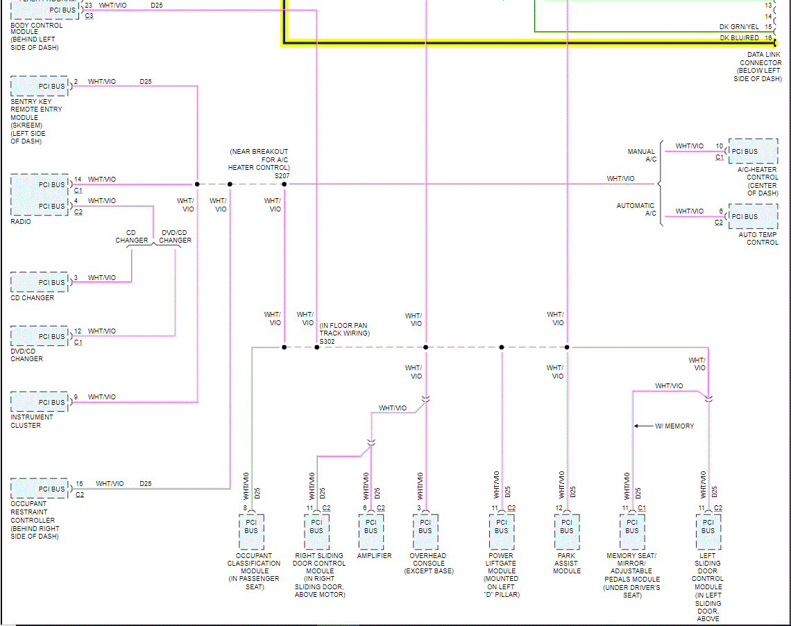

I added pic 2 to help you locate the "B" pillar. I wasn't sure if you knew what it was. Most people don't.
Let me know. Again, recheck continuity. If there is none, try running a separate ground for the DLC to see if it works.

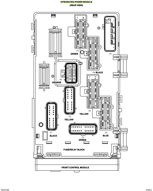

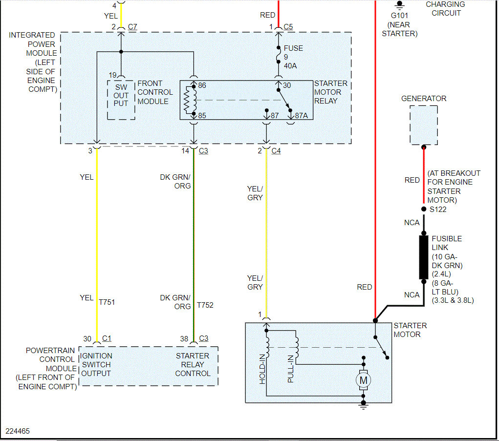

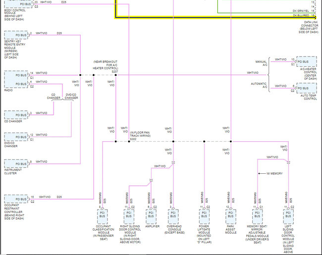

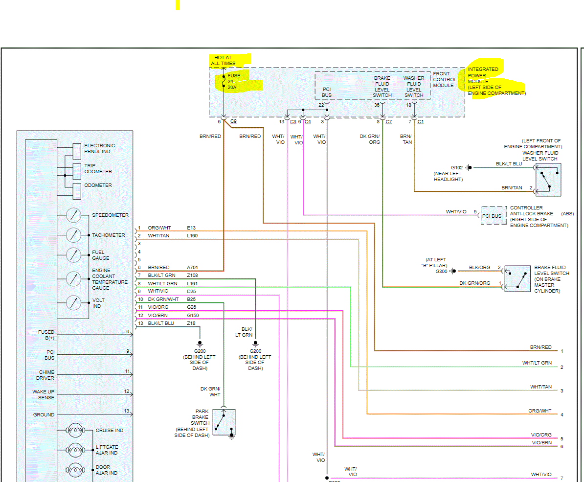

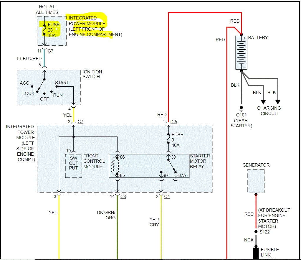

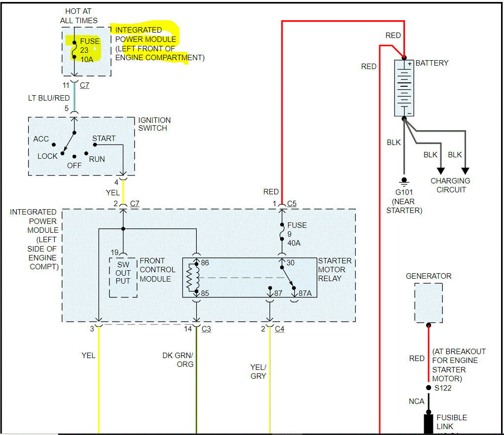

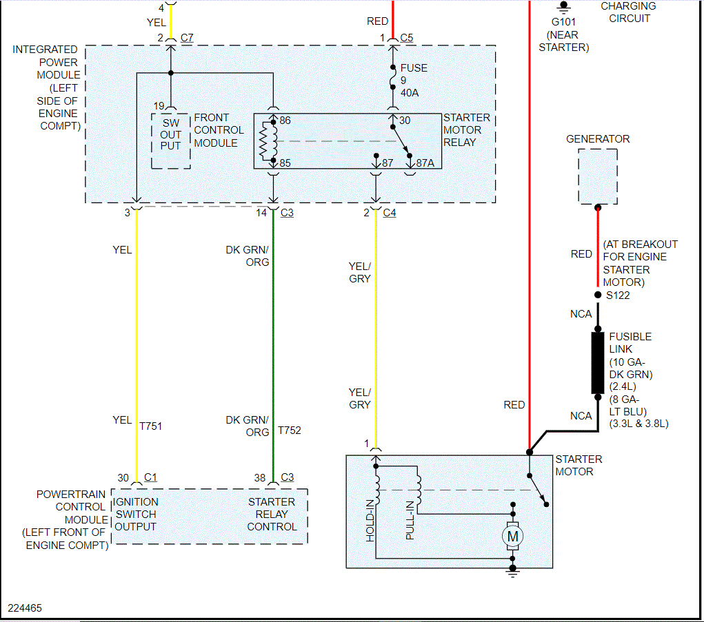

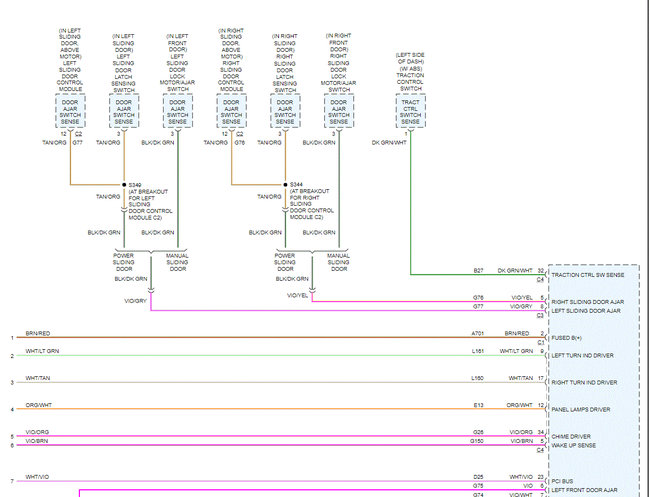

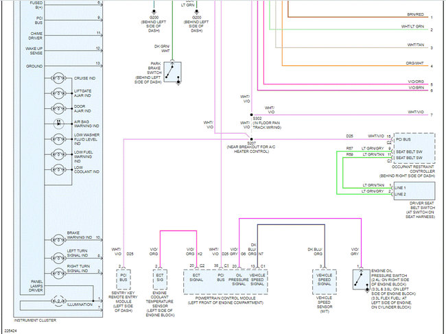

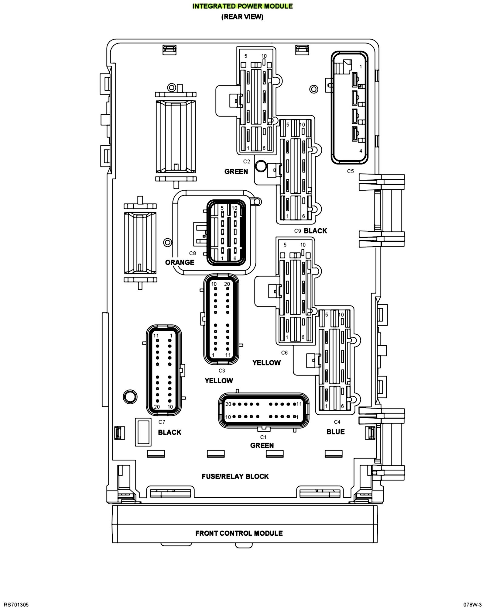

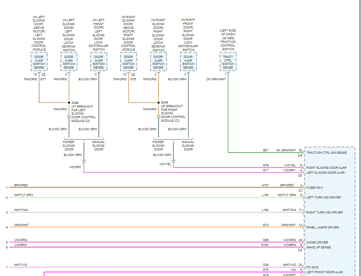

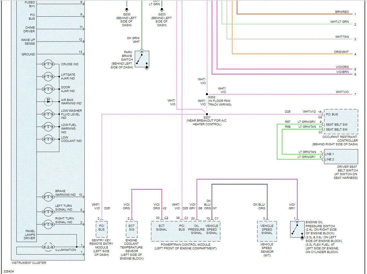

I may have an idea where this is sending us. First, the first 4 pics below are the entire wiring schematic for the instrument panel. I highlighted a fuse. Confirm it is good and getting power as well.
Pics 5 and 6 are the starting system. Note that it is fuse 24 and the one for the cluster is 23.
If the fuses are good, move the wiring around under the integrated power module (TIPM) to see if it changes anything. If it doesn't then we need to check for power at the module. I have a feeling we have problems with the pins at the connectors. It isn't uncommon for them to break or corrode.
The last pic I attached shows the back of the TIPM and identifies each connector. You will need to check C-7 and C-9.
Let me know what you find.

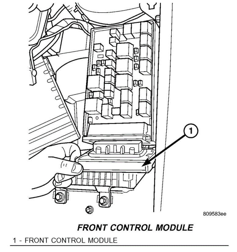

Do me a favor. In the power distribution box under the hood is the front control module. Check to see if there is a connection issue.
If you look at pic 1, it shows the part I am referring to.
