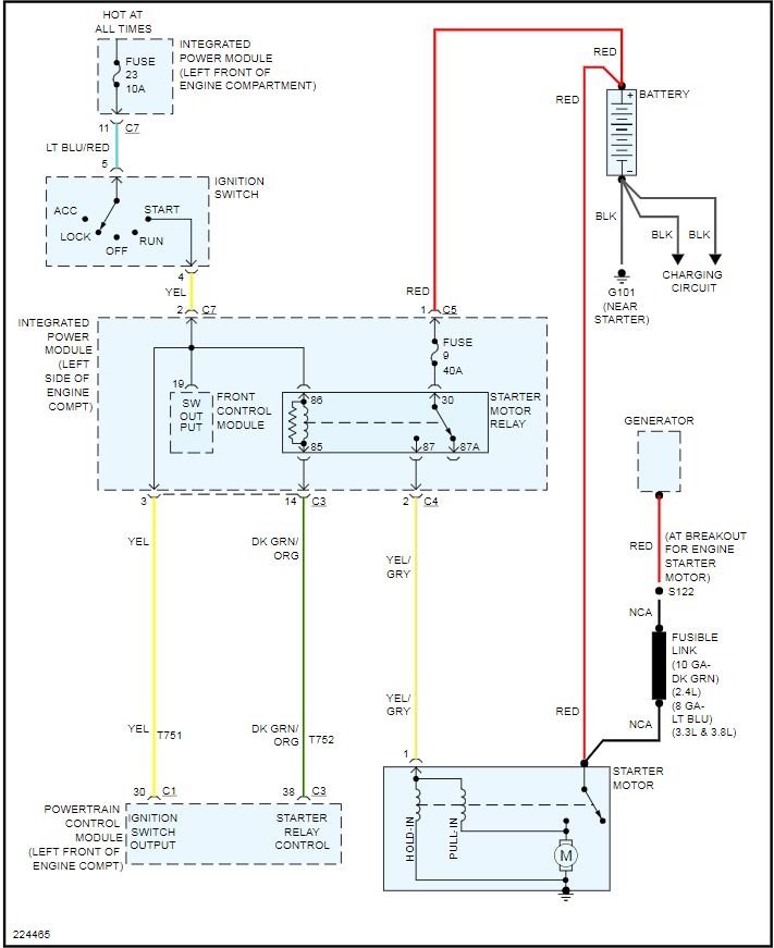

Will not start. No turn over. No clicking. Sometimes it starts. Sometimes it does not start.

Check battery terminals
remove check clean and tighten
if all OK suspect bad starter

Thanks. New battery. Clean connections. Rebuilt starter. What else?

Many many more (ignition switch ,BCM ,security system ,relay,wiring harness ,neutral safety switch ,PCM )
when it fail to start only the starter that does not engage or no light on dash
try and wiggle the key in the switch if that help suspect switch
place the shifter in neutral
if that work suspect Park switch
check starter relay in under hood relay box
Heres a guide on your starter not working.. it will help
Attached below is the wiring diagram for your starting circuit

What is BCM? What is PCM? Tried in neutral. No start. Always full power. All lights, dvd player, electric door. Thanks for your replies/help!

BCM body control module
PCM main van computer
have a helper hold it in start position for you as you check the small wire at the starter (S) terminal for power
also open hood and beside the battery locate relay box
check for starter relay Mark it and switch it with another similar relay and then try if it start replace the marked relay
