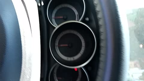

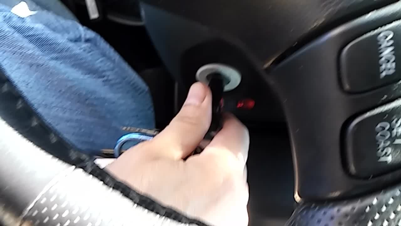

I just wanted to clarify from my description, the working remote I am referring to is a separate piece and are not integrated with the key.
I have recorded a video today trying to start the car and it had the same symptom. Please look at the video. If you need anything else, please let me know. Thank you!

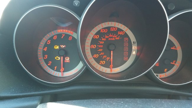

Here is a picture of the dash panel light. I noticed the Security Key light does not show up and it is always like that from the beginning. After I insert the key and turn to the ON position, the blinking Security Key Light goes away in a few second but the engine will not crank. Since I don't have the Security Key Light blinking all the time, does that mean it has nothing to do with the Anti-Thief System and Its something else instead?
Just a thought, when I re-mounted the TCM to the firewall away from the transmission body, the TCM is no longer grounded to the body anymore. The firewall is painted and there is no grounding. I am not sure if that could have caused all these problems. However, I believed (not 100% certain) the TCM grounding is provided from the wire harness. I could be wrong.

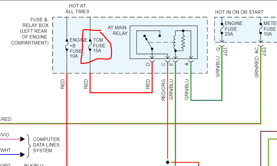

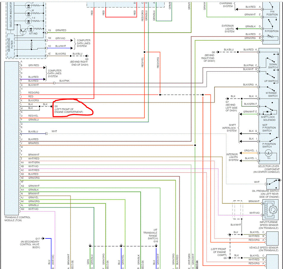

Ground is provided via a wire in the connector. See the attached picture. Check that ground. Also, I noticed that there is no gear indication on the dash. Check the ground. The TCM isn't allowing it to start. It isn't getting a signal from the range sensor (neutral safety). I don't feel this has anything to do with the security system. Also, check the fuses I have in pic 2.
Let me know what you find.

Fixed!
Joe, thank you very much for your help. You are correct, the Trans-axle Range Switch (Neutral Safety) was the problem. I replaced the switch and the car fired up! Thank you again and have a great day!
