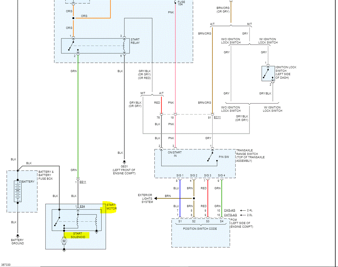

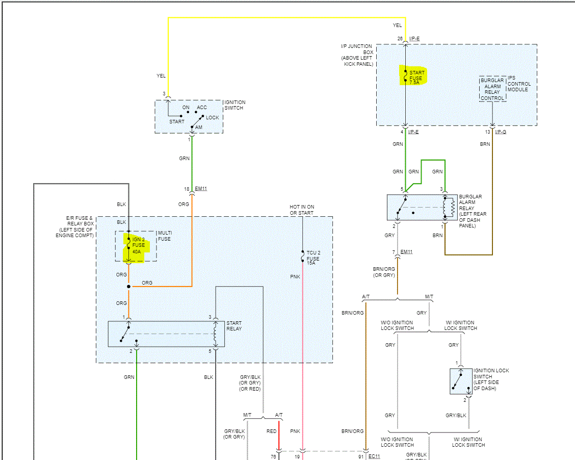

I attached the wiring schematic below for the starting system (standard key start). I highlighted the two fuses in the pic. If you follow the wires from those fuses, both go to the starter relay. However, there are a couple of variables for it to work (we will look at those as possible issues if needed).
Now, first, confirm the fuses are good. If one or the other is bad, replace them with the same amperage fuse and see if the car starts. If they both appear good, it is necessary for you to check if there is power to and from them. All you will need is a cheap test light that you can get at any parts store. Here is a link that explains what and how to check.

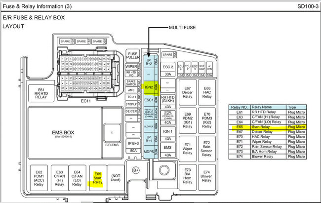

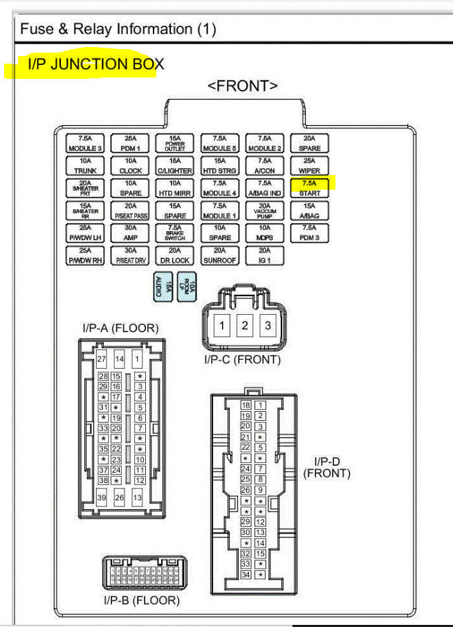

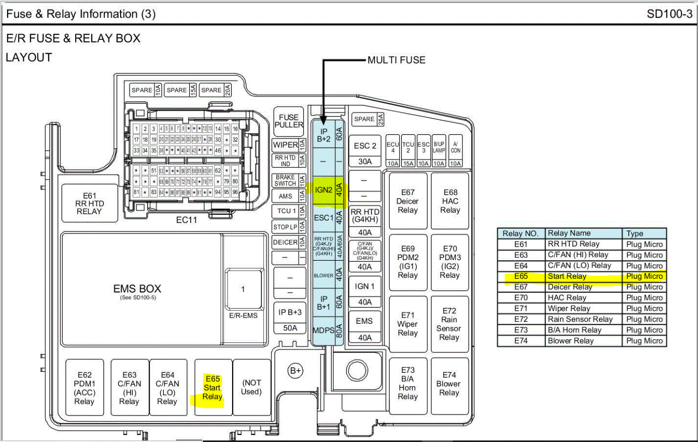

See pics below. Pics 3 and 4 show fuse locations in the different boxes. I also highlighted the starter relay in pic 4 (under-hood fuse box). Remove that relay and switch it with a different one in the fuse box that has the same part number to see if it makes a difference.
