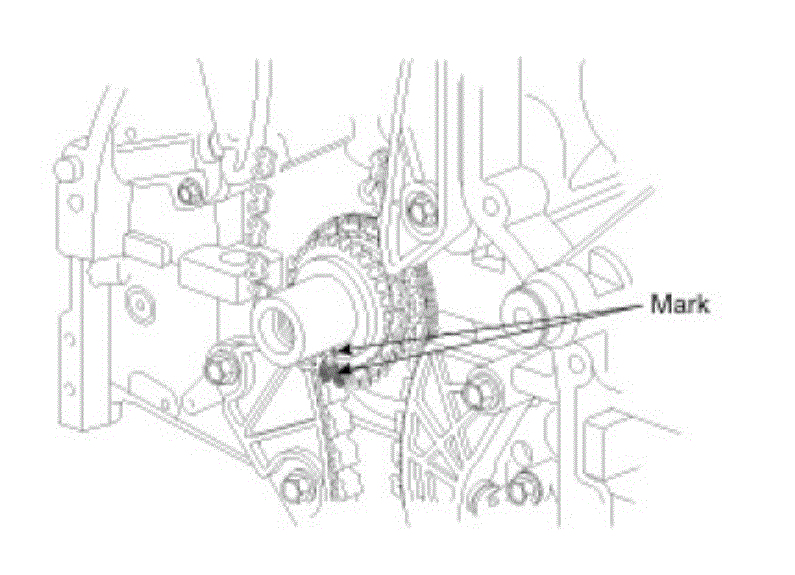

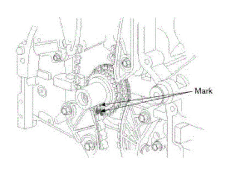

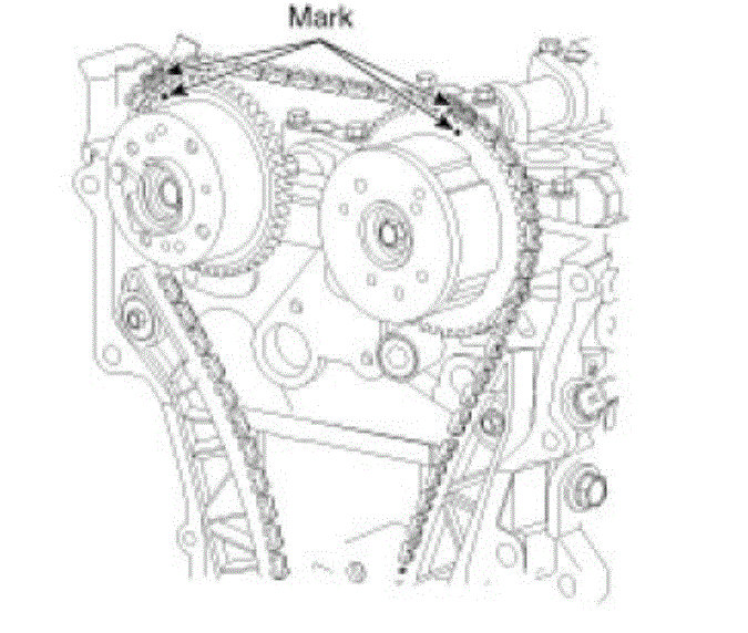

Good afternoon,
The timing chain can fail at anytime. There is no warning.
https://www.2carpros.com/articles/how-a-timing-belt-works
How many miles on the car? It should be changed at 150,000 miles as preventive maintenance so this does not happen.
His test was little out there but accurate. If there is no compression, it is an interference engine which means you have valve damage and possible piston damage. We would also recommend a replacement engine as well.
https://www.2carpros.com/articles/symptoms-of-low-compression
The dealer will charge you a lot more than an independent shop. I would inquire about a used engine as that will cut the cost in half.

It would indicate the chain moved or failed but could still cause the same damage.
I would at least get a bid on a used motor from him and if you take it for a second opinion, compare the 2 prices.
