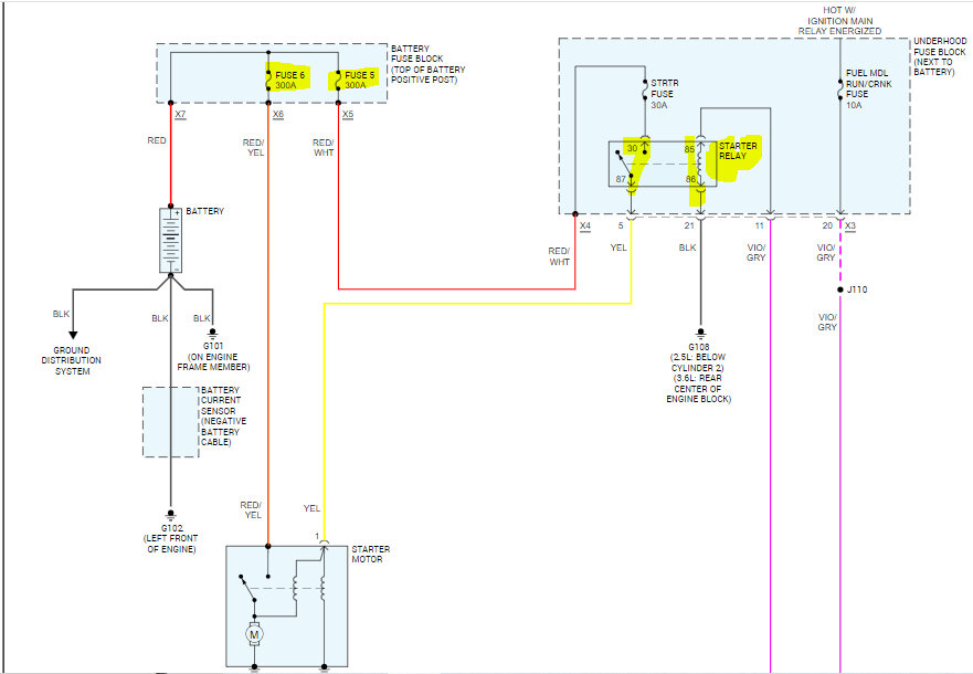

So, I've done anti-theft reset battery has 13 4 Volts, it is getting fuel the head is completely full of fuel. Still nothing when tried crank acts like a drained battery. Also, when key on I don't hear injectors click or anything telling system to fire.
Feb 21, 2024 at 5:49 AM
  • 110,248 POSTS
I didn't realize it was a no-crank/no-start. I thought it was just a no-start. Have you checked the starter relay or tried starting it in neutral?
I attached the wiring schematic for the starter circuit below. Make sure the start relay is getting power to both pins 30 and 85. Pin 30 should have power at all times. Pin 85 should only have power with the key in the start position.

Let's try to get the engine cranking first. Let me know if you have any success with that. Once we determine the cause of the no crank, that may lead us to other problems.
