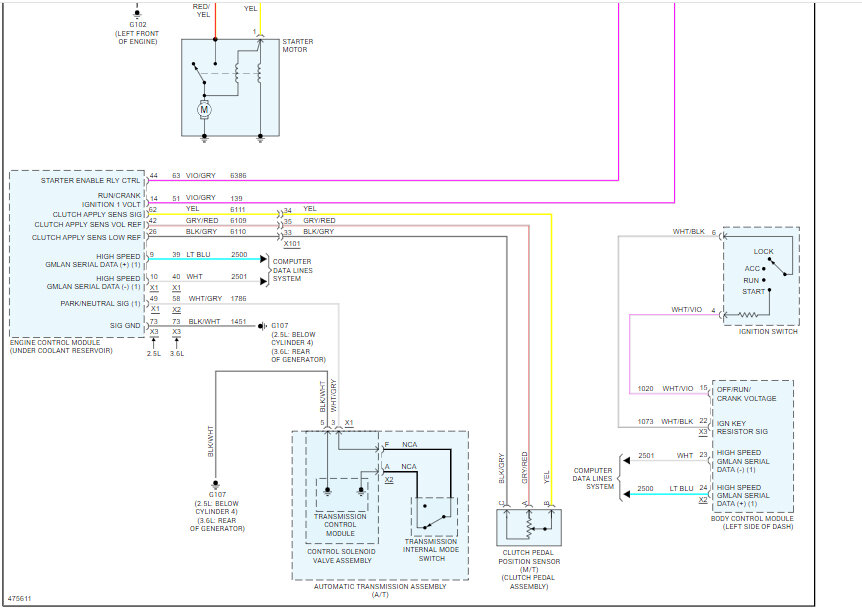

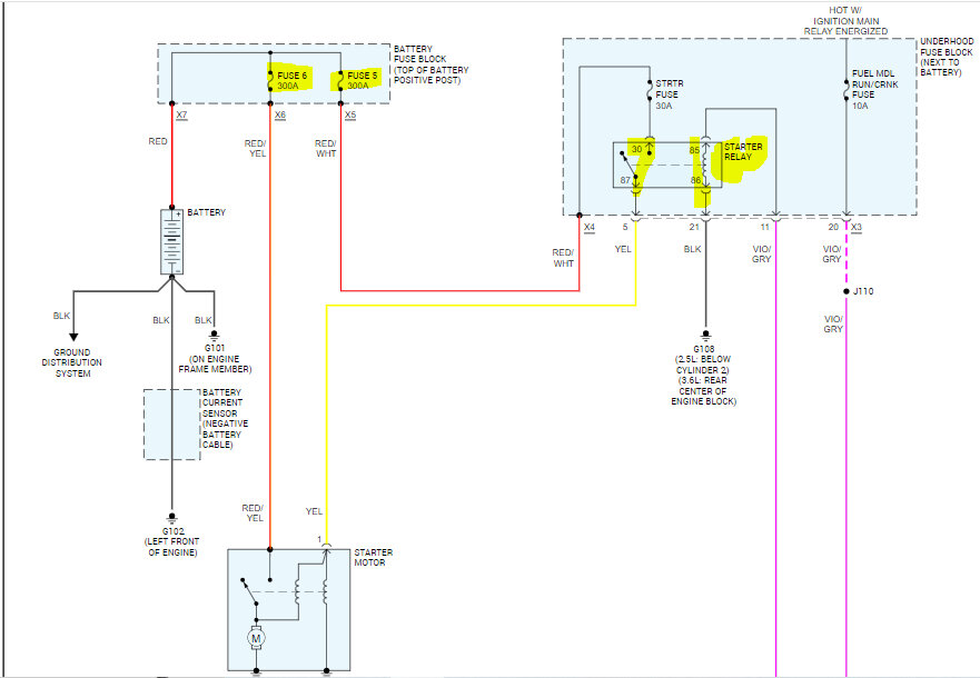

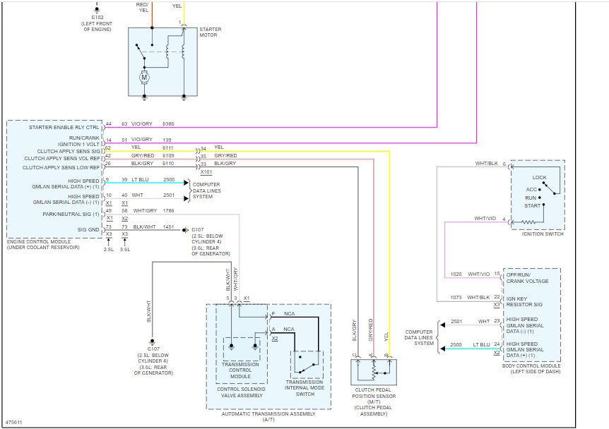

I didn't realize it was a no-crank/no-start. I thought it was just a no-start. Have you checked the starter relay or tried starting it in neutral?
I attached the wiring schematic for the starter circuit below. Make sure the start relay is getting power to both pins 30 and 85. Pin 30 should have power at all times. Pin 85 should only have power with the key in the start position.
