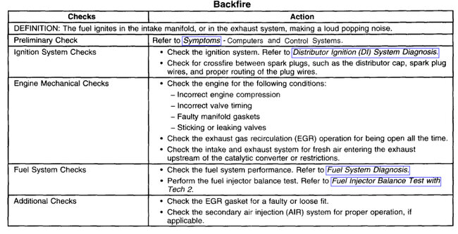

A backfire can be caused by a few things. For example, a lean or rich fuel mixture can cause it. Also, ignition timing. Something is off.
Take a look at the list I attached below. Of the things listed, what have you already checked?
Also, is it possible for you to record it cranking and upload it for me to hear?

Hello. Since the last text I have done the following.
I wanted to check the timing and rotor position on the distributor first. So, after looking at the rotor itself, it had two burn marks down both sides of the metal pointer. I went and got both a new cap and rotor.
Prior to checking it I drained the power by first disconnecting the cables from the battery and then using one side of some jumper cables I connected the two cables together and wrapped a shop towel around each one. I left it like this till I was finished with replacing rotor and cap.
After this I reconnected the battery and did two cycles of turning the key to on position for 5 seconds then Off for 3 seconds. At the start of the third cycle, I just turned it on for 5 seconds and then cranked it. Started up. Idled rough at first but has settled down to 850-900 at the present time. I drove it 17 miles and after 3 hours it started right up. A few hours later I had to press the pedal down again for it to start. This morning it started but not like it should. I changed plugs and wires later last year when I noticed one had a burn mark on it.
Have not had the injection balance test done yet. I cleaned the ERG valve a few months ago. I’ll look at it again. On those is it advisable to replace it with a new one or does cleaning one suffice too?
