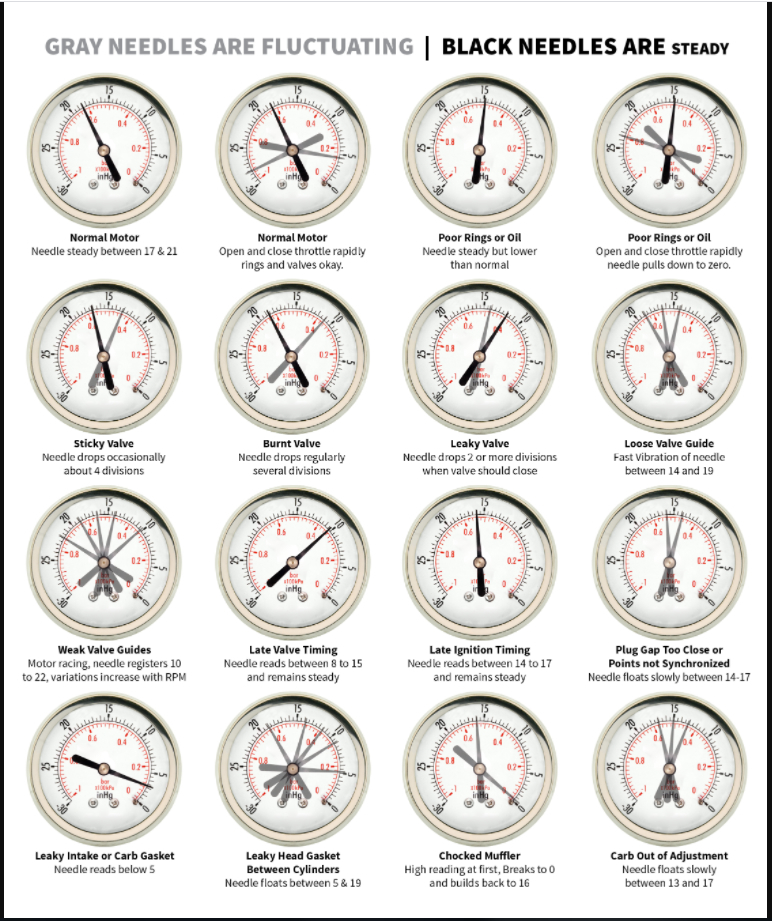

There are a number of things that will cause this on these engines, so we need to start with checking the operation of the fuel pump. I understand you changed it, but we need to check the pressure.
Once we know what the pressure is when you are trying to start the engine, we will have a better idea.
However, if the pressure is correct then we need to check the compression to find out if this is the issue.
The last thing to check is the vacuum of the engine when you get it started.
So, we need to use the chart below when the engine runs and then stalls to find out if the intake valves are causing a vacuum issue.
Please run through all this info and we can go from there.
Thanks
