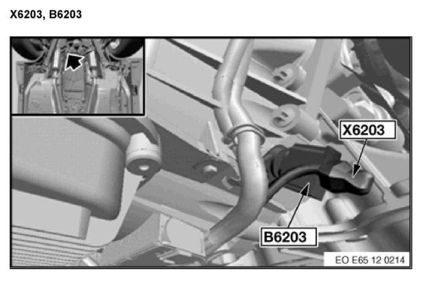

Ah! getting warmer, It sounds like a crankshaft angle sensor is your problem which when they go bad they will not give a trouble codes for it and the car will not start. Here is a a guide to help you see what you are in for when doing the job:
You will need to jack the car up.
Here is the location for your car (below).
Mar 12, 2018 at 4:24 AM
