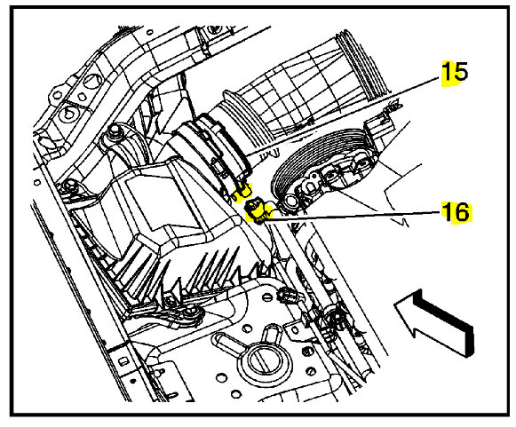

Been having trouble getting car to start need repair guide to help me check if I'm getting spark in spark plugs, or maybe how to check my battery using multimeter and checking if maybe it's my crankshaft sensor trouble code received is p0102.

I will provide the info requested, but I feel the problem is related to the mass airflow sensor (MAF). That is what the code is indicating.
Do me a favor. The air induction tube between the air filter box and the throttle body has the MAF sensor in it. Disconnect the sensor and see if it starts. See pic below
Also, here is a link to test the alternator using a multimeter:
If the engine starts (hard start), you are getting spark to the plugs. However, here is a link that explains how to check for spark:
https://www.2carpros.com/articles/how-to-check-for-ignition-spark
Let me know what happens with the MAF disconnected.

See pic below.
