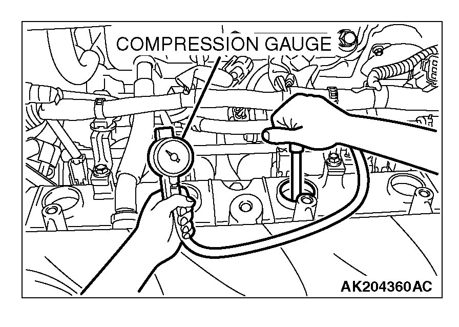

2. Remove all of the ignition coils and spark plugs.
pic 1

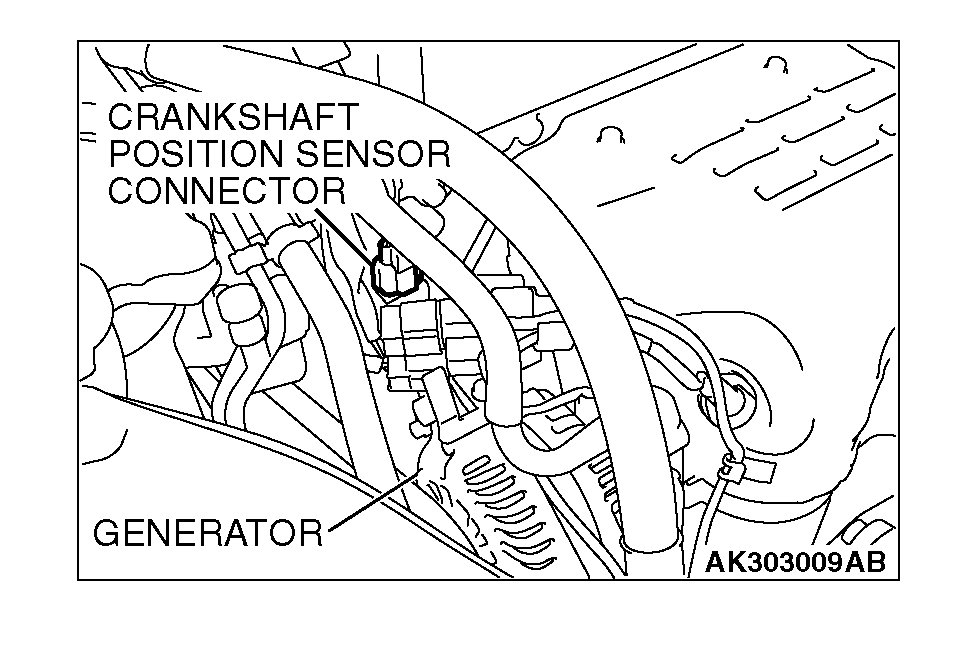

3. Disconnect the crankshaft position sensor connector.
NOTE: Doing this will prevent the engine control module from carrying out ignition and fuel injection.
WARNING: Keep your distance from the spark plug hole when cranking. Oil, fuel, etc., may spray out from the spark plug hole and may cause serious injury.
4. Cover the spark plug hole with a shop towel etc., during cranking. After the engine has been cranked, check for foreign material adhering to the shop towel.
pic 2
5. Set a compression gauge to one of the spark plug holes.
6. Crank the engine with the throttle valve fully open and measure the compression pressure.
Standard value (at engine speed of 200 r/min): 1,560 kPa (226 psi)
Minimum limit (at engine speed of 200 r/min): 1,130 kPa (164 psi)
7. Measure the compression pressure for all the cylinders, and check that the pressure differences of the cylinders are below the limit.
Limit: 98 kPa (14 psi)
8. If there is a cylinder with compression or a compression difference that is outside the limit, pour a small amount of engine oil through the spark plug hole, and repeat the operations in steps 6 to 8.
(1) If the compression increases after oil is added, the cause of the malfunction is a worn or damaged piston ring and/or cylinder inner surface.
(2) If the compression does not rise after oil is added, the cause is a burnt or defective valve seat, or pressure is leaking from the gasket.

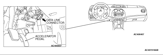

9. Connect the crankshaft position sensor connector.
10. Install the spark plugs and ignition coils.
pic 3

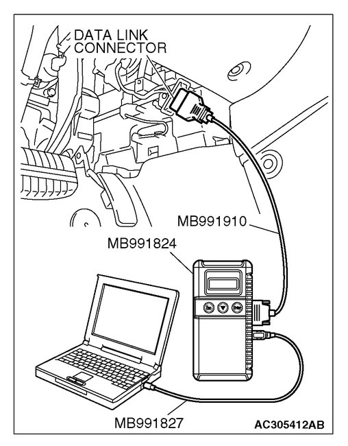

11. Use the scan tool MB991958 to erase the diagnostic trouble codes.
NOTE: This will erase the diagnostic trouble code resulting from the crankshaft position sensor connector being disconnected.

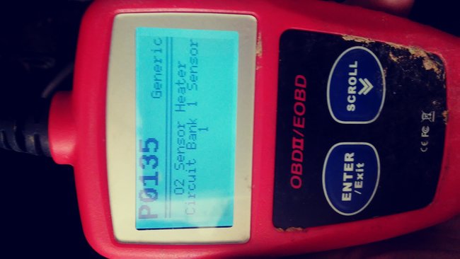

DUB COLLUMS
Fuel pump pressure seems to be fine and in the pic is code it threw.
Aug 3, 2020 at 7:47 AM (Merged)
  • 110,241 POSTS
Welcome back.
That code tells me the sensor is not heating. I will tell you that there is a fuse that can blow as well as the sensor itself can go bad. However, that will not prevent the engine from running. Worst case, bad gas mileage.
With that in mind, since it will not start now, check to make sure the engine is getting spark and fuel. Even though there is fuel pressure, the injectors may not be firing due to an electrical issue or even a bad cam sensor.
Here is a link which shows how to check for spark:
Here is a link which shows how to check that the injectors are working:
https://www.2carpros.com/articles/how-to-test-a-fuel-injector
Do these two things and let me know what you find. Also, engine timing may be an issue here if the belt jumped. Let me know about the spark and fuel first and if it checks good, we will need to do a compression test.
This is an interference engine, so a broken or jumped timing belt may be an issue.
